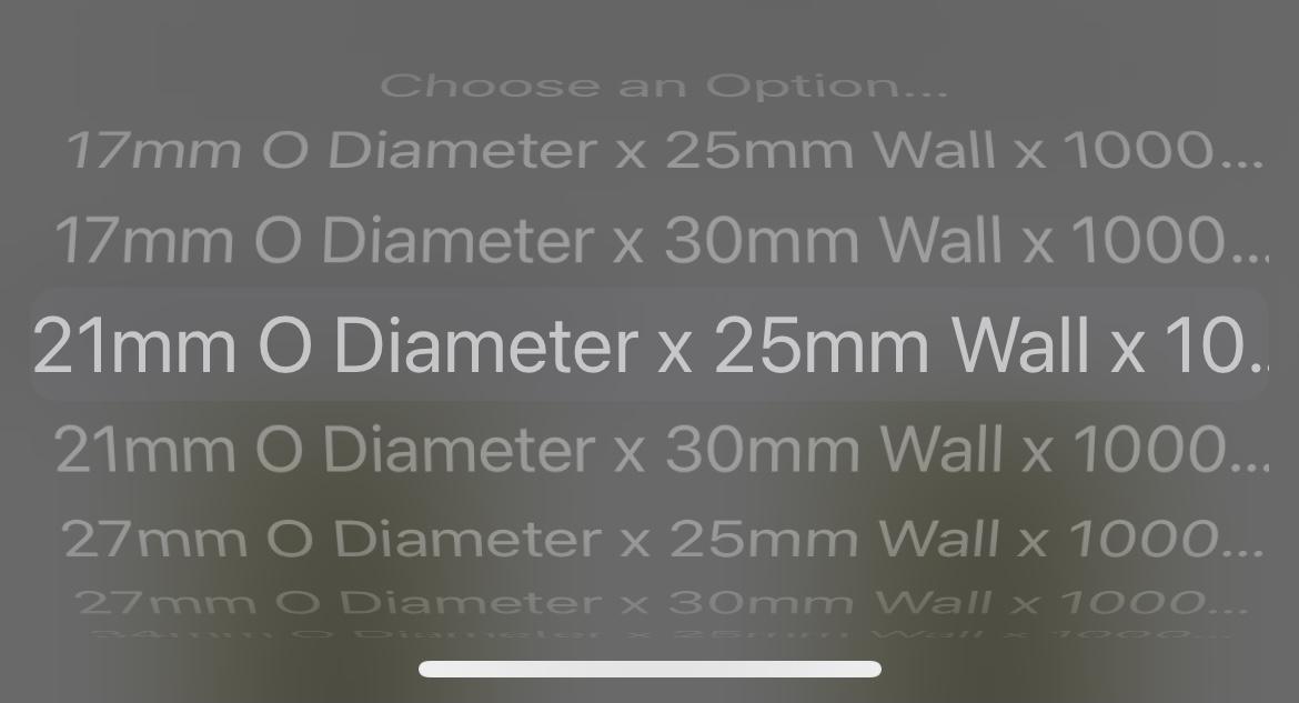

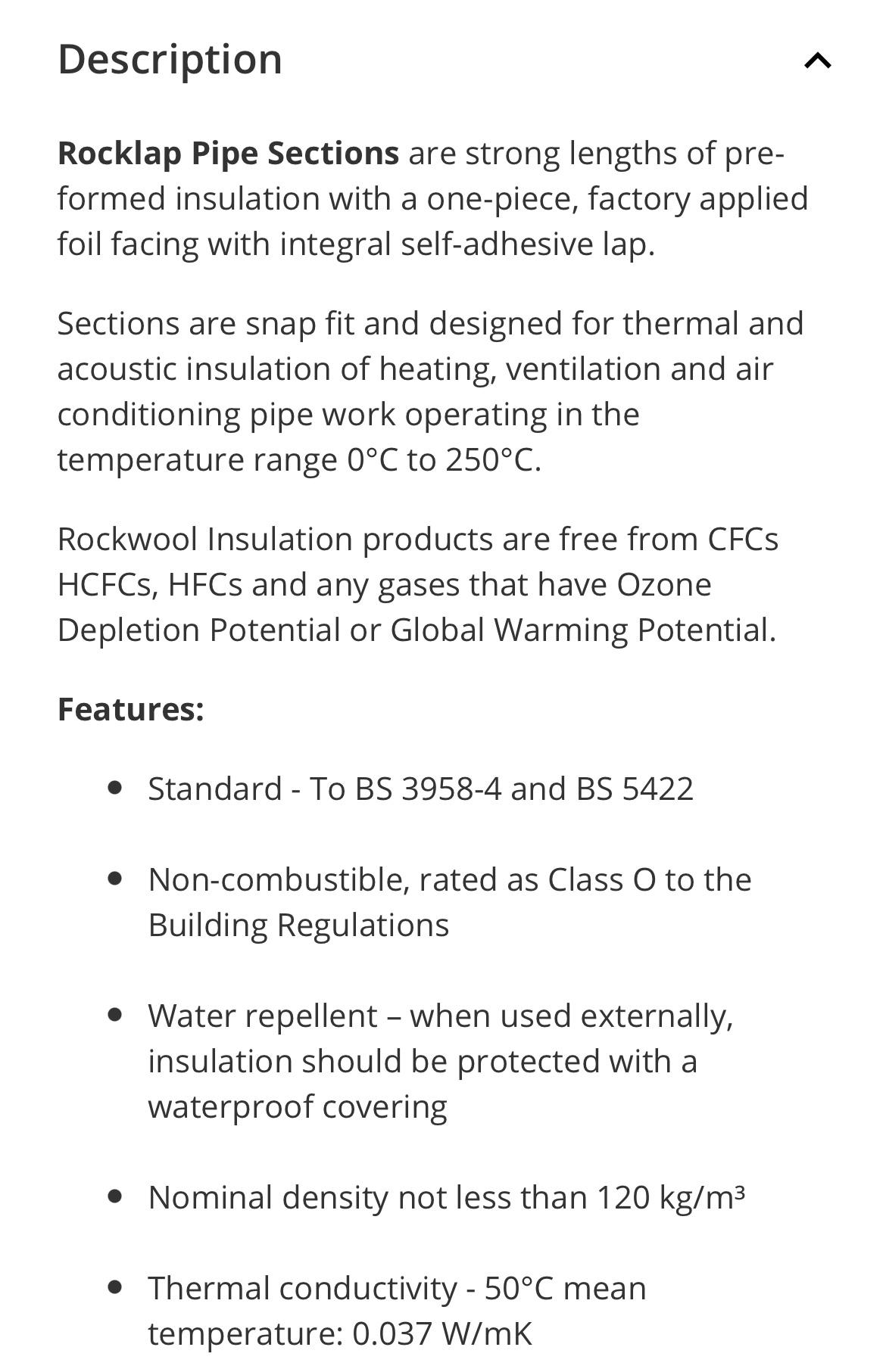

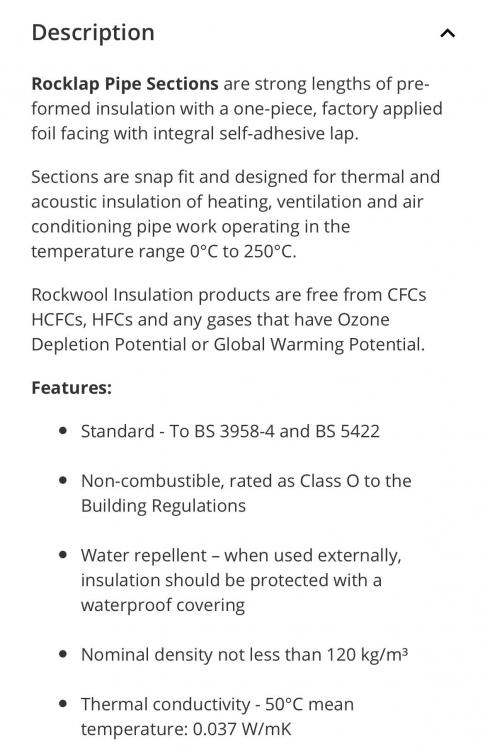

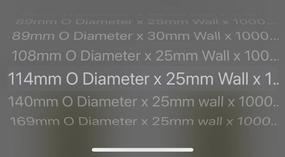

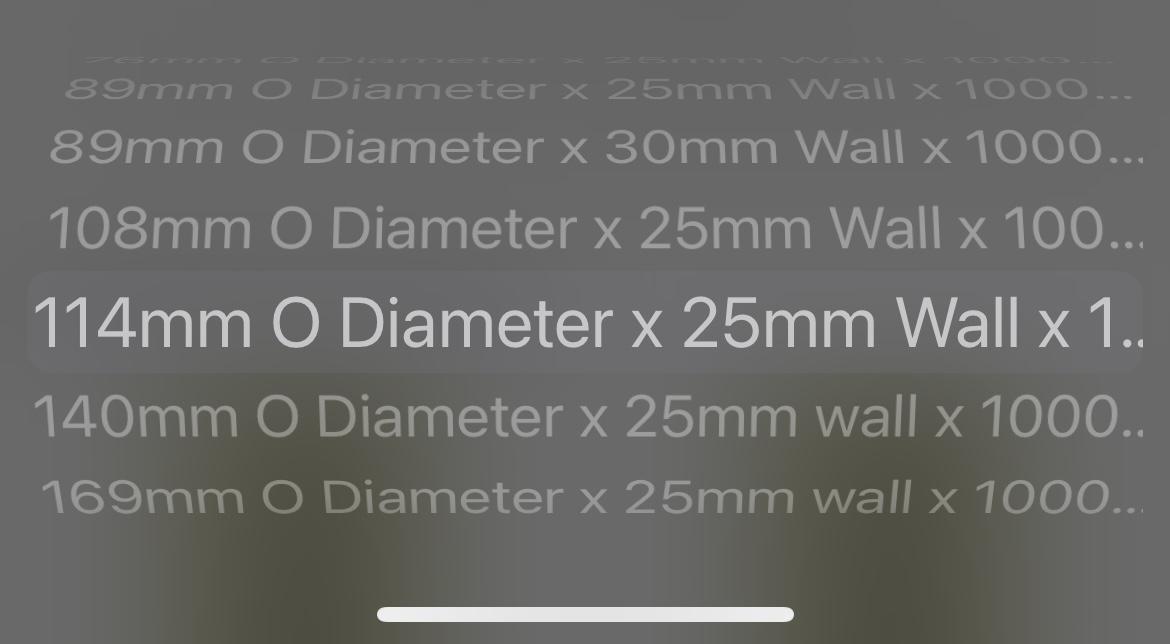

ashthekid Posted May 24, 2021 Posted May 24, 2021 I have a couple of box gutters that are draining internally through a cavity wall space. I know that isn’t ideal but had to be done because of various party wall conditions with the neighbour. I want to insulate this pipework to protect against acoustic potential and also to stop any potential condensation that maybe produced because of it being located in a cavity space. Has anyone used Rocklap before or an alternative product or maybe a different idea to insulate it quickly and easily? It’s soil pipe size. I attach some details on the Rocklap.

ashthekid Posted May 25, 2021 Author Posted May 25, 2021 My cavity space is unusually massive because of structural specifications so am using a 110mm pipe. So nobody has used the Rocklap that I attached earlier? I’ve never heard of it before but it seems good on paper.

saveasteading Posted May 25, 2021 Posted May 25, 2021 I don't like, and have never specified syphonic. It is clever and works in principle, but risky, and I have always found a safer solution. Weighing up an irritating noise against risk of leaks and flooding is easy. Have observed the use of syphonic in a commercial building and seen it go wrong due to occupier lack of maintenance. It works on the principle that the downpipes are deliberately downsized, not running freely, become completely full of water and then suction kicks in. There is no plan B if there is a problem, unless you can build in a substantial overflow somewhere safe. my checklist: 1. Get the gutter and pipes outside the building wherever possible or asap in the run. 2. Have a secondary outlet of pipe or weir, and a substantial gutter. 3. Ensure the flow is smooth (no sharp bends), fit an effective leaf guard, and a means of rodding. 3. Sound insulation inside, as above, then box round for some solid barrier too, and stuff the box with fg. 4. think of any sounds as connection with nature, and evidence that the pipe is running freely. 5. check and clean gutter frequently. All that, or find a way of having conventional external drainage.

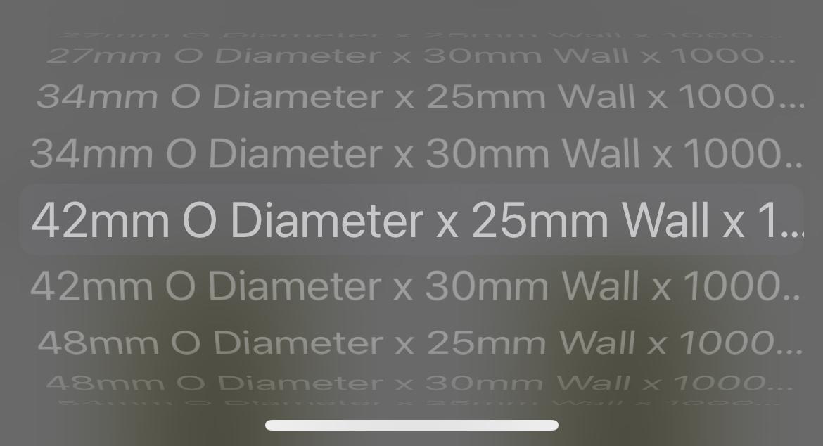

ashthekid Posted May 25, 2021 Author Posted May 25, 2021 What product would you recommend exactly for insulation inside around the downpipes? Mine are all already installed and ready to be insulated with something. I just want to make sure I get the right product and don't waste money on something else that is awful and inefficient at soundproofing and thermally protecting from any moisture/condensation on the internal pipework(which is soil pipe size) before the next wall layers go on. Apart from the Rocklap I suggested in the beginning, is there anything else similar and possibly cheaper?
saveasteading Posted May 25, 2021 Posted May 25, 2021 Rocklap if you can fit it, and then make a box and stuff it with fibreglass, or line with cuts of wall batt. Plasterboard over the box will help too. do you have an alternative outlet if the rain doesn't all get down that pipe
ashthekid Posted May 25, 2021 Author Posted May 25, 2021 (edited) No alternative outlet sadly, this was the only option. It's quite a wide cavity space that the pipe is in and it's just by the living room kitchen area so I just want any noise from rainwater to be at a minimum. I have a large roll of TXL foil insulation that the builder said I could use to wrap it with but I'm not sure it will do the job very successfully. I'm trying to get hold of RockLap quickly though, that's likely to be my next problem. And what thickness of RockLap? Edited May 25, 2021 by ashthekid
saveasteading Posted May 25, 2021 Posted May 25, 2021 As thick as will fit, so any thickness then stuff the rest of a box-out.
