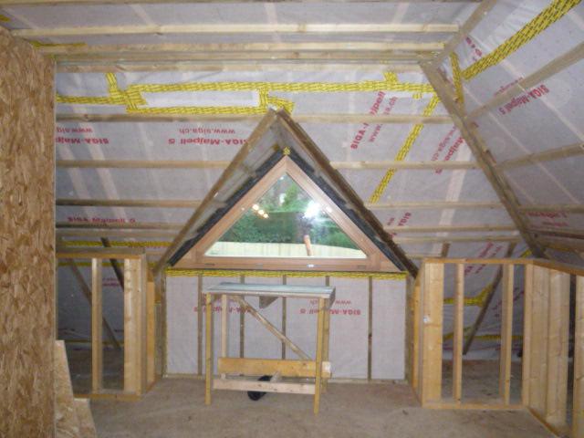

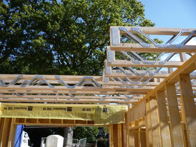

MBC probably used the same membranes as for my build, which was a couple of months ahead of @bitpipe.
They used  some AMPATEC DB90  but  mostly SIGA-Majpell -5 to wrap the joist ends and between floors and, for mine, they used SIGA-Majpell -5 for the walls and roof.  ( the airtight board was introduced after my build) - see photos.
Yes - it was the yellow Ampetex. I think my build was their first with the green airtight OSB board, we had the company rep come out to look and take pics.

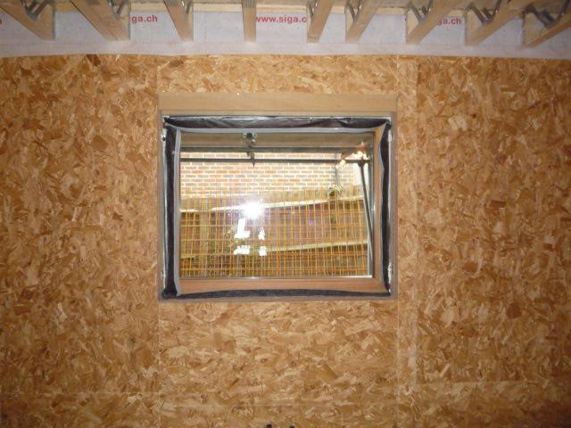

thanks. I'm still thinking about using the airtight board instead of fabric to be honest. the architect has detailed for the airtight board as I said I was going to use it but I can easily swap it out for normal OSB if I choose to go with the membrane instead. will need to run the costs in a spreadsheet for that one but will definitely have the membrane between floors.
IIRC, MBC said that the board was much quicker to install as I believe the other system still needs an OSB layer to form the inner wall.

makes sense as I wanted OSB anyway so combining the two seemed to make sense. only small concern is the osb would be good for screwing things in to the wall but I'd be worried about penetrating the airtight board whereas OSB over a membrane would give a little extra potential protection from making a hole in the airtight layer.
You can penetrate it (otherwise how would they fix it to the structural ribs) and it self seals but if you subsequently withdraw the fixing then you should seal the hole with airtightness tape. I doubt one or two holes would make a difference but lots will.
MBC put a 50mm service batten over the airtight board, aligned with the structural ribs, and for any load bearing elements like TVs or sinks etc, I just put in additional noggins or ply where required within the service cavity.
The electrician also took care to fix back boxes to the service battens (or on noggins spanning them). Where penetrations were required (e.g. outside light) he put a duct through, angled downward, and sealed with tape to the face of the board. When the required cable is pulled through the duct is sealed with silicone and another bit of tape on the inside.

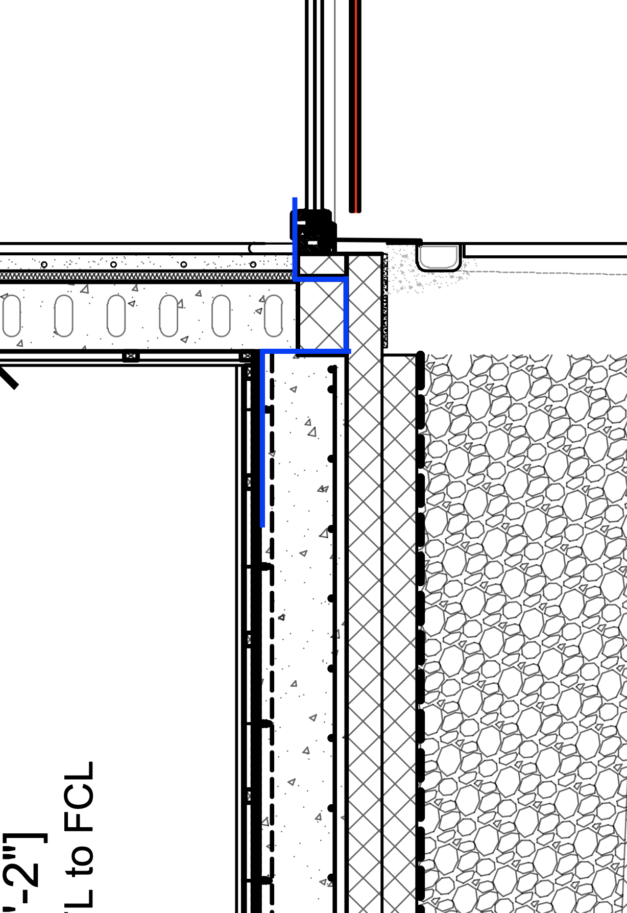

just to resurrect this thread briefly as our coursing blockwork is starting tomorrow.  The groundworker is now proposing that we run the membrane as follows:
678924826_Screenshot2021-09-14at11_24_55.thumb.png.2ef8d3a0afa85a801a6f854f1e2c9946.png
so with the VCL membrane going outside the block and then in on the underside of the coursing brick and then up to join the timber frame walls internally (previously I had the membrane on the inside of the block running between the hollow core/block and beam and the block).
anyone with a better knowledge of physics able to tell me if this new solution is an issue? I can't think of it being one but thought I'd check on here first
