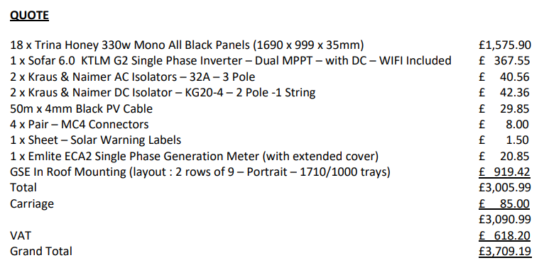

Phaedrus Posted May 15, 2021 Share Posted May 15, 2021 I can get up to 18 panels on the south facing roof of my self-build and I'm looking to finalise my solar pv system specification and pricing. Below is the first quote I've received for supply of a 6kW system in response to my outline specification (i.e. up to 18 panels, all black, in-roof mounted): Would appreciate advice on the suitability of the specification and the items included. Anything in here that I should definitely not use? Does the pricing look reasonable? Where else should I be looking to buy the solar pv system from? TIA Link to comment Share on other sites More sharing options...

PeterW Posted May 15, 2021 Share Posted May 15, 2021 Very keen pricing on that - those all black Trina are not usually less than 30p/W Is that all available ex Stock too ..?? A lot of panels are back order to China currently. 1 Link to comment Share on other sites More sharing options...

SteamyTea Posted May 15, 2021 Share Posted May 15, 2021 (edited) The Inverter seems cheap. Nothing wrong with the model chosen. I cannot find one that cheap on AliExpress. Is a 1 at the beginning of the price missing? Edited May 15, 2021 by SteamyTea Link to comment Share on other sites More sharing options...
IanR Posted May 15, 2021 Share Posted May 15, 2021 Pricing does look very good, would you mind sharing the supplier either here or via PM? It's around £350 - £400 cheaper than I've managed to get quoted for similar. Link to comment Share on other sites More sharing options...

Conor Posted May 15, 2021 Share Posted May 15, 2021 On 15/05/2021 at 07:56, Phaedrus said: I can get up to 18 panels on the south facing roof of my self-build and I'm looking to finalise my solar pv system specification and pricing. Below is the first quote I've received for supply of a 6kW system in response to my outline specification (i.e. up to 18 panels, all black, in-roof mounted): Would appreciate advice on the suitability of the specification and the items included. Anything in here that I should definitely not use? Does the pricing look reasonable? Where else should I be looking to buy the solar pv system from? TIA Expand £500 cheaper than what I paid for a very similar setup. Difference with mine was I specced solar edge optimisers and inverter, which adds a few hundred. So I'd say you've a reasonable deal. Just make sure the inverter can be limited to export 3.78kW in case your DNO doesn't authorise anything more. You can still of course make use of peak production by heating water, washing machines etc. 1 Link to comment Share on other sites More sharing options...
Phaedrus Posted May 15, 2021 Author Share Posted May 15, 2021 On 15/05/2021 at 08:14, PeterW said: Very keen pricing on that - those all black Trina are not usually less than 30p/W Expand On 15/05/2021 at 08:26, SteamyTea said: The Inverter seems cheap. Nothing wrong with the model chosen. I cannot find one that cheap on AliExpress. Is a 1 at the beginning of the price missing? Expand On 15/05/2021 at 08:31, IanR said: Pricing does look very good, would you mind sharing the supplier either here or via PM? Expand I'm beginning to get a bit worried that the quote may be too good to be true! Just tried Midsummer Wholesale's pv builder with Longi 360W panels & Growatt 1500 inverter & price is £3507 exc VAT. Perlight, Longi, Q Cells & Trina panels all look to be similar prices. Panasonic & LG are twice the price. Any views on which are best technically and/or best value? Also, should I be bothered whether the panels are mono or multi/poly crystaline? Link to comment Share on other sites More sharing options...

SteamyTea Posted May 15, 2021 Share Posted May 15, 2021 On 15/05/2021 at 10:10, Phaedrus said: Also, should I be bothered whether the panels are mono or multi/poly crystaline? Expand No. Same with 'thin film'. There is, in practice, not enough performance difference. Depending on how far the inverter is from the consumer unit, going up a cable size would have a similar performance boost. Link to comment Share on other sites More sharing options...

Phaedrus Posted May 28, 2021 Author Share Posted May 28, 2021 Many thanks for the comments and suggestions. I'm narrowing in on a final specification for my solar pv system but still have some questions about inverters. The Enphase microinverters that are suggested to maximize system performance cost more than the solar panels themselves! My system will be on a roof that is <5deg off due south and shading shouldn't be an issue so am I right in thinking that a two string system to a conventional inverter is the way to go?. Sofar, Growatt & Solis all do suitable 6kW inverters in the £300-400 range. Fronius & SolarEdge are £800+. Which inverter would you recommend & why? Link to comment Share on other sites More sharing options...
SteamyTea Posted May 28, 2021 Share Posted May 28, 2021 On 28/05/2021 at 08:34, Phaedrus said: My system will be on a roof that is <5deg off due south and shading shouldn't be an issue so am I right in thinking that a two string system to a conventional inverter is the way to go Expand Yes. No need for anything fancy. I have always like SMA and Fronius. Don't get hung up on any live monitoring/remote monitoring, after a year you will not look at that data. The SMAs had Bluetooth built in anyway, so you can easily download the data locally anyway. 1 Link to comment Share on other sites More sharing options...
