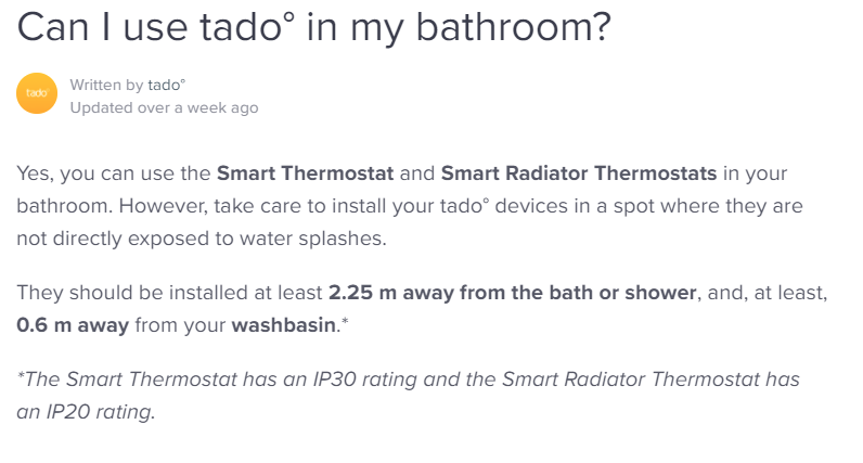

I have some Smart radiator valves made by tado from my old place. Our new place will have UFH throughout, except that in the bathrooms we'll have some small towel rads as well. I was thinking of using the Tado rad valves on those towel rads. Below is what the Tado website says. I'm thinking of installing one about 50cm from a bathtub, so in breach of the requirements. Given it is IP20 rated, what's the worst that could happen? Would the tado die from a few spashes, or could it actually be dangerous? They are battery operated, so not plugged into the mains. Is this something the BCO will spot if I breach the rules?
IPX0 is NO resistance to water (first digit is resistance to a solid object e.g a finger, second digit is resistance to water)
So I would guess they have a perforated case and any splash of water could get in and upset the electronics.

Not to a person as they are battery operated but water would be dangerous (probably fatal...) to the electronics inside. It would probably be worse as the valve on a towel rail sits on its side so you would have the unit at 90° and the casing slots would be exposed. Dripping water into it when grabbing a towel etc would be the biggest risk.

Hence the reason they say to be installed away from bath and basin!!!
