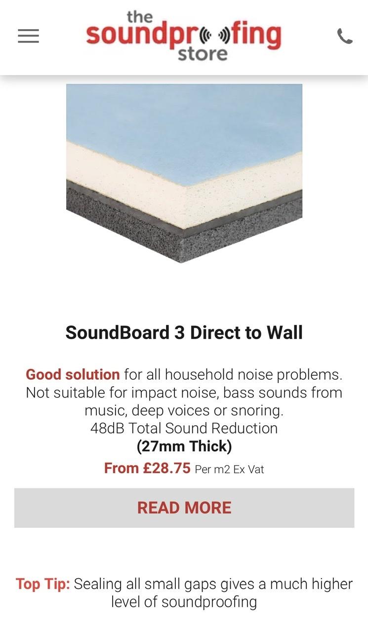

ashthekid Posted May 11, 2021 Author Share Posted May 11, 2021 @nod Unfortunately all timber stud work is up already so can’t have MF studding. Have considered res bars but will likely have battened layer. In some key areas I may decide to put some of the foam backed plasterboard which sounds like it’s quite effective. And then just fill the cavity space between the stud walls and floor joist between ground and first floor. Link to comment Share on other sites More sharing options...
Dan F Posted May 11, 2021 Share Posted May 11, 2021 (edited) 18 minutes ago, ashthekid said: @nod Unfortunately all timber stud work is up already so can’t have MF studding. Have considered res bars but will likely have battened layer. In some key areas I may decide to put some of the foam backed plasterboard which sounds like it’s quite effective. And then just fill the cavity space between the stud walls and floor joist between ground and first floor. Res bars is one of the best things you can do for sound, so I'd reconsider this is you care about sound rather than foam-backed plasterboard. Where have you read about form-backed plasterboard for acoustics out of interest? About the best you can do with standard wooden studwork, which gives you 59dB Rw, is: - 50mm acoustic roll withinn studwork - Resilient bars (just putting them on one side is almost as effective though at 56dB) - 2 layers of 12.5mm soundbloc on both sides. Resilent bars are cheap, and you can use standard PB. 15mm Soundbloc on either side for comparison gives you 40dB. 15mm Soundbloc + acoustic roll gives you 43dB. Edited May 11, 2021 by Dan F Link to comment Share on other sites More sharing options...

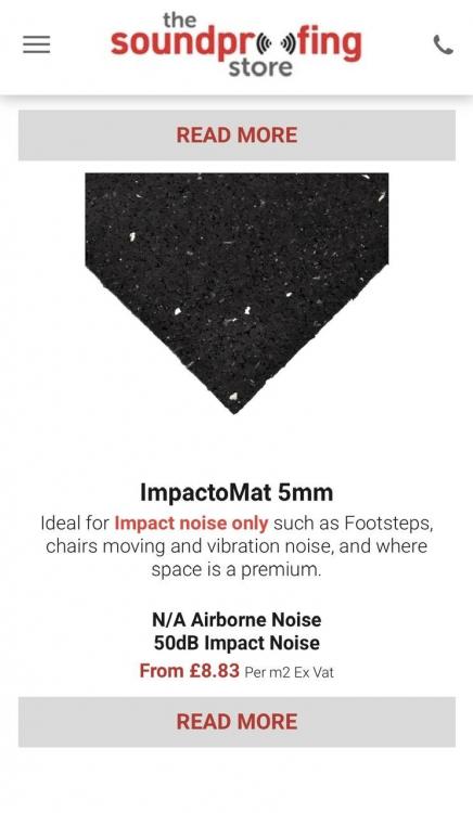

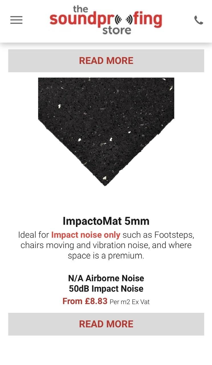

ashthekid Posted May 12, 2021 Author Share Posted May 12, 2021 @Dan F I’ve seen a few options(screenshots below) on a specialist soundproofing website but after everyone’s comments I’m beginning to think it’s not worth it. I have issues with head heights too in this project so can’t go crazy thick on floor or ceiling joists. I’ve seen this 5mm rubber matting(below) that is good for effective soundproofing a little bit. Worth the investment? Link to comment Share on other sites More sharing options...
