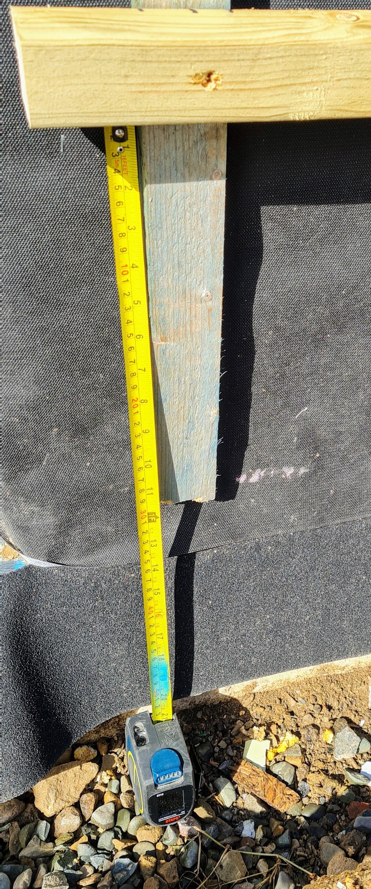

Do I need to put a counter batten lower than the one in this photo?
Apologies for the dreadful photo: the bottom of the (faded)  blue batten is 300 mm below the counter batten. The bottom of the cladding will be about 300 mm below the counterbatten in the photo.
On the rest of the wall, I'm spacing the counter battens at 400 mm centers

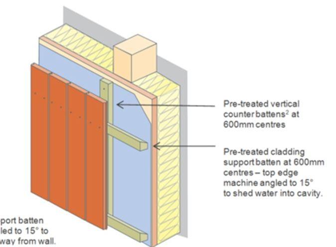

This TDCA image shows 600 centers...

Yes put in an additional horizontal batten at the end of the vertical (faded blue) batten to support the ends of the boards.
The spacing of the horizontal battens (400 or 600) might depend on the thickness of the cladding boards and the potential impact it will receive. eg if it was cladding a classroom facing a school playground where kids are playing and kicking a ball against you can be sure you'd need them at 400 no matter what the manufactures diagram says about 600mm.

I’m still sorting this but I’ve done cross batten at top of brick plinth height with a stainless steel mesh stapled to frame wrapping under counter battens and stapled to face of cross batten.  Tongue and groove larch will get stainless steel screwed to the cross batten at some point in 2021… cladding will drop circa 20mm below bottom of cross batten is the current plan, maybe with a slight chamfered profile, who knows!

On the counter batten: I'd put a floating batten just above the bottom of your cladding. It doesn't need to be attached to the vertical to "keep the ends of the boards tied together in a nice neat plane" as it were.

Yisssss! Posted just in time. Thanks very much. It takes me a-long-time-to-get-stuff-done. ? Sometimes that's a good thing eh?
