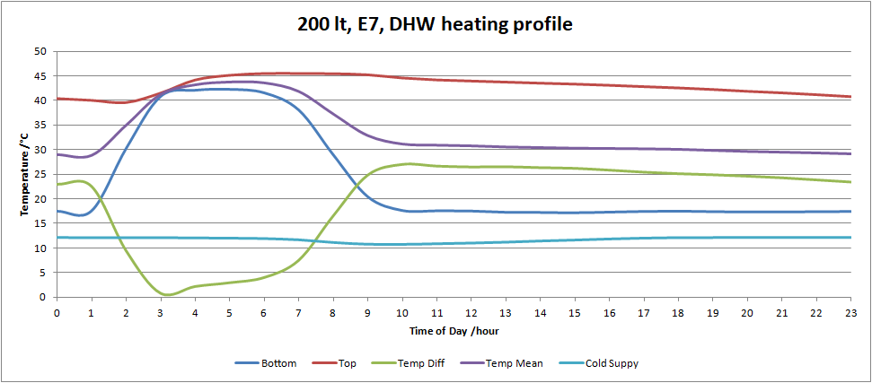

SteamyTea Posted May 6, 2021 Share Posted May 6, 2021 54 minutes ago, Ben100 said: The element is around 1/3 of the way up from the bottom. This is what happens to my E7 heated cylinder over an average day. The element is as close to the bottom as it can be. Temperature probes are at the top and the bottom. Link to comment Share on other sites More sharing options...
