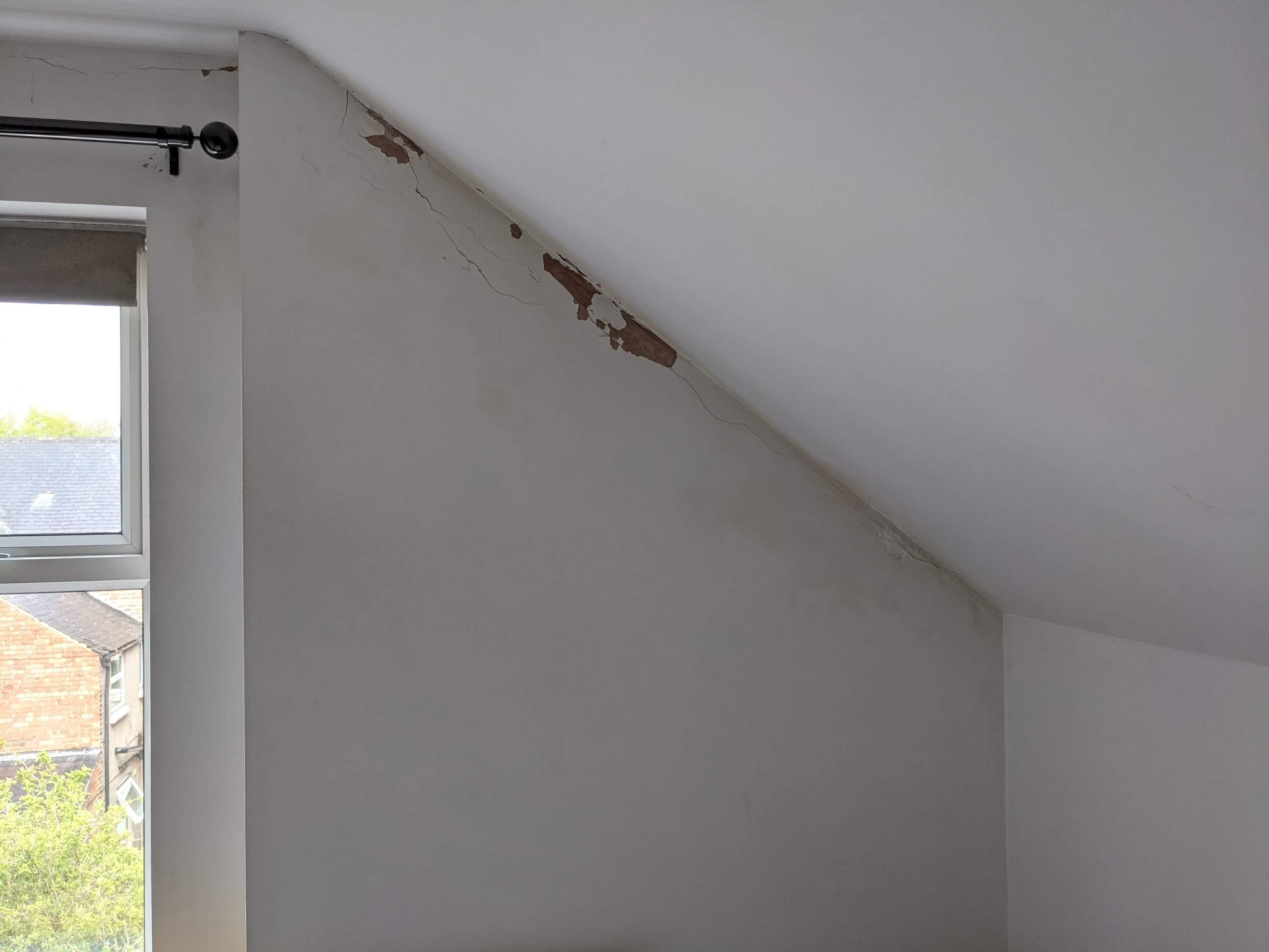

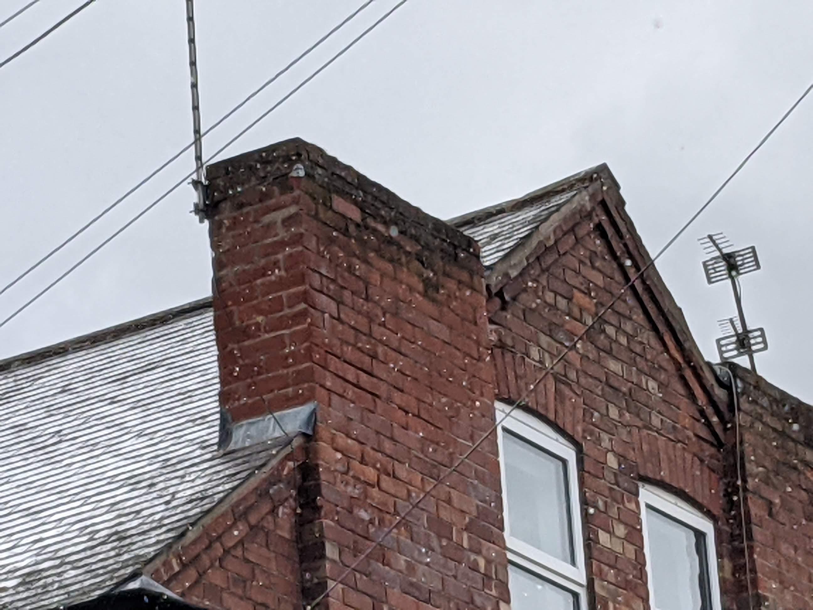

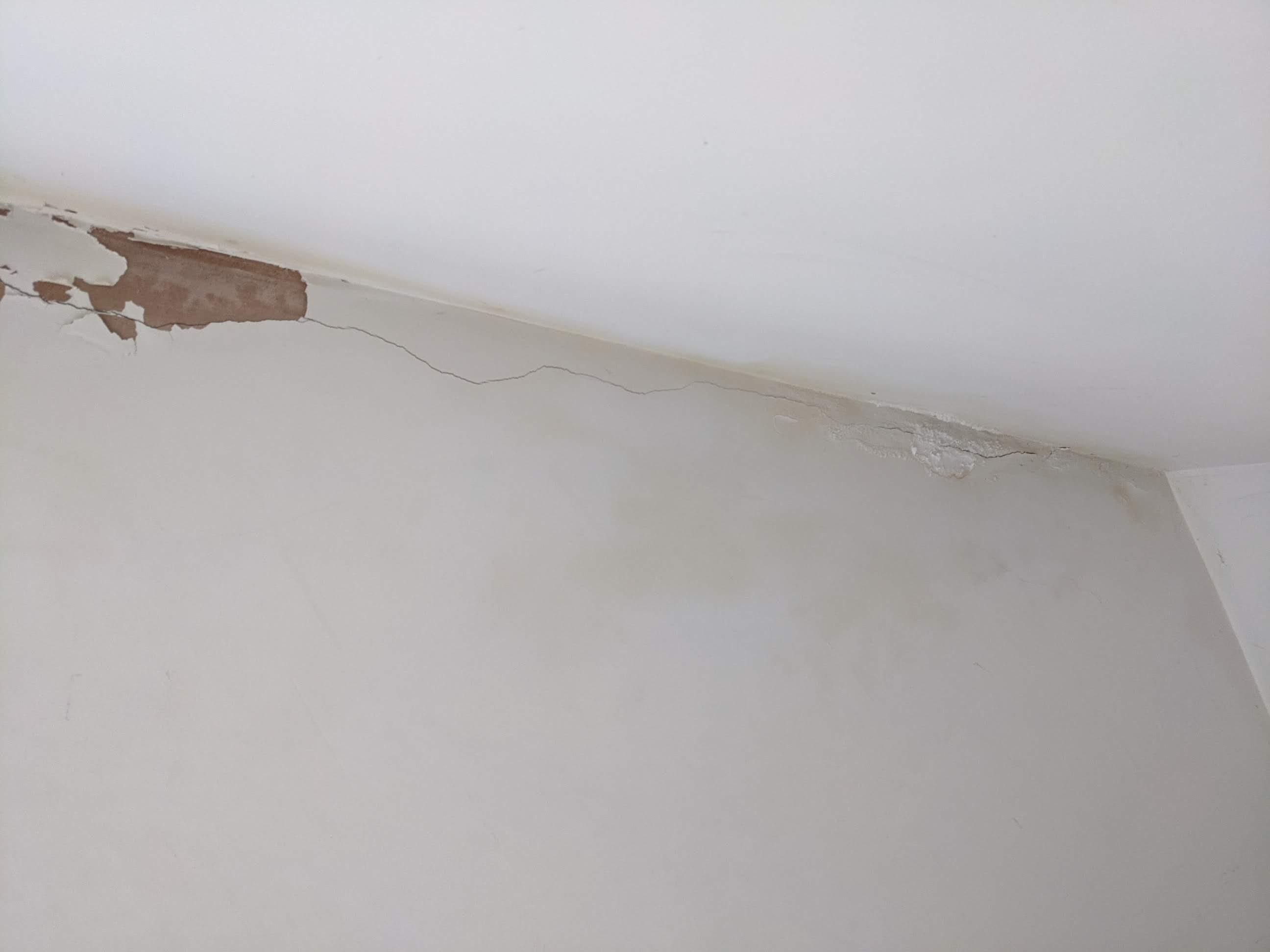

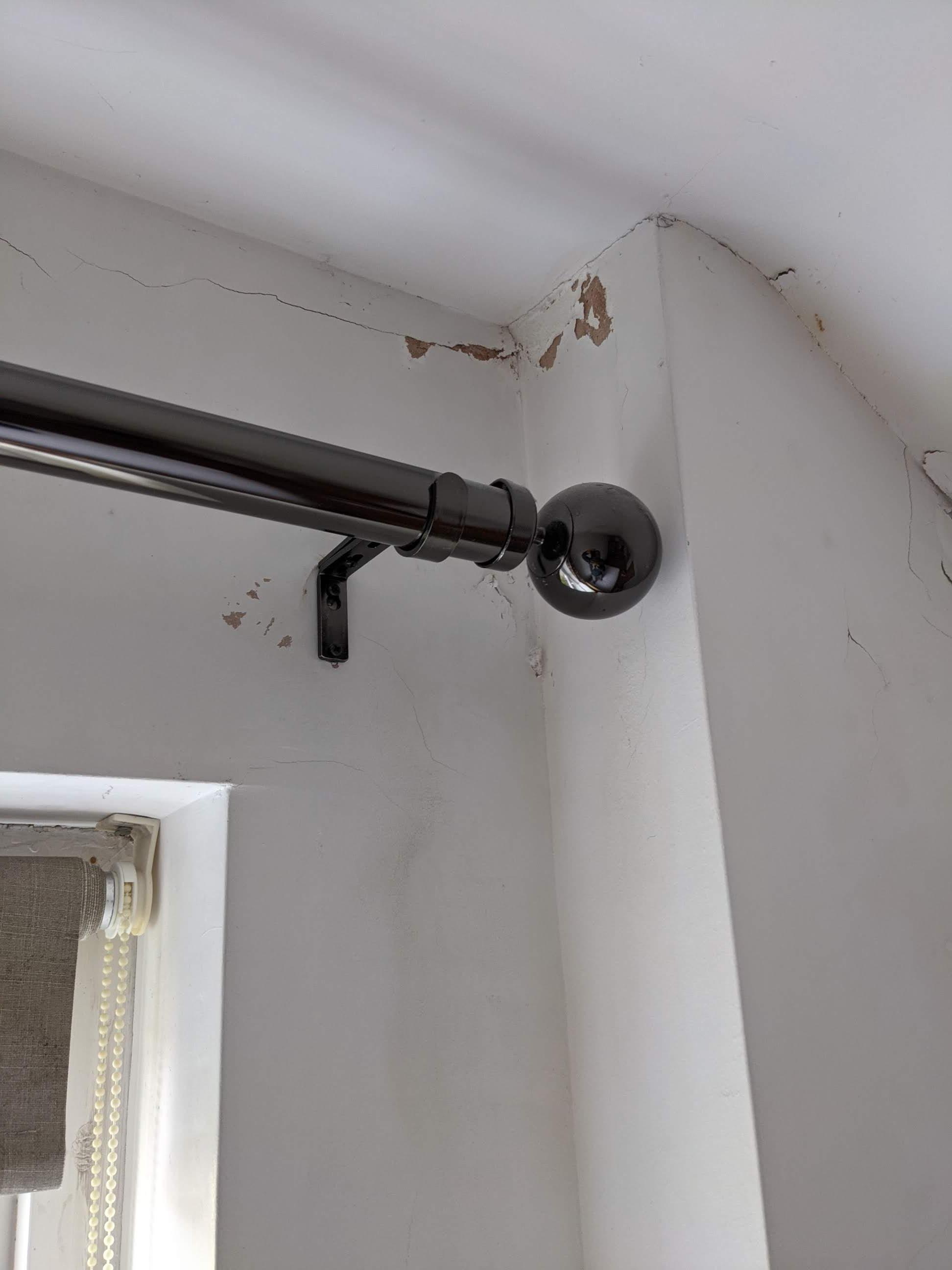

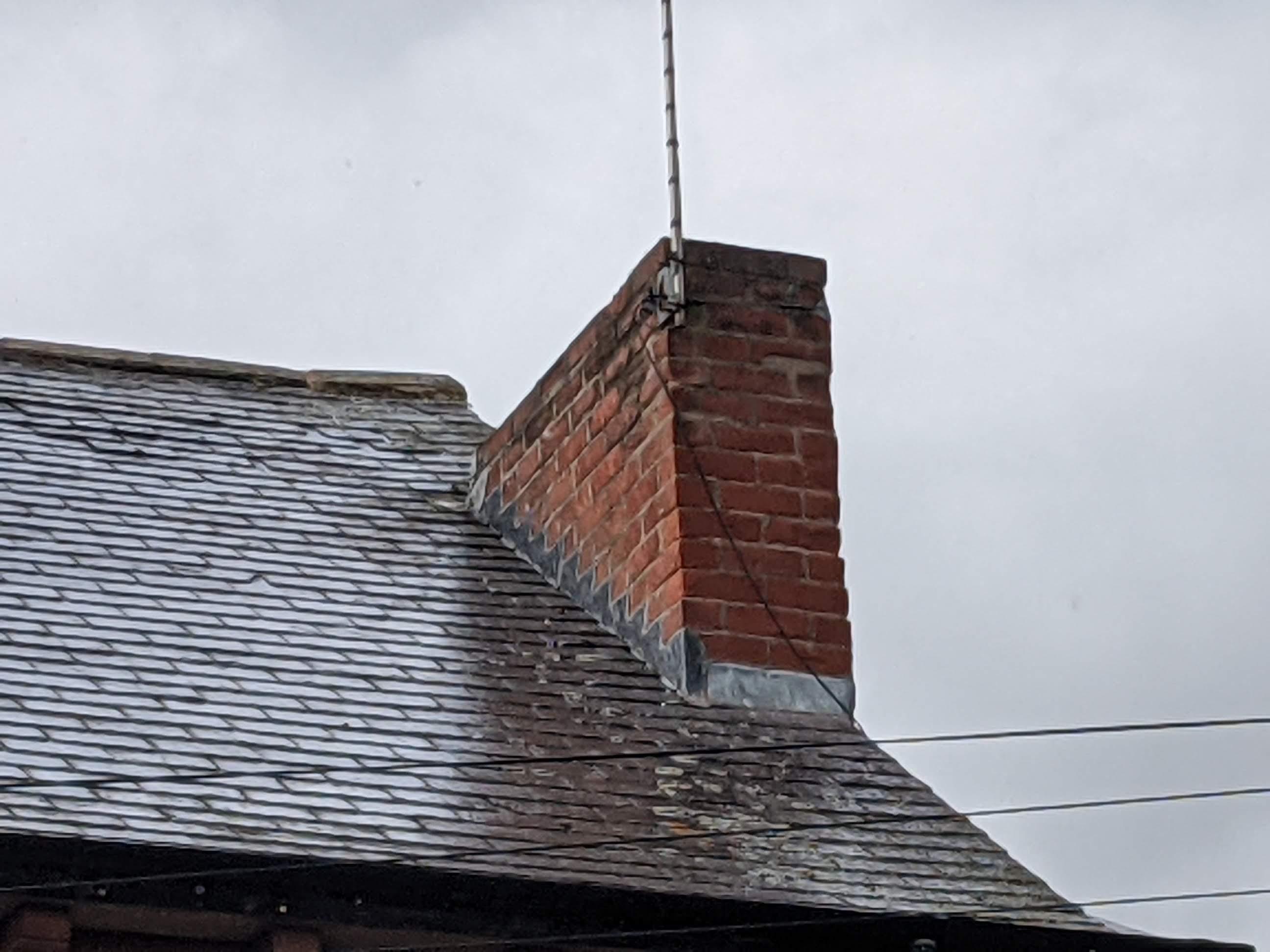

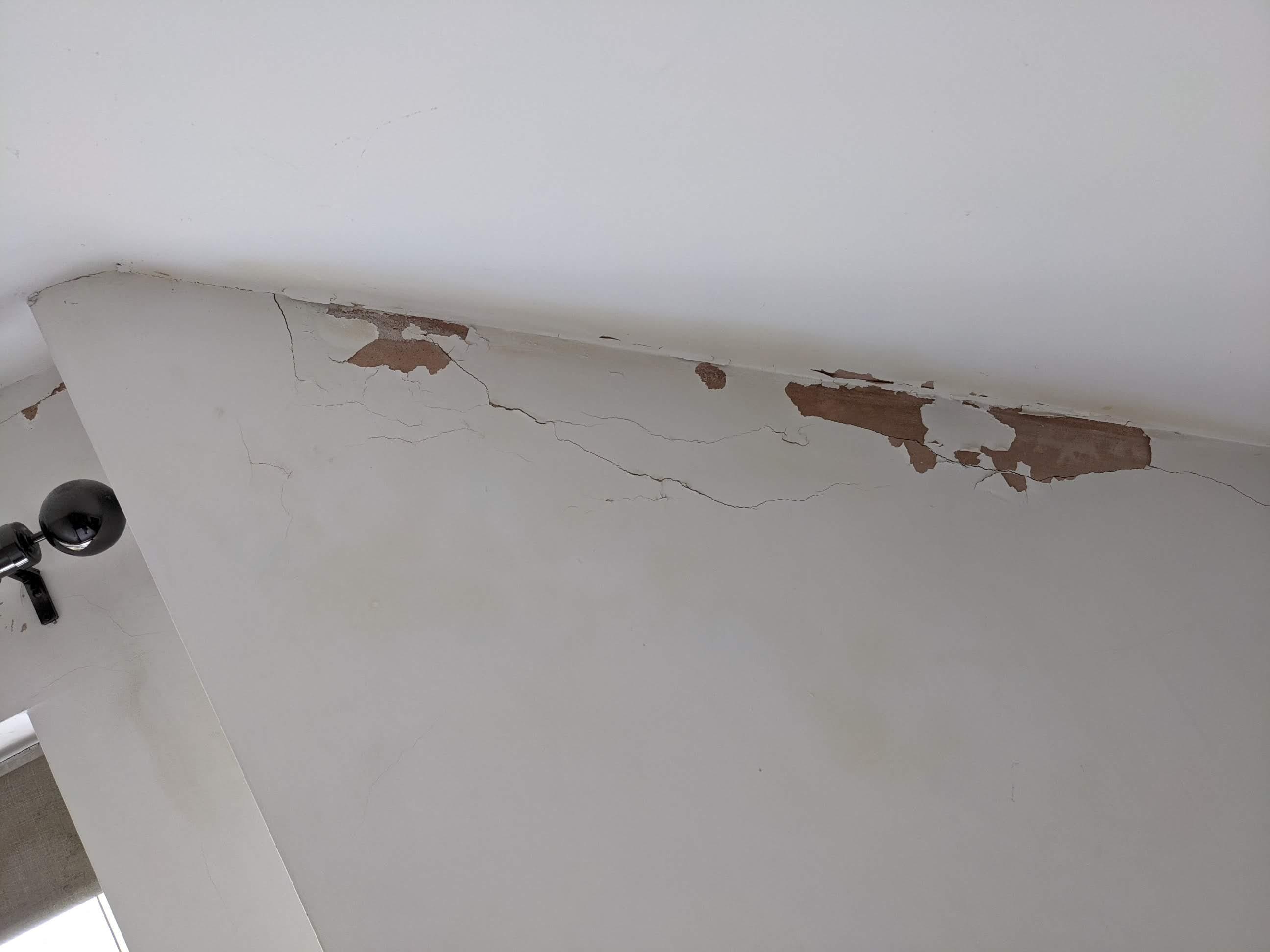

kay10 Posted May 4, 2021 Share Posted May 4, 2021 Hi, I have a problem with persistent damp coming through my chimney breast. I had two sides of chimney stack re-pointed a few years ago, and the lead has also been replaced. Unfortunately the problem has not resolved and has slowly deteriorated since. I've attached photos. Could it be that the top plate needs replacing? The Chimney is not in use. Any advise would be greatly appreciated. Thank you. Link to comment Share on other sites More sharing options...
Marvin Posted May 4, 2021 Share Posted May 4, 2021 Damp appears to be going down. Is the old chimney vented at the bottom and top to allow air to pass up and out to remove the damp? Looks like absorbent brick could try a water repellent like Thompsons weather seal to reduce the absorption. And anything else some clever person knows. M Link to comment Share on other sites More sharing options...
Roundtuit Posted May 4, 2021 Share Posted May 4, 2021 As above, make sure it's capped properly and vented top and bottom. Maybe consider taking the chimney down below roof level if its not used, or dry-lining the affected area? Link to comment Share on other sites More sharing options...
Conor Posted May 4, 2021 Share Posted May 4, 2021 Brother had same issue in a house he'd bought. Apparently several attempts to repair over the years. He got it taken down when doing other works and slated over. No issues since. It's a balance between architectural conservation and the reality of keeping a building warm and dry with reasonable techniques and costs. At some point the balance tips. Link to comment Share on other sites More sharing options...
tonyshouse Posted May 4, 2021 Share Posted May 4, 2021 Best option is to take down, Link to comment Share on other sites More sharing options...

Kernow Posted May 10, 2021 Share Posted May 10, 2021 If the lead work and slating around the chimney are good, then it’s either coming through the top or through porous brickwork. To me you have a couple options to remedy it long term 1. Take down and slate over, as previously mentioned 2. if you still use it, take it down get a lead tray detail put in it and then rebuild it Some sort of water seal treatment may work short term Link to comment Share on other sites More sharing options...
