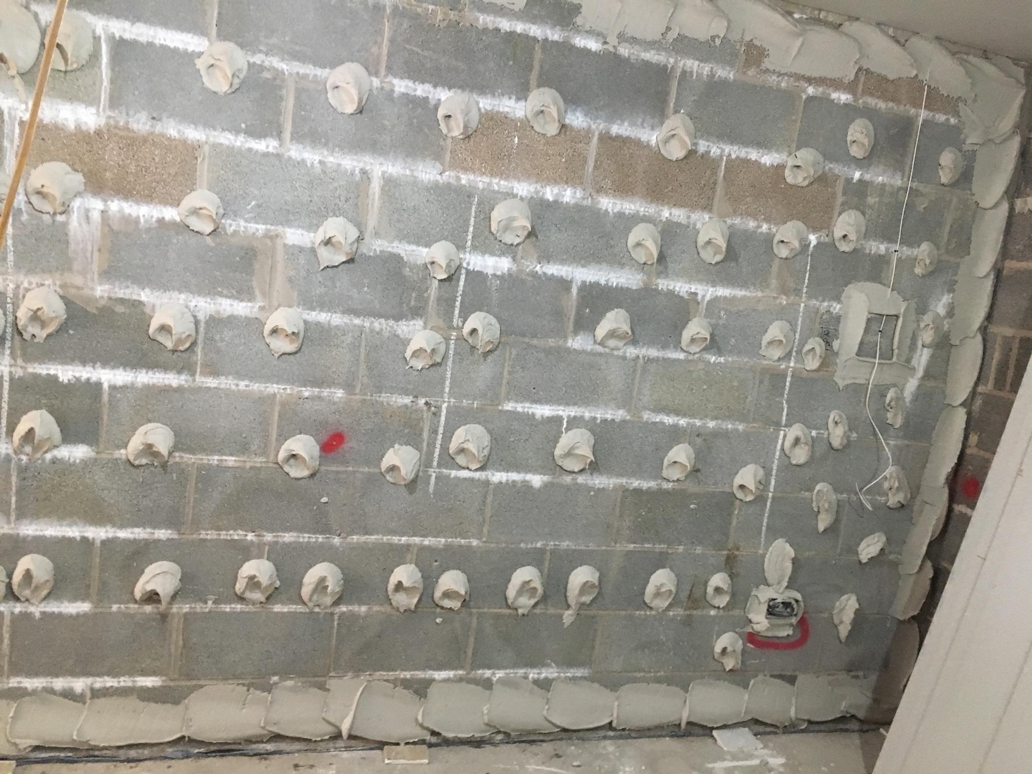

Wagas Posted May 4, 2021 Share Posted May 4, 2021 What did you guys fill this gap with? Foam? Thanks Link to comment Share on other sites More sharing options...
nod Posted May 4, 2021 Share Posted May 4, 2021 (edited) It should be solid dabbed along the skirting and up the angles no need to fill Edited May 4, 2021 by nod 1 Link to comment Share on other sites More sharing options...
Marvin Posted May 4, 2021 Share Posted May 4, 2021 Unless its airtight when I think it should be siliconed / mastic? I sure someone will correct me. (I siliconed mine at the bottom) Link to comment Share on other sites More sharing options...
nod Posted May 4, 2021 Share Posted May 4, 2021 5 hours ago, Marvin said: Unless its airtight when I think it should be siliconed / mastic? I sure someone will correct me. (I siliconed mine at the bottom) Skirting board ? Link to comment Share on other sites More sharing options...
tonyshouse Posted May 5, 2021 Share Posted May 5, 2021 But then wind/air can still get in under the floor and come out somewhere else, opposite skirting, under bath, behind door linings, downstairs through ceiling lights etc etc Link to comment Share on other sites More sharing options...
MortarThePoint Posted May 8, 2021 Share Posted May 8, 2021 Excuse my ignorance, but what are the main reasons to dob and dab rather than wet plaster? Does it work out cheaper or is it about using insulated plasterboard? Link to comment Share on other sites More sharing options...
joe90 Posted May 8, 2021 Share Posted May 8, 2021 5 minutes ago, MortarThePoint said: Excuse my ignorance, but what are the main reasons to dob and dab rather than wet plaster? Frankly I believe it’s speed and lack of knowledge on how to plaster “properly”. I will not have it in my house, I had mine cement rendered then finish plastered, not hollow sounding, airtight (subject to other precautions) and able to fix anything to. 8 minutes ago, MortarThePoint said: is it about using insulated plasterboard? That’s another matter. Link to comment Share on other sites More sharing options...
