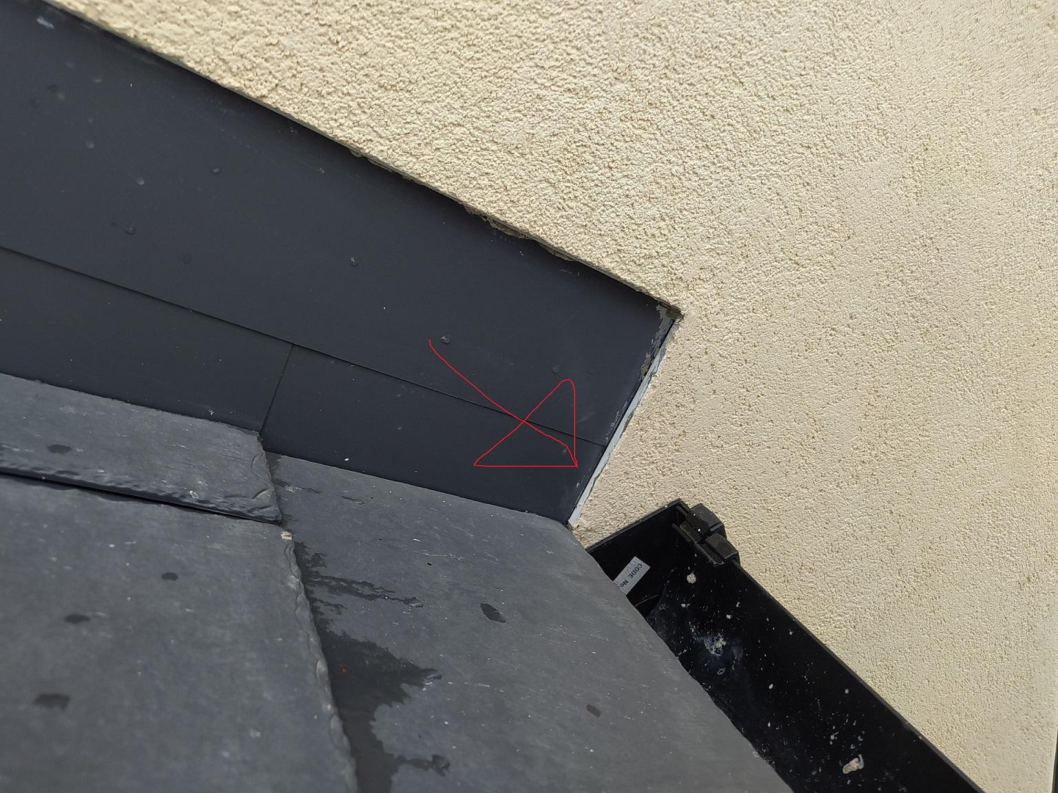

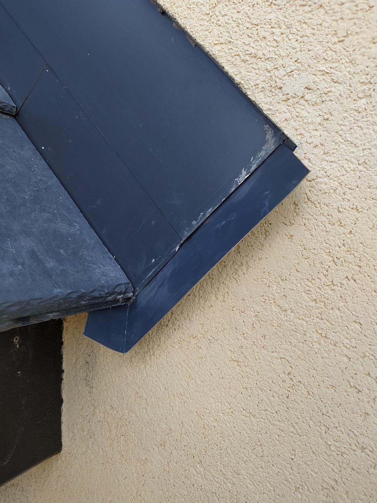

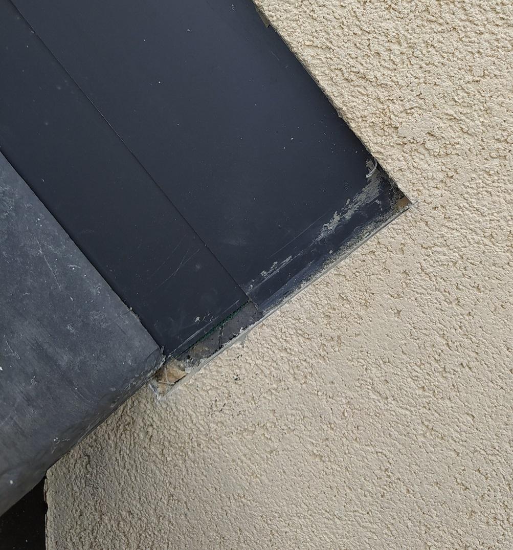

Kicking myself as I've got a small leak and looking for ideas to overcome.
Water is running down the aluminium flashing and soakers and getting behind the render. It is then presenting inside under the roof terrace.
I think the only non destructive option is a decent squirt of exterior sealant between trim and render bead. But I'm reluctant to be ever reliant on a bit of goo for long term watertight integrity.
Any great ideas?

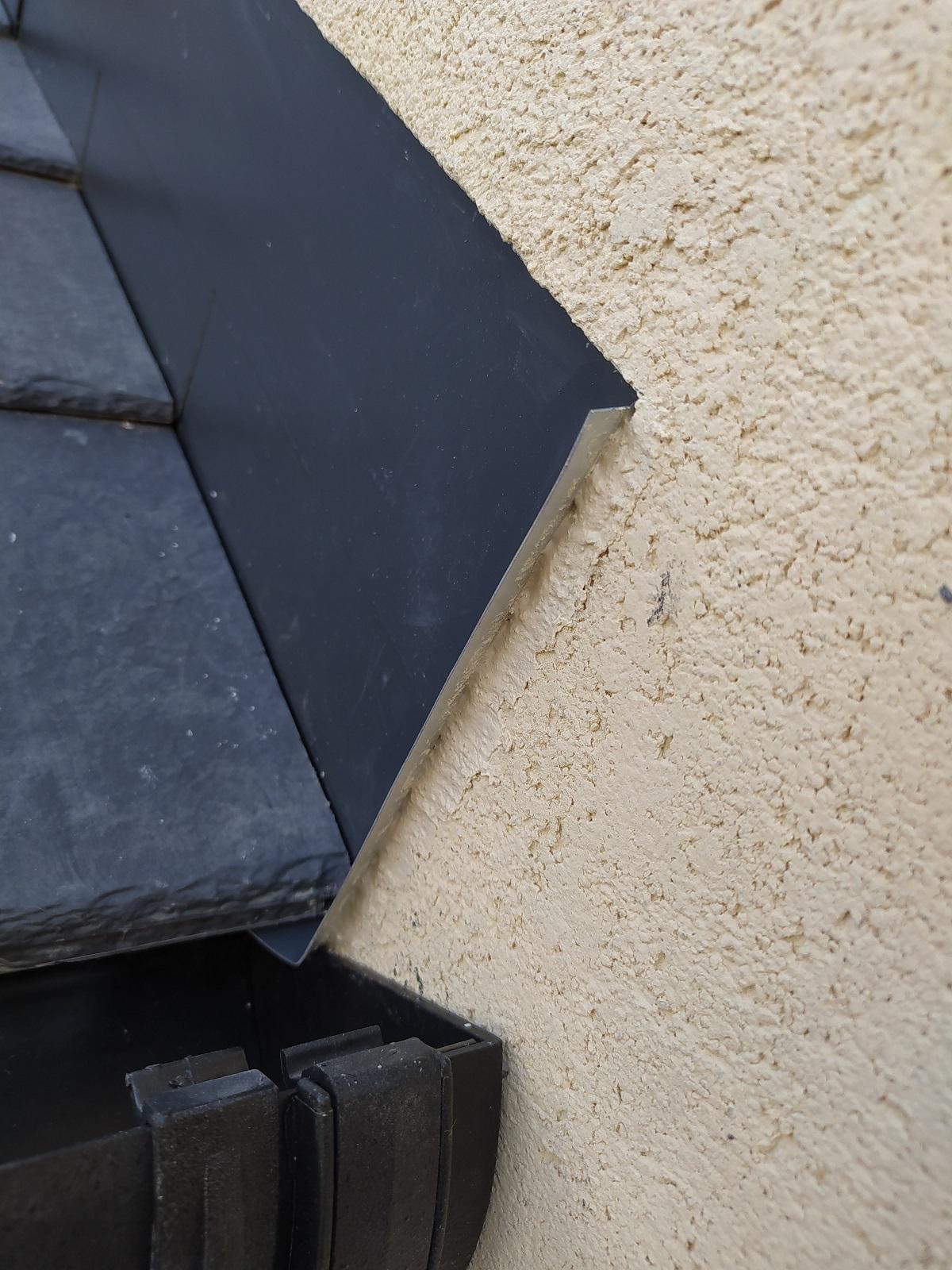

Posted

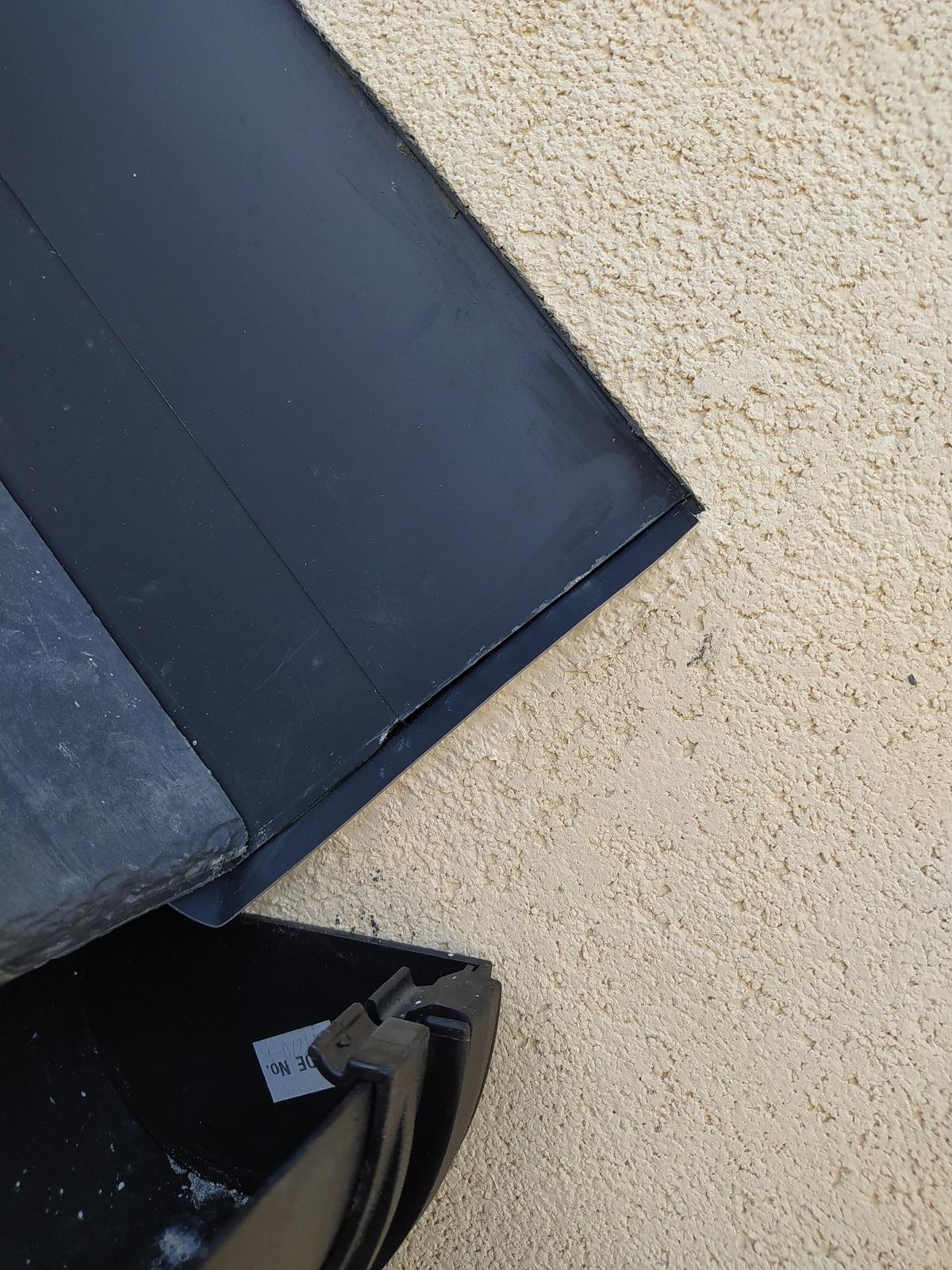

Do you have any of the aluminium left over, looks like it needs some sort of deflection away from wall . You could slot it under your existing aluminium and bend it round and away from wall.
Regards   James

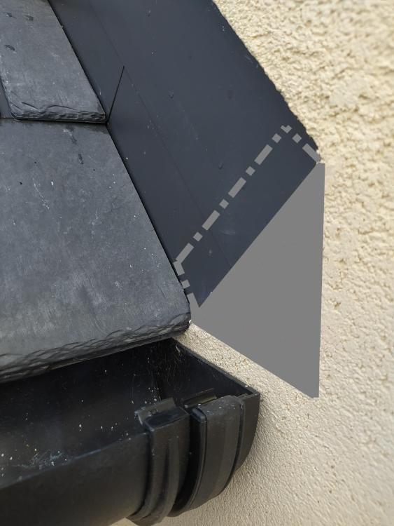

Posted (edited)
+1
 A piece like this if you can get it behind both bits of flashing..
Some sealer will be needed as well I think.

Posted
Regards   James
I agree with James about changes.  If you don't get the water from the flashing into the gutter even if you seal it it will run down render and stain.

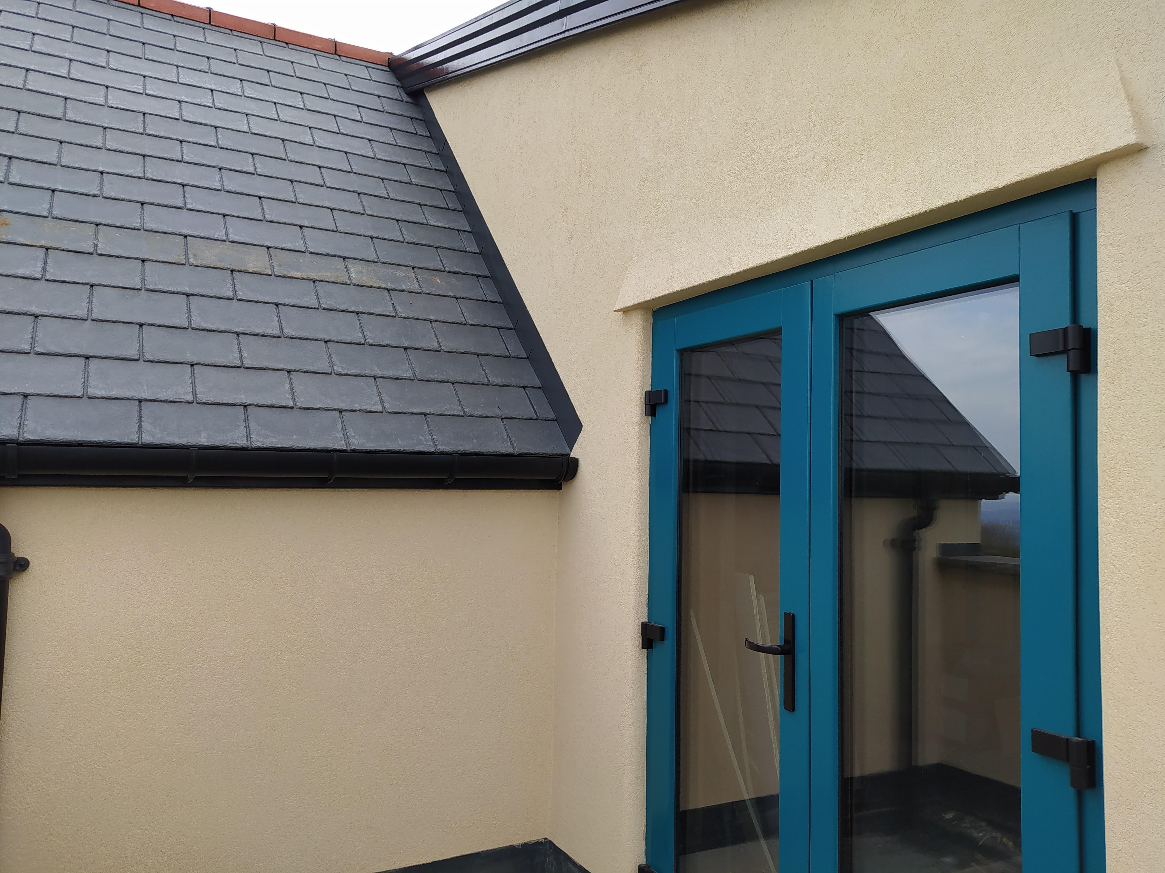

Posted
I think I'm going to try to get a small soaker in behind the other soakers and bring it out in front of the render.
Won't look as crisp as it does now but function over form it must be.

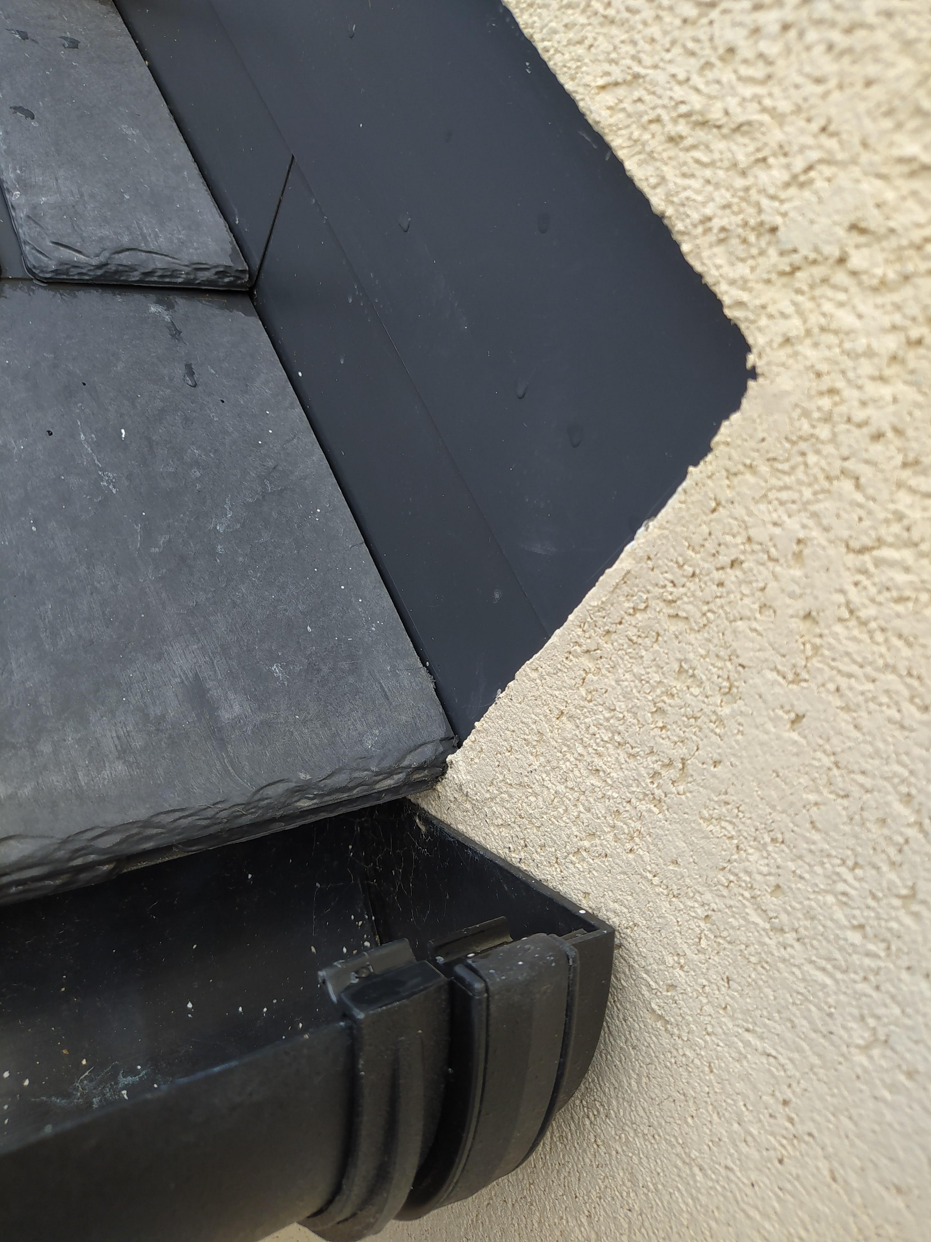

Posted

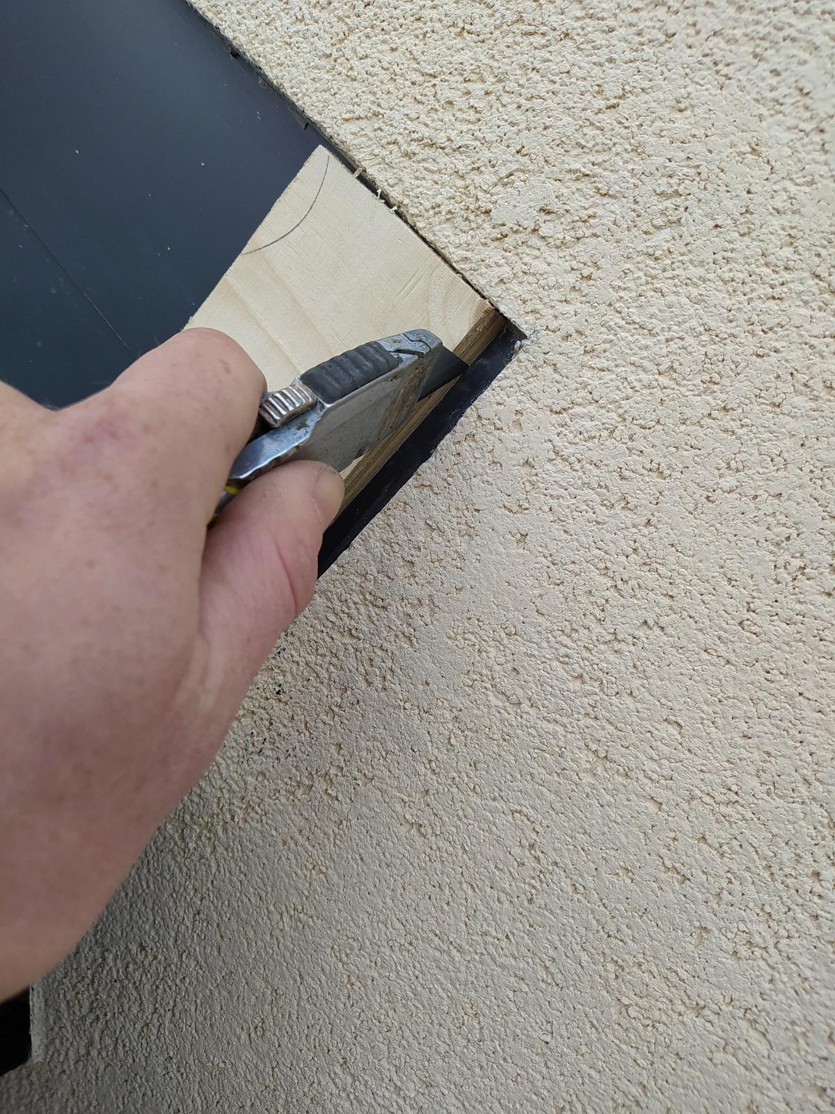

Not nearly the abomination I was fearing.
Trimmed out a piece of render. God bless thy multitool
original_13da91b8-cfae-421e-bae0-44fad7adffd6_IMG_20210502_120313.thumb.jpg.ca5a53ef0e16edca0322f4b638e5721b.jpg
Cut a slit in the apron flashing
Pushed in a piece of leftover of trim
Beauty of having 200mm EPS under the render. Banged the trim right in
Finally slap a bit of silicone render in the gap behind
Currently being storm tested...
