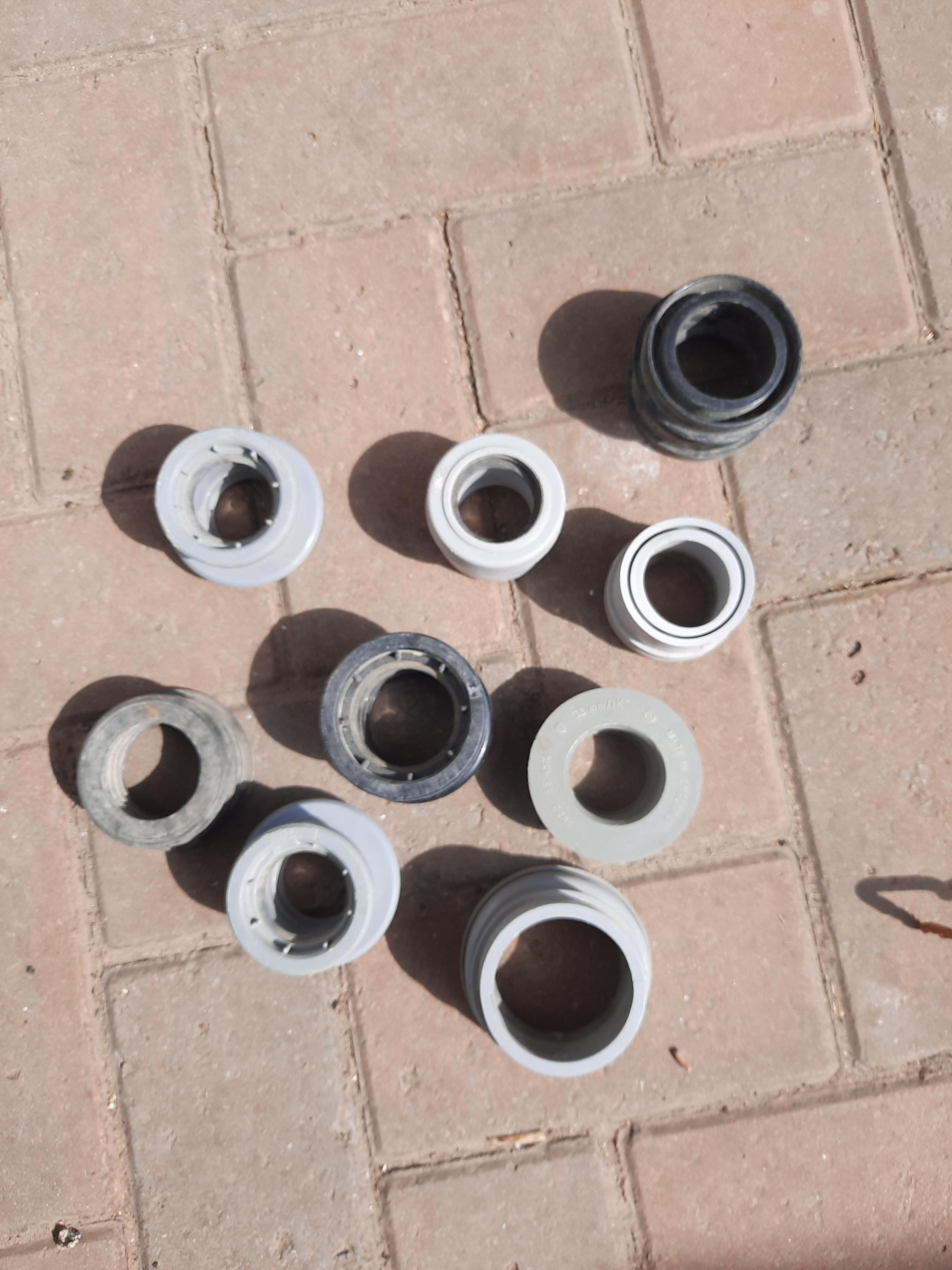

Marvin Posted April 28, 2021 Posted April 28, 2021 Sorry Conor. Complicated answer. Screwfix will supply all the parts you need but if the "40 mm waste pipe that you have " is from another supplier you may find it slightly bigger or smaller than the screw fix designed bits. I will see what I can photo for you M
wozza Posted April 28, 2021 Posted April 28, 2021 (edited) 40 minutes ago, Conor said: So can I connect 40mm solvent pipe to this kind of boss? https://www.screwfix.com/p/floplast-sp581-boss-pipe-black-110mm/97309 Yes you can, you just need a 40mm boss adaptor. You can use a rubber boss or a solvent weld boss. Edited April 28, 2021 by wozza 1
