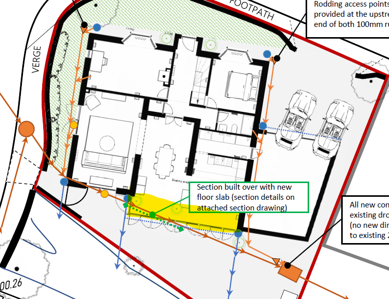

Where the foundation is running just for the benefit of glazing (i.e. no structural wall or loads on the foundation), am I best laying out the foundation so that the glazing bears on the inner edge, central, or outer edge? The glazing thickness is approx 100mm.
As there is no wall going here, I have a bit of flexibility to get the best detail for thermal efficiency (which I guess means putting the glazing/doors on the inboard edge of the footing, to maximise efficiency from any thermal break/upstand by keeping the footing outside of the thermal envelope?)
Complicating things further...

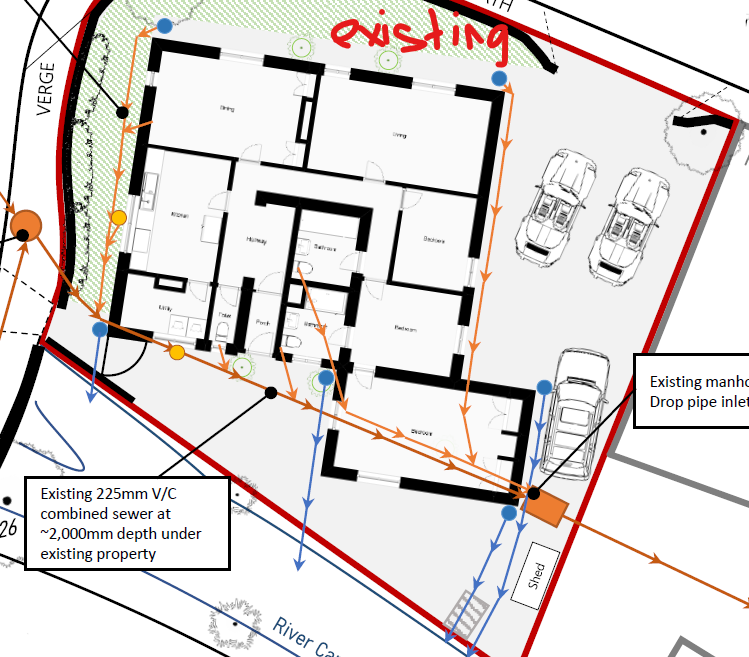

Have just been told by Severn Trent that we can't build some of the extension footings there to the current depth 1200mm as that area is above the sewer (IL ~2000mm). They want the footings taken down to below IL which is going to be fun, I suspect might even hit the water table before then!
It's literally only supporting the floor and glazing (highlighted in yellow). Could do a warm insulated raft (if they allow) but that seems overkill for this section, and I'm not sure how to deal with the external threshold (patio paving/channel drainage) as the insualtion upstand would be in the way?
Any creative ideas here? Or am I overthinking it and just need to fork out however much the builders will want to try and dig the footings down to 2m with associated shuttering etc. Really can't be affording this at the moment though...

Existing for reference
Could the windows be supported off a steel beam with pad foundations?
Thanks we could in theory yes, but the problem is I'd need a pad at that corner going down 2m to below the invert level.
And knowing my luck, it'll hit the sewer. Ironically this is in practice much riskier for damaging the sewer, even though ST would probably love the idea.
An alternative along similar lines would be some piles, but again, the chances of hitting the sewer are quite high - not fancying them odds.
do you know the exact location on-the-ground of the pipe? the drawing may not be accurate...
I can almost guarantee you that the sewer pipe shown is not where it is in reality. Dig a trial hole where you intend on building and find out.
The drawing is based off us doing a CCTV survey and joining the two manhole locations with an aerial photo (taken ourselves). The sewer is most likely not EXACTLY where the line is drawn, but even if its location is slightly off, it will 99% lie within an affected area of that extension shaded in yellow.
Wanted to avoid digging down over 2m as the builders doing it with a digger will most likely smash through the sewer, and manually will take forever with shoring the trench etc, but looks like might not have a choice if ST won't accept a raft foundation for that bit - I have asked. I wanted to avoid the raft there since it'll be more likely to result in differential movement to the rest of the house, but the same is probably true of having 2.25m footings on that bit compared to the 1.2m footings elsewhere.
