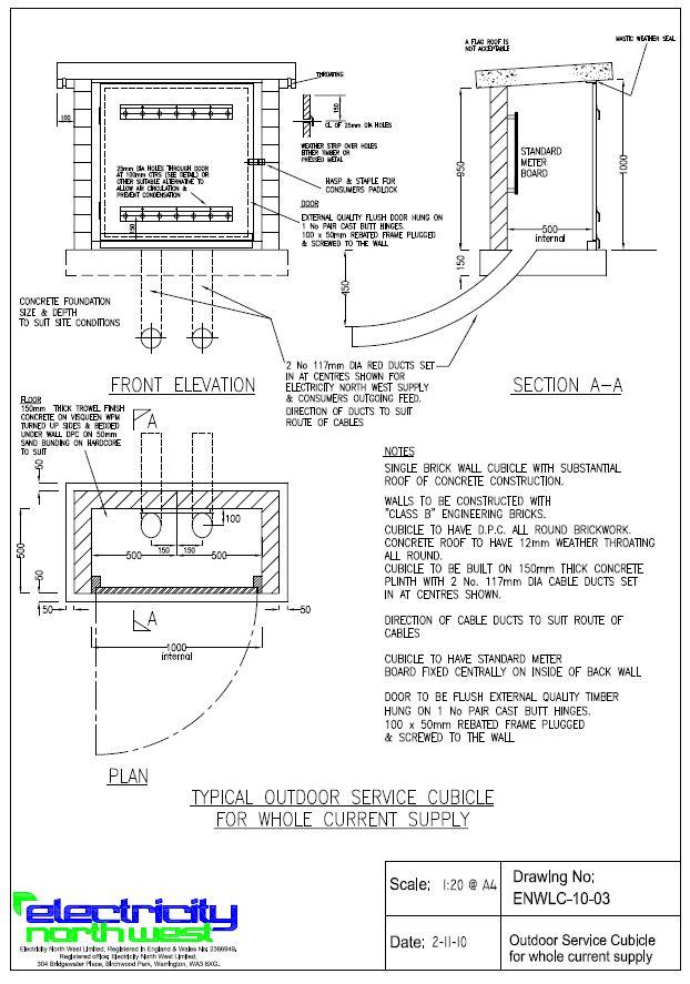

Notorious_PIG Posted April 27, 2021 Share Posted April 27, 2021 Hi all, We are building an agricultural barn which is at the bottom of a 70m track. We are looking at having a cubicle for 3 phase electricity to the site situated at the side of the track roughly 5m from the point at which the track joins the road. I have spoken to Electricity North West and they have pointed me towards these https://ritherdon.myshopify.com/collections/rb-cabinets They have also suggested we could build a brick and block one. Does anyone have any examples or specs for building a brick and block one or have reference for the install of a cabinet similar to the ones above. Many thanks Link to comment Share on other sites More sharing options...
ToughButterCup Posted April 27, 2021 Share Posted April 27, 2021 (edited) ENW did our connection: they provided me with an 'Approved Layout' I seem to remember. I'll dig it out .....here.... Maybe for three phase it has to be more substantial ? PS, they sent me a Jewson's leaflet too ...... Edited April 27, 2021 by ToughButterCup 1 Link to comment Share on other sites More sharing options...

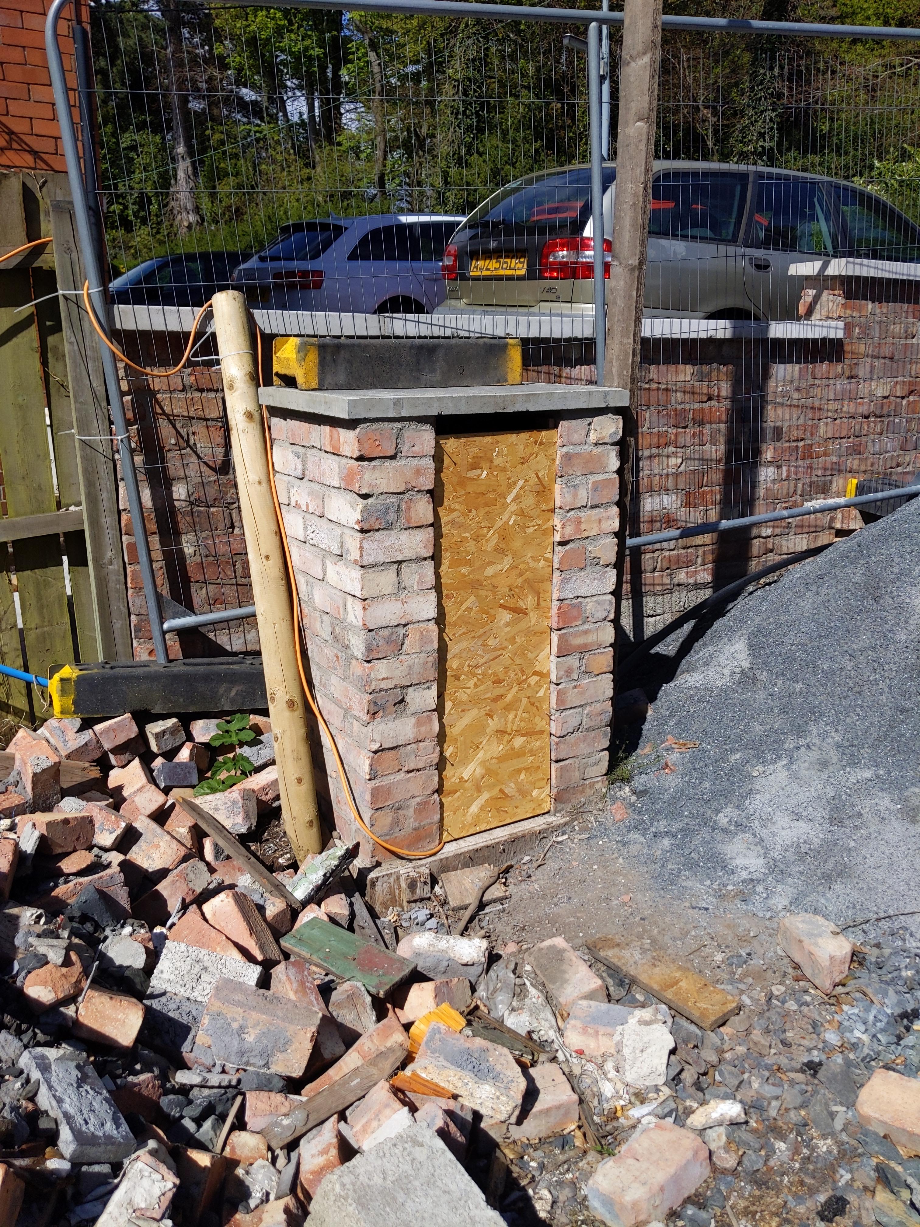

Conor Posted April 27, 2021 Share Posted April 27, 2021 Here's one I made earlier Link to comment Share on other sites More sharing options...

Bonner Posted April 27, 2021 Share Posted April 27, 2021 5 hours ago, ToughButterCup said: ENW did our connection: they provided me with an 'Approved Layout' I seem to remember. I'll dig it out .....here.... Maybe for three phase it has to be more substantial ? PS, they sent me a Jewson's leaflet too ...... My DNO sent me the same drawing but accepted a GRP cabinet, which I bought on EBay. Note the drawing title ‘typical’ ... cubicle. Link to comment Share on other sites More sharing options...
