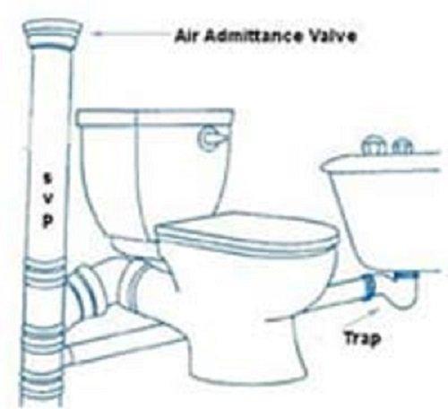

Temp Posted April 21, 2021 Share Posted April 21, 2021 (edited) 2 hours ago, TryC said: I'm not sure what a stub stack is. Its unlikely you have one. It's like a regular stack but shorter. Instead of going out through the roof to an open vent a stub stack is usually only a few feet high and has an Air Admittance Valve on it. If you have one its probably hidden in boxing in the corner of the down stairs WC. If you had a stub stack already its probably not a hard job to extend it upwards to the new bathroom above. They look something like this.. Its more likely you have a direct connection of some sort like this... The ease with which you can add a stack for upstairs depends on what that existing downstairs room and WC connection is like and what changes can be made in that room. In the example below the WC has been moved sideways (or rather replaced with a different one off to one side) and the pipe extended upstairs. In practice the new pipe would be hidden behind boxing or a false wall so the WC might also be slightly further forward. If that's not possible the cistern could concealed or recessed into the boxing/false wall. This is what my downstairs WC looks like. The stack is hidden on the left as you look at it... The point really is it might not be necessary to put a new hole in the floor. Quote Surely, if it is easier to run a new stack up on the outside, the ones that have come would of said? I would I need to specifically ask for this? (as if I know what I am talking about! ha ha) It depends. If you cant do something like above then an outside stack would be the next thing to look at rather than digging up concrete(?) floors. Perhaps they didn't want to have to dig up your patio?. Does the downstairs WC connect into an inspection chamber outside? Perhaps post a bunch of photos and we can suggest other ways forward. PS I'm away travelling tomorrow so may not reply for a day or two. Edited April 21, 2021 by Temp 1 Link to comment Share on other sites More sharing options...

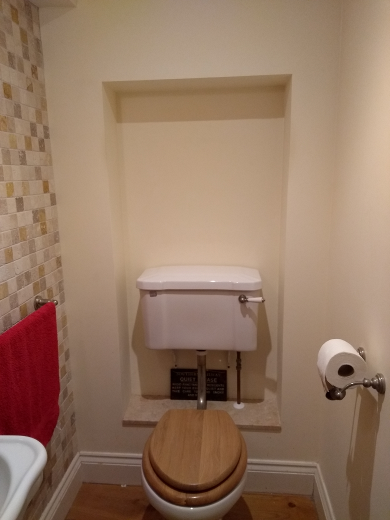

TryC Posted April 21, 2021 Author Share Posted April 21, 2021 52 minutes ago, Temp said: Its unlikely you have one. It's like a regular stack but shorter. Instead of going out through the roof to an open vent a stub stack is usually only a few feet high and has an Air Admittance Valve on it. If you have one its probably hidden in boxing in the corner of the down stairs WC. If you had a stub stack already its probably not a hard job to extend it upwards to the new bathroom above. They look something like this.. Its more likely you have a direct connection of some sort like this... The ease with which you can add a stack for upstairs depends on what that existing downstairs room and WC connection is like and what changes can be made in that room. In the example below the WC has been moved sideways (or rather replaced with a different one off to one side) and the pipe extended upstairs. In practice the new pipe would be hidden behind boxing or a false wall so the WC might also be slightly further forward. If that's not possible the cistern could concealed or recessed into the boxing/false wall. This is what my downstairs WC looks like. The stack is hidden on the left as you look at it... The point really is it might not be necessary to put a new hole in the floor. It depends. If you cant do something like above then an outside stack would be the next thing to look at rather than digging up concrete(?) floors. Perhaps they didn't want to have to dig up your patio?. Does the downstairs WC connect into an inspection chamber outside? Perhaps post a bunch of photos and we can suggest other ways forward. PS I'm away travelling tomorrow so may not reply for a day or two. Thanks for your advice and information. It is very useful. I managed to take some photos to show you the existing downstairs WC. Pardon the dusty images ha ha. I have included two photos of the internal pipe of the toilet downstairs. We actually got this fitted about 17 years ago. I don't particularly like the pipe they used but the fitter is the neighbours son (who is a joiner), don't even get me started on that blob of plaster/cement... The original toilet was one of the old style types, I don't actually recall seeing a pipe on the old one, just a little pipe running up the wall which connected to the cistern and a pulley thing to flush! The third photo is of the outside of the WC. I hope this makes sense. Apparently, the soil drain and fresh water drains are separate and not combined like what is more common these days. Link to comment Share on other sites More sharing options...

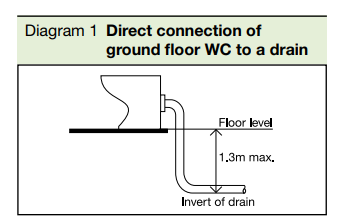

ProDave Posted April 21, 2021 Share Posted April 21, 2021 So that is probably a clay or cast iron pipe in the ground. The old WC would have been the type where the outlet went straight down into the pipe in the floor. That flexi pipe and the cement is a bodge. If that pipe and hopper in the last picture is the basin waste and is going into the foul drain then you can convert that to an external stack but you will need to dig up a bit of the patio around the open gulley to do that. 1 Link to comment Share on other sites More sharing options...
TryC Posted April 21, 2021 Author Share Posted April 21, 2021 55 minutes ago, ProDave said: So that is probably a clay or cast iron pipe in the ground. The old WC would have been the type where the outlet went straight down into the pipe in the floor. That flexi pipe and the cement is a bodge. If that pipe and hopper in the last picture is the basin waste and is going into the foul drain then you can convert that to an external stack but you will need to dig up a bit of the patio around the open gulley to do that. Thanks! the last photo is the pipe, i think is for the sink and bath tub upstairs. I think, the little top bucket thing actually has two little pipes going into it - I'll have to check tomorrow. I know right, proper bodge (haha, I haven't heard that word in a while), I got home and I found that installed I was fuming, but my family said leave it since it was the neighbour's son. but I PAID for it, it wasn't like it was a free job, I wouldn't have room to complain if it were free right, but I paid hard earned money for a new toilet fit and a got a blob of cement and a plastic goose looking pipe.? When you say convert the external stack, do you mean, leaving the toilet inside on the downstairs as is and just bringing it up on the outside so it can be connected to the upstairs? Link to comment Share on other sites More sharing options...
Temp Posted April 21, 2021 Share Posted April 21, 2021 (edited) I believe what @ProDave means is removing the gully where the pipe enters the patio and replacing with a bend (Its ok for a rainwater or grey water pipe to go into a gully but soil pipes shouldn't be open at ground level). Also replacing the hopper/bucket with a branch or two, one of which would be for the new WC, the other for the existing bath/basin. The downstairs WC need not be touched. If I was doing it I would probably just replace the whole pipe with matching ffittings. Possibly in regular black plastic or the stuff that replicates cast iron pipe? https://www.screwfix.com/p/floplast-cast-iron-effect-sp192ci-92-5-branch-black-110mm/23548?tc=IB6&ds_kid=92700055281954505&ds_rl=1249404&gclid=CjwKCAjwmv-DBhAMEiwA7xYrdxNEIQ6Z709Ebv7L7YfpbHbGsQeh0aJ6xZXquXBwSMwSPhnTCFMu1RoCiAgQAvD_BwE&gclsrc=aw.ds The hardest part is probably drilling a 110mm hole in the stone for the WC pipe. Edited April 21, 2021 by Temp Link to comment Share on other sites More sharing options...

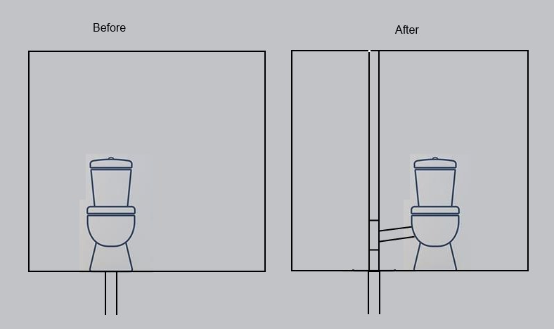

TryC Posted April 22, 2021 Author Share Posted April 22, 2021 9 hours ago, Temp said: I believe what @ProDave means is removing the gully where the pipe enters the patio and replacing with a bend (Its ok for a rainwater or grey water pipe to go into a gully but soil pipes shouldn't be open at ground level). Also replacing the hopper/bucket with a branch or two, one of which would be for the new WC, the other for the existing bath/basin. The downstairs WC need not be touched. If I was doing it I would probably just replace the whole pipe with matching ffittings. Possibly in regular black plastic or the stuff that replicates cast iron pipe? https://www.screwfix.com/p/floplast-cast-iron-effect-sp192ci-92-5-branch-black-110mm/23548?tc=IB6&ds_kid=92700055281954505&ds_rl=1249404&gclid=CjwKCAjwmv-DBhAMEiwA7xYrdxNEIQ6Z709Ebv7L7YfpbHbGsQeh0aJ6xZXquXBwSMwSPhnTCFMu1RoCiAgQAvD_BwE&gclsrc=aw.ds The hardest part is probably drilling a 110mm hole in the stone for the WC pipe. thanks for further explaining. Yes, I had one fella say that he needs to get in a specialist to drill the hole as he doesn't have the type of drill. How much would you say this kinda of project should cost - all I am getting is a lot of maybe's and it depends on how far they have to dig. I have also shown them a map from united utilities to show them the pipes placement (but it is more of a sketch and doesn't tell them exactly where it is). Also, should I be wary of contractors who are not even aware that they need to meet with the local councils (regardless of the property being council or non-council) to discuss about about building regulations and keeping in-line with the regulations of connecting to the correct pipes for the the soil stack waste? Thanks again! Link to comment Share on other sites More sharing options...

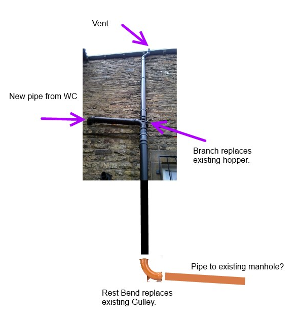

Temp Posted May 6, 2021 Share Posted May 6, 2021 (edited) This is a rough idea of what I would expect you to end up with. Ive not shown the connections for the bath/basin but they would either connect into the new branch or possibly another above it. I'd replace all the grey pipe with new black. Brown pipe underground. Edited May 6, 2021 by Temp Link to comment Share on other sites More sharing options...
TryC Posted May 6, 2021 Author Share Posted May 6, 2021 29 minutes ago, Temp said: Ideally you want to prove that water from both the upstairs bath and downstairs WC end up in the same pipe/manhole. Doesn't matter where it is. This is to rule out the remote possibility that the upstairs bath water currently goes to a soakaway (You can't put poo in a soakaway). Assuming everything ends up in the same sewer eventually then.... Thats what we expected. The question is where does it go next. Ideally you would find a manhole not far away from the gulley with bath water flowing through it. That will tell you where the pipe from upstairs goes after the gulley. Perhaps you already found that manhole but your post wasn't clear on this. Thanks for your input. Sorry if my post was not clear Excuse my bad drawing - I never took Art at school, because I was so bad at it ha aha The drawing is the back of the house - included is the hopper with the two pipes taped together. The manhole is actually on my property some few yards away in the garden. When I lifted it up a small flow of water was constant going from a left to right flow direction. When I turned on the water upstairs there wasn't anything affecting the water in this man hole, but then again, neither did the toilet downstairs when I flushed it - but I could hear it drain away. The pipe map I received from united utilities indicate the foul pipe runs through my garden, and then the fresh water pipe runs through the front of the house (under the road). Yet, even when I share this map with people coming to quote, they I guess do not find this into useful? Should it not at least give them some indication? Link to comment Share on other sites More sharing options...
