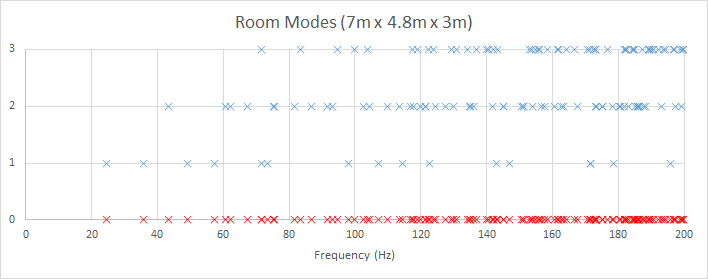

SimonD Posted April 23, 2021 Share Posted April 23, 2021 (edited) Before going out and buying a load of panels, plus everything else you need, I'd highly recommend you get yourself a spectrum analyser. There are apps you can download onto your phone. You also need to work out the room's frequency response. This way you'll have any idea of the frequencies you need to target within the room to get the best results and know whether the room is likely to amplify certain frequencies. You can also measure ambient background noise produced by mvhr, pumps, washing machoines etc. so their noise gets dealt with too. Looking at the acoustic panels, they provide very good noise absorption around about 1k Hz and above, but because they're thin their effectiveness will be reduced for lower frequencies (the sharp edges help a bit for refraction) as you'll see by the graphs produced by the manufacturer. TBH it is a bit pointless to spend loads on targeting higher frequencies only to be left with annoying low freguency hums, or the bass of a male voice. You can get free software to help calculate the room modes, like Modecalc, which also has a tutorial. Otherwise, there are products like Celenit and Savolit wood wool boards that have acoustic certification. Celenit has a calculation service to help with room design. Here's also a link to a document that shows some common absorption coefficients of materials so you can compare to the products you're looking at. Noise control in Rooms HTH. Edited April 23, 2021 by SimonD 1 Link to comment Share on other sites More sharing options...
Moonshine Posted April 23, 2021 Share Posted April 23, 2021 1 hour ago, SimonD said: You can get free software to help calculate the room modes, like Modecalc, which also has a tutorial. Caution if using this software as it only calcs axial modes, not tangential and oblique modes, which can cause issues as well though are not as strong as axial modes as get absorbed / diffused by room surfaces. Below is the room mode calc based on the modecalc example for all mode types (all = 0, axial = 1, tangential =2, oblique = 3), and there is a couple of tangential modes combining at around 75 Hz (75.3 and 75.5 Hz). In regard to modes you want to get a nice even modal density so that the frequency response of the room is as flat as possible and any spikes are smooths via absorption or diffusion. 2 Link to comment Share on other sites More sharing options...
