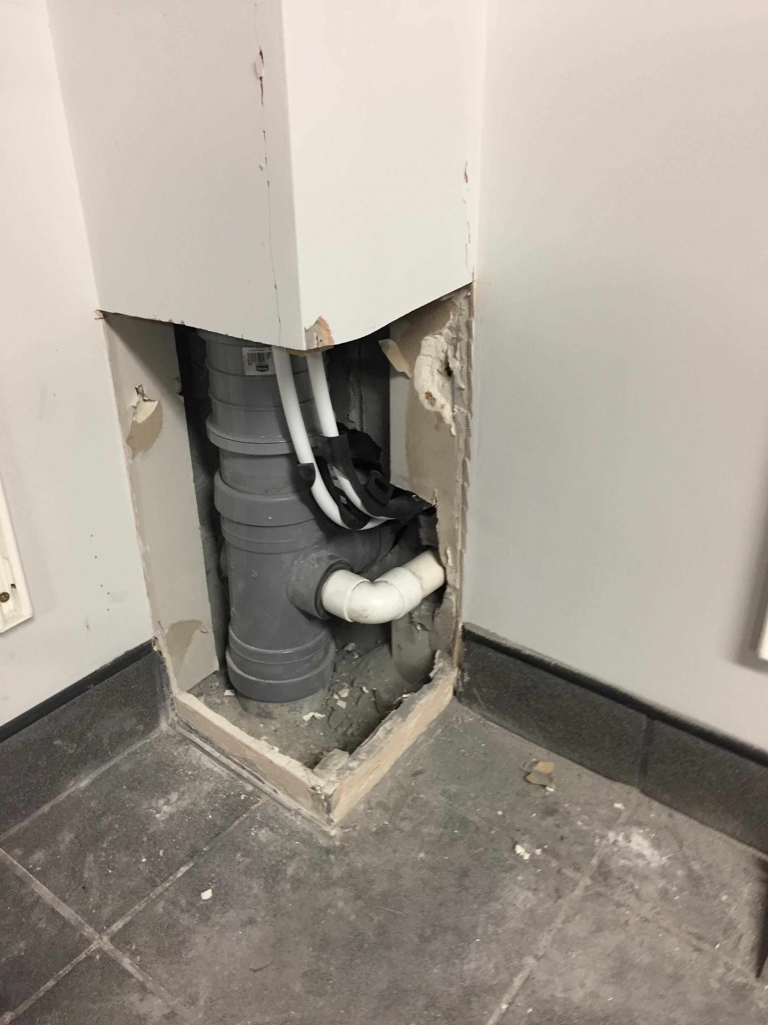

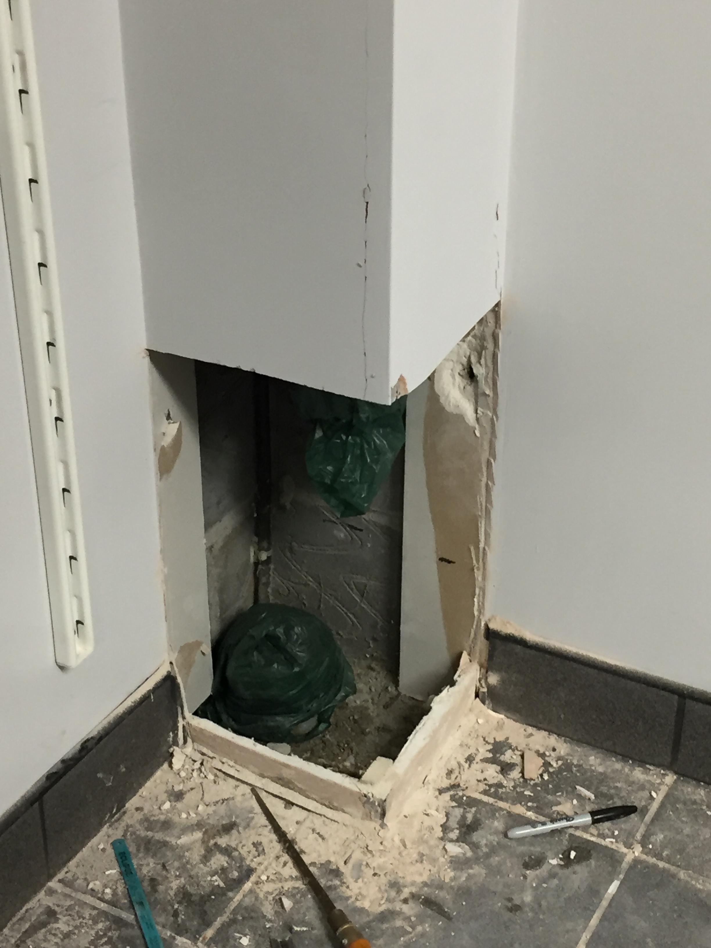

Barney12 Posted February 23, 2017 Share Posted February 23, 2017 Right this weekend I'm going to tackle a job I've been putting off for ages. I need to add a branch to the base of the existing stack which rises from the ground floor to the flat en-suite. Its so I can put the outside toilet in for use by the various trades that will (hopefully) be arriving in due course. Thankfully I think I can lift the stack up by a few hundred mm to aid popping the new branch in but the stack is fairly tight to the corner of the wall. So..... I've got to cut out the section of 110mm stack, lift it up and somehow hold it up to enable me to core drill the wall for the branch, pop the new tee in, pop it back together and Bobs your best mate. What I'm pondering is how to cut and chamfer the pipe? If it will twist (and until I cut away the plasterboard boxing in, I cant remember if the floor screed covers the joint) then the trusty Fien multi-tool will do just fine. But if it wont twist, what then? Pad saw? Hacksaw blade in a handle? But how am I going to chamfer round the back? I have this crushing feeling this is a job that might put me in a bad mood Any tips greatly received! Link to comment Share on other sites More sharing options...

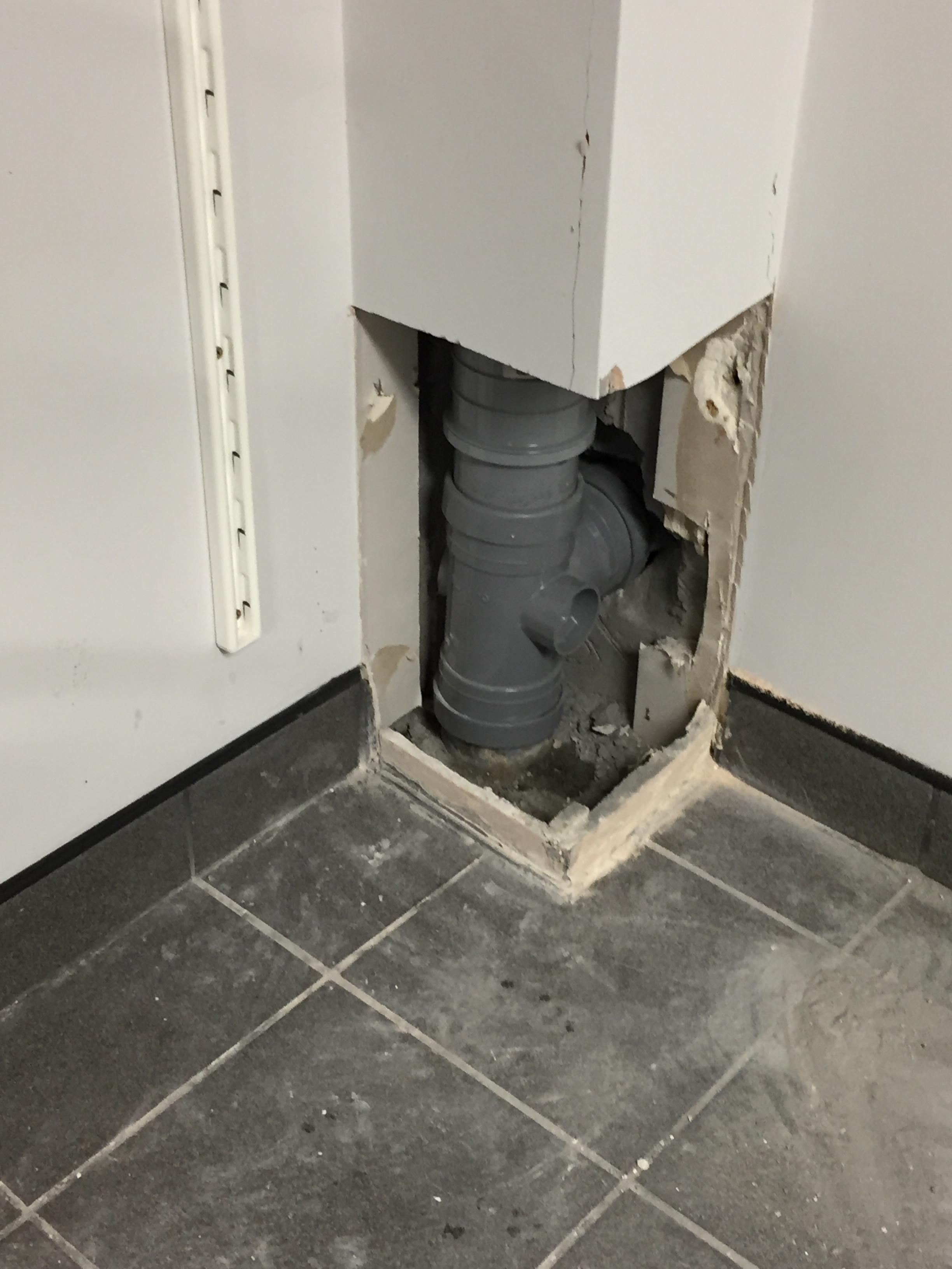

Barney12 Posted February 25, 2017 Author Share Posted February 25, 2017 So here we go. It was the complete pia that I had expected! Before: Existing pipe cut: Finally fitted. You can just make out the slip ring from Wickes. Alas as the biggest core drill I have is 117mm so couldn't do as @Nickfromwales recommended. But I had to chip away even more of th wall to allow me to swing the T into place. 3 Link to comment Share on other sites More sharing options...
Nickfromwales Posted February 25, 2017 Share Posted February 25, 2017 I'd have preferred it if the fittings were black TBH. Can they be easily changed? Nice job Link to comment Share on other sites More sharing options...

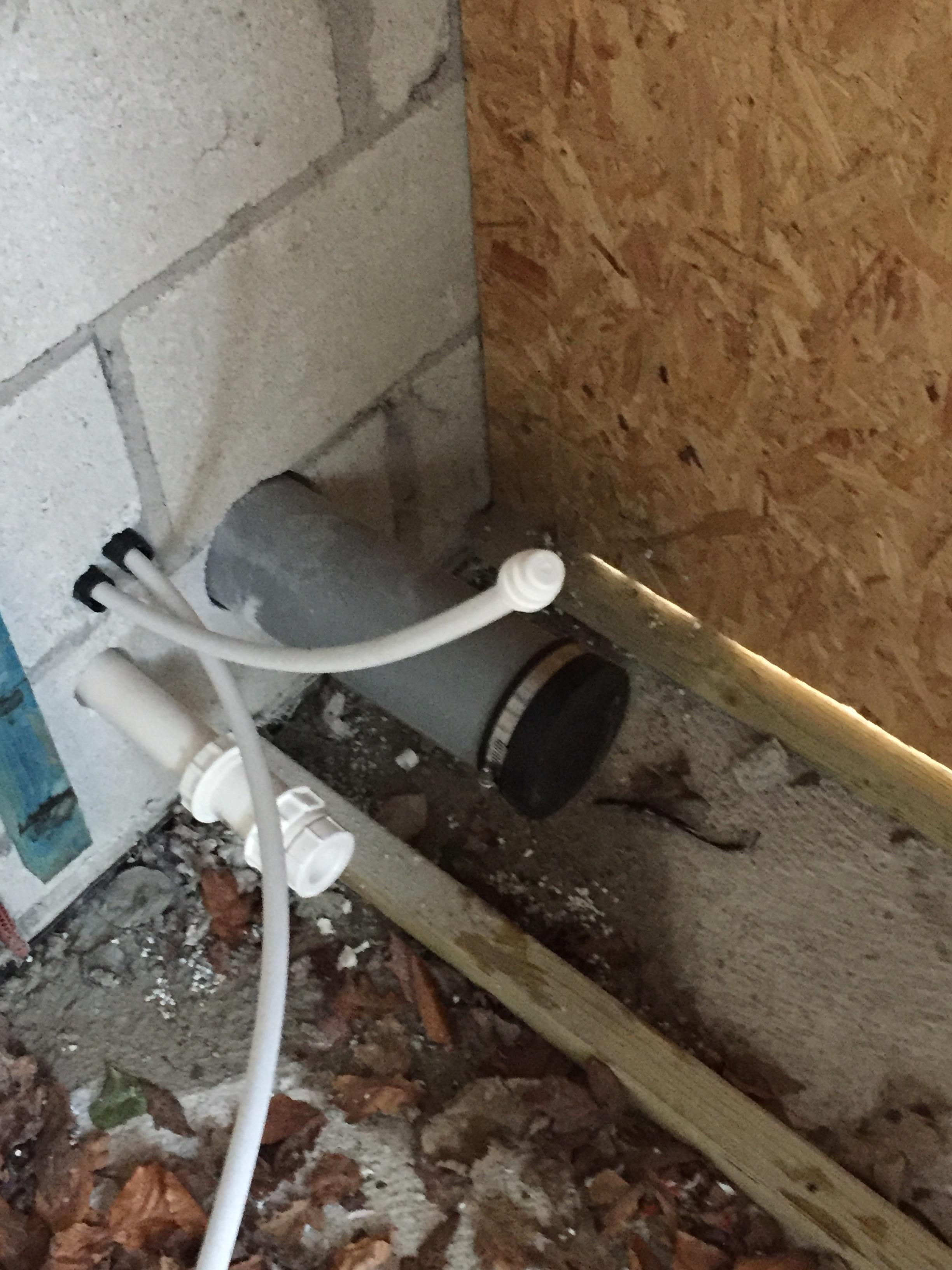

Barney12 Posted February 26, 2017 Author Share Posted February 26, 2017 So that's a productive weekend. All first fix for the outside bog sorted. Pipe runs for the H&C supplies were a right PIA too, I'm now crippled from crawling in the eve space to pick up the feeds!! Thats going to save me a few quid on a portaloo for the various trades. Well it will when I get the bog fitted! Oh and I suppose I had better fit a door too Had to take a trip out to buy a real of 15mm hep pipe. Yes, I've definitely got some but could I find it in the container? Of course not. I expect I'll find it tommrow now 1 Link to comment Share on other sites More sharing options...
