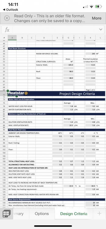

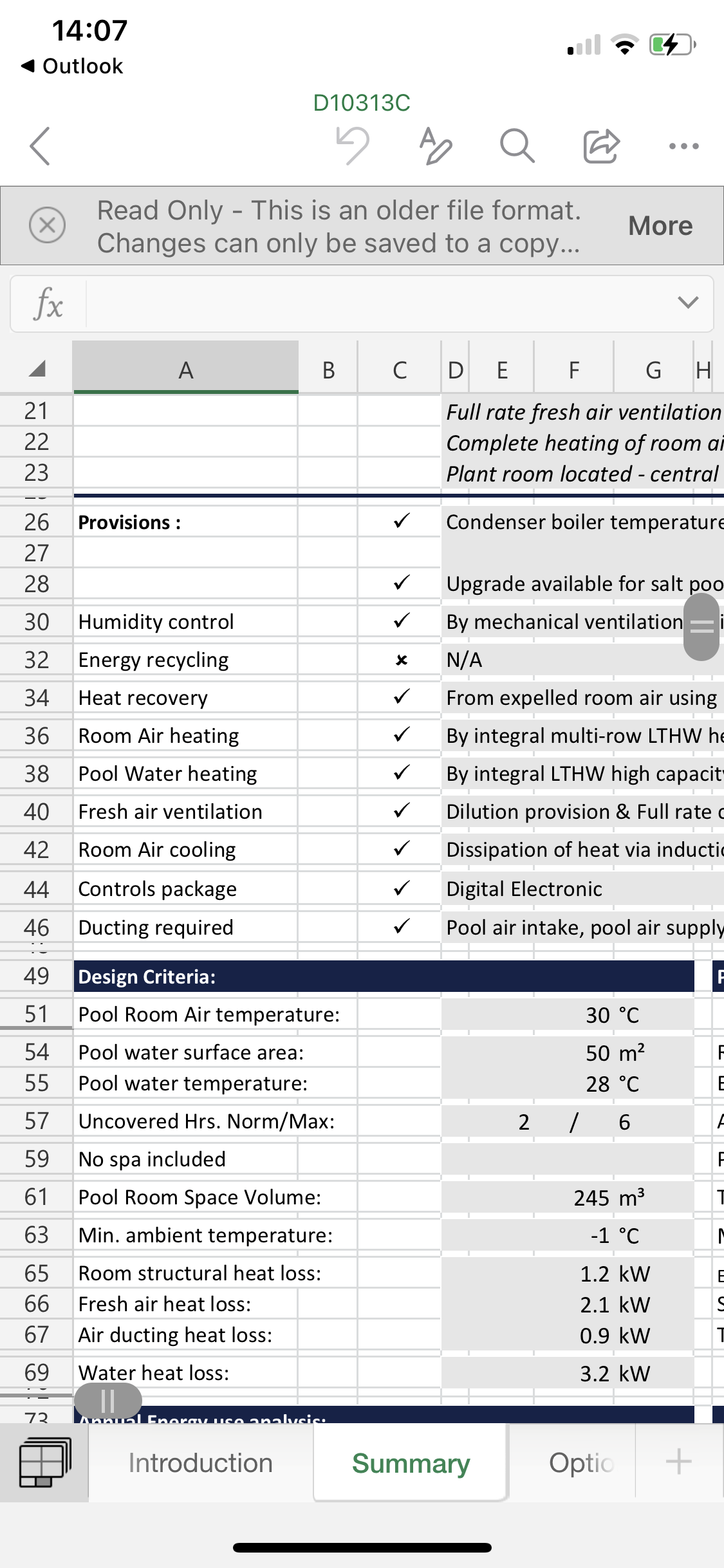

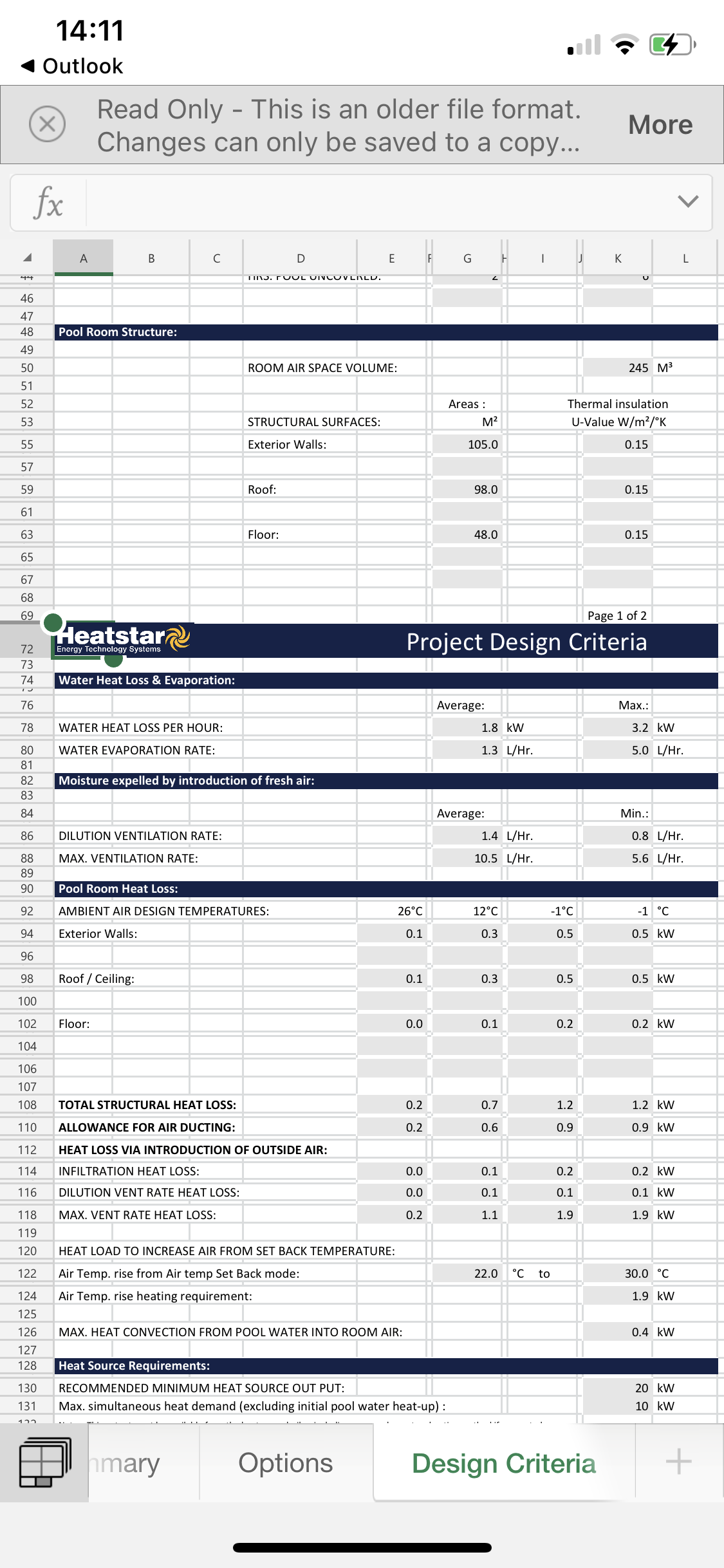

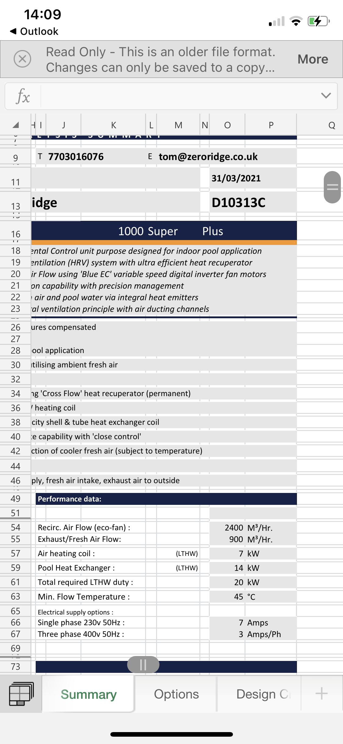

Trw144 Posted April 10, 2021 Author Posted April 10, 2021 (edited) 1 hour ago, AliG said: In terms of heat loss from a pool, when I calculated it, the loss is really the heat loss from the pool room. The losses to the ground are much smaller. Although I do have EPS under and around the pool. The reason pools used to cost a fortune to heat is that they need quite large rooms and people would often put them in rooms not much better than sheds. These are the figures I am working from.... Edited April 10, 2021 by Trw144
AliG Posted April 10, 2021 Posted April 10, 2021 (edited) I have the same spreadsheet still from my original order. They filled it in with some standard numbers and never redid it for the actual numbers for the house. I calculated it myself using the JSHArris heat loss calculator. Looking at the calculation though, it is indeed based the structural heat losses of the room. The way the pool makes a difference is that it requires more ventilation than a normal room which loses energy from the evaporated water. Otherwise it is the same calculation. It looks like yours is in a basement? No windows in the calculation. Looking back at my calculation there was an allowance for the electricity for the dehumidification and filter pump. They would be around £450 (3000kWh each) a year each which seems about right. Actually i tried to work out my electricity consumption a while ago and I had the dehumidifier at just under 3000 and the pump at just over which is almost exactly what is in the original calculation. I think I calculated the pump use from its specs. Edited April 10, 2021 by AliG
Trw144 Posted April 10, 2021 Author Posted April 10, 2021 1 hour ago, AliG said: It looks like yours is in a basement? No windows in the calculation. Yes it is in the basement (on three sides as it is into a bank) although has since moved position in the basement so will have one, possibly two patio sliding doors. Glad to know their figures are somewhere near accurate.
