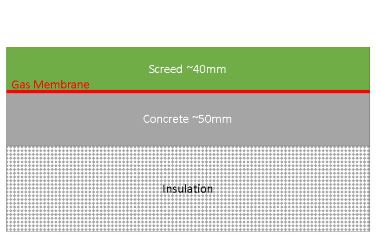

MortarThePoint Posted April 8, 2021 Posted April 8, 2021 We have concrete* that is going to be directly under the screed with UFH in. On the Ground floor, the concrete is 50mm thick* with insulation below and a gas membrane above. Consequently, I can't use staples to hold down the pipes. I think that leaves the conventional options being: Insulated panels: don't want the insulation or bounce possibility Castellated panels: expensive ~£7-10/m2. seem very expensive when you multiply by the m2 needed. It's about 3x the cost of the pipes themselves which doesn't feel right given the restraint is to last about a day before the screed then holds everything in place. Clip rails: ~£1.90/m2. These feel like a good solution, but on the GF I'd have to rely on the self adhesive backing of the clip rail track. We plan to use a thin Anhydrite screed, 40-50 mm of Thermio+. We are not looking for a highly responsive system as using ASHP. Does anyone have experience of how well the clip rail tracks stick down? I could add screws to hold them down on the FF, but not GF. Do the pipes want to pull the clips off and make it a nightmare? I think I saw somewhere that some lay reinforcement mesh and then zip tie the pipes down. It's around £2.30/m2 for A142 mesh and has a good weight (2.2kg/m2) to it which would help hold the pipes down. * Thermobeam

Dudda Posted April 8, 2021 Posted April 8, 2021 I don't quiet understand the floor build up. Is this correct: 50mm Anhydrite screed with UFH Gas / Radon Membrane Insulation Sub floor of some type Why not do what everyone else does and have the following: 50mm Anhydrite screed with UFH Slip membrane (light sheet of plastic to stop the liquid screed seeping down between the gaps in the insulation. Insulation Gas / Radon Membrane Sub floor of some type This way the radon layer is protected by the insulation. If you put the Radon on top of the insulation you'll have pipes, UFH installers walking across it, some type of UFH clips, potentially steel mesh to clip the UFH onto, etc. The Radon layer will get damaged. The other advantage of having the Radon layer below the insulation is you're keeping the insulation dry. If the Radon layer is the main waterproof layer rising damp can lower the thermal performance of the insulation. In terms of installing the radon it shouldn't impact any DPC levels or anything else it's just dressed up the side of the insulation to whatever height you want. The other advantage is Radon is a thick layer that can be difficult to work with and get flat. Having the large insulation sheets flattens it down. You won't be able to do that with a liquid screed and any bulges, folds or creases in the radon layer will lead to thinner Anhydrite screed in areas where cracks will form. This isn't an issue when using a lighter slip membrane.
MortarThePoint Posted April 8, 2021 Author Posted April 8, 2021 2 minutes ago, Dudda said: I don't quiet understand the floor build up. Is this correct: 50mm Anhydrite screed with UFH Gas / Radon Membrane Insulation Sub floor of some type Why not do what everyone else does and have the following: 50mm Anhydrite screed with UFH Slip membrane (light sheet of plastic to stop the liquid screed seeping down between the gaps in the insulation. Insulation Gas / Radon Membrane Sub floor of some type This way the radon layer is protected by the insulation. If you put the Radon on top of the insulation you'll have pipes, UFH installers walking across it, some type of UFH clips, potentially steel mesh to clip the UFH onto, etc. The Radon layer will get damaged. The other advantage of having the Radon layer below the insulation is you're keeping the insulation dry. If the Radon layer is the main waterproof layer rising damp can lower the thermal performance of the insulation. In terms of installing the radon it shouldn't impact any DPC levels or anything else it's just dressed up the side of the insulation to whatever height you want. The other advantage is Radon is a thick layer that can be difficult to work with and get flat. Having the large insulation sheets flattens it down. You won't be able to do that with a liquid screed and any bulges, folds or creases in the radon layer will lead to thinner Anhydrite screed in areas where cracks will form. This isn't an issue when using a lighter slip membrane. The stack up is: Insulation (325mm EPS) Precast Concrete (50mm) Gas Membrane Slip Membrane (if needed) Screed with UHF (~40mm)

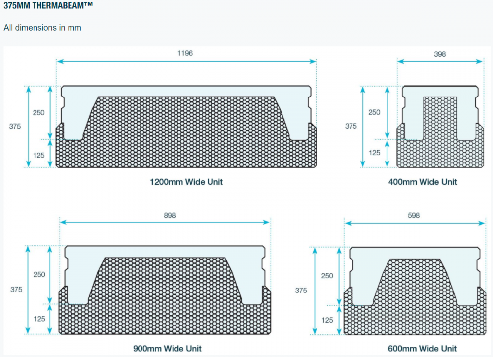

Dudda Posted April 8, 2021 Posted April 8, 2021 12 minutes ago, MortarThePoint said: The stack up is: Insulation (325mm EPS) Precast Concrete (50mm) Gas Membrane Slip Membrane (if needed) Screed with UHF (~40mm) Thanks. I don't understand what the ~50mm of precast concrete is doing. This can't be a structural layer at that thickness. What's under the insulation and what layers are already in place? I still think it would be better if the Gas / Radon layer was below the insulation.
MortarThePoint Posted April 8, 2021 Author Posted April 8, 2021 Just now, Dudda said: Thanks. I don't understand what the ~50mm of precast concrete is doing. This can't be a structural layer at that thickness. What's under the insulation and what layers are already in place? I still think it would be better if the Gas / Radon layer was below the insulation. It is quite a new product that is structural and has beam components, but the reinforced web is 50mm. It and the gas membrane are installed, but nothing on top yet.
Dudda Posted April 8, 2021 Posted April 8, 2021 I understand now. The 375mm insulation isn't 100% insulation but is an insulated beam system and the 50mm concrete is a structural screed that ties it all together. To late but I'd have put the radon below this. In you're case I'd use the clip rail tracks and just stick them to the concrete. I've stuck them to just the slip membrane and they worked fine. When you've all the UFH pipes in place they tend to all click together to form a giant web that doesn't move and the weight (when you've the pipes pressurized and filled with water to test for leaks prior to pouring the screed) ensures they don't lift or move.
MortarThePoint Posted April 8, 2021 Author Posted April 8, 2021 11 minutes ago, Dudda said: In you're case I'd use the clip rail tracks and just stick them to the concrete I can't do that directly as the gas membrane is there but hopefully it will stick well. 1 hour ago, Dudda said: The other advantage is Radon is a thick layer that can be difficult to work with and get flat. Having the large insulation sheets flattens it down. You won't be able to do that with a liquid screed and any bulges, folds or creases in the radon layer will lead to thinner Anhydrite screed in areas where cracks will form. This comment concerned me a bit. Do you think the weight of the tubes will help out?
Dudda Posted April 8, 2021 Posted April 8, 2021 1 minute ago, MortarThePoint said: I can't do that directly as the gas membrane is there but hopefully it will stick well. This comment concerned me a bit. Do you think the weight of the tubes will help out? Sorry I meant to say stick to the radon. They stick very well as it's a smooth flat surface they're sticking too. It just will means you'll have to pay extra care and attention to getting it flat and even. If you've a giant space that's flat its easier but if you've a lot of load bearing internal walls or popup's it makes it more time consuming. Just pay extra care to getting it flat and even and folding it tight into the corners. The weight of the filled UFH pipes will help. 1

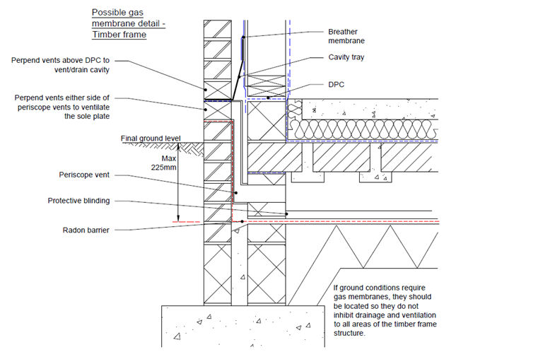

PeterW Posted April 8, 2021 Posted April 8, 2021 1 hour ago, MortarThePoint said: is quite a new product that is structural and has beam components, but the reinforced web is 50mm. It and the gas membrane are installed, but nothing on top yet. your radon layer is in the wrong place. If you have beam / block or beam / EPS in your case, you ventilate the under floor cavity.
