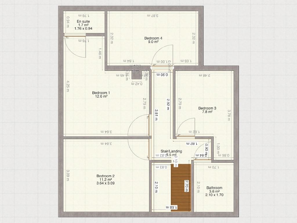

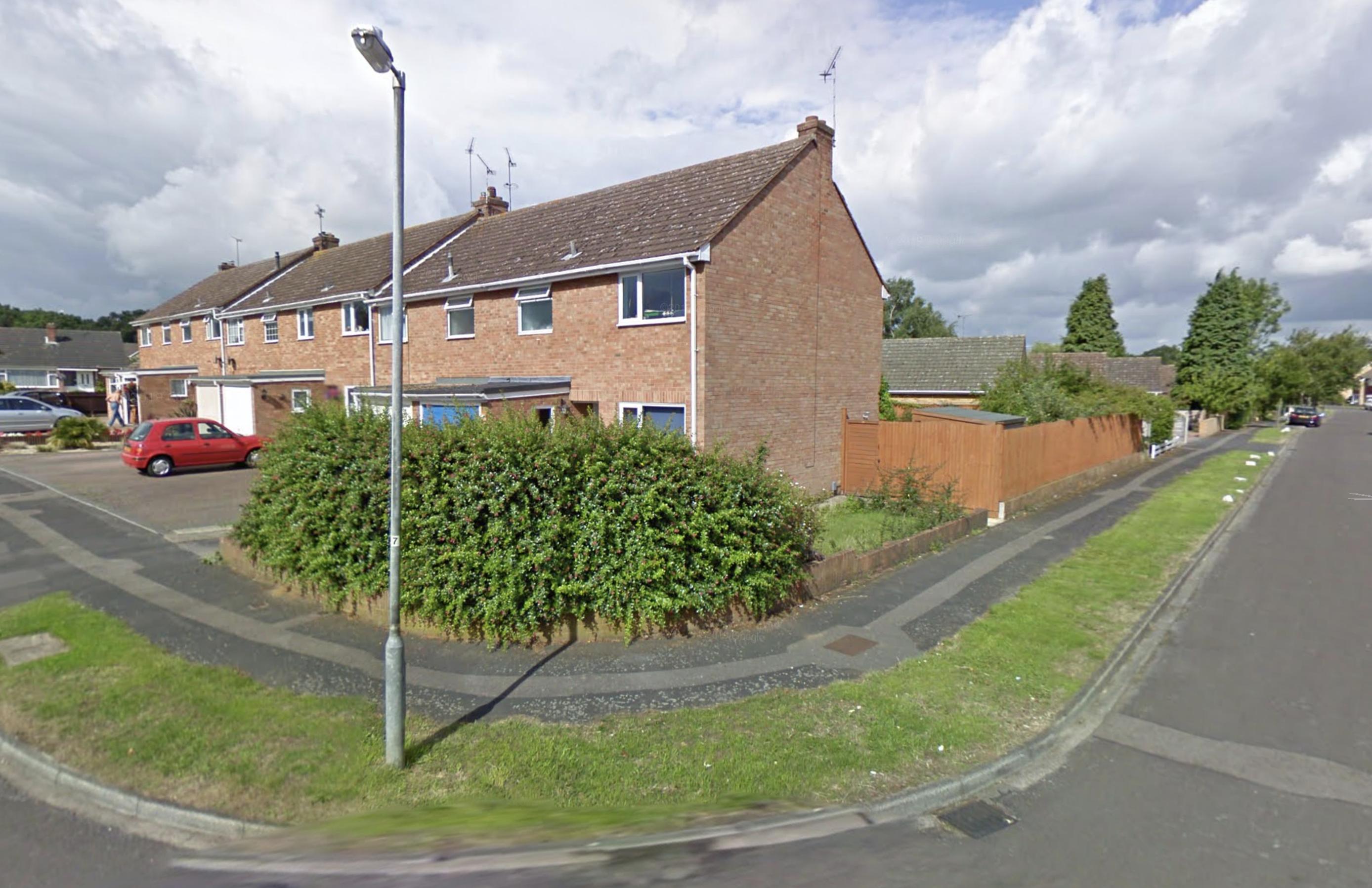

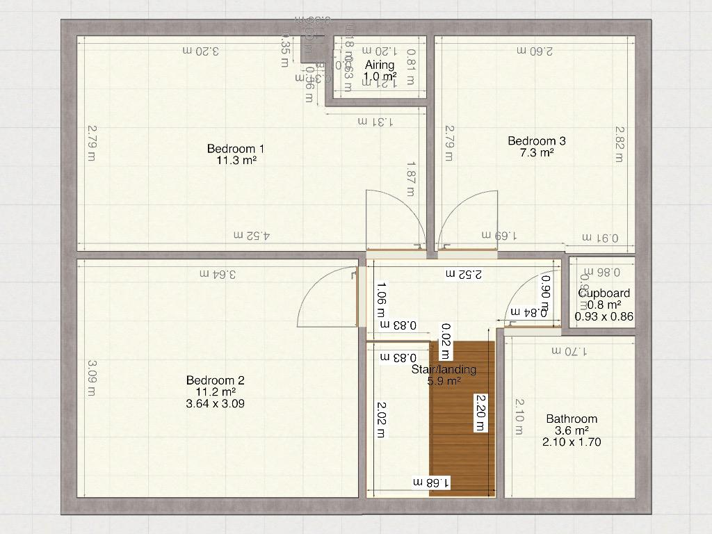

I'm looking for some advice on extending my end-of-terrace house in Hampshire. It's the only one in the terrace of six houses that hasn't been extended, and is on a corner plot with a fairly narrow bit of north-facing land to the side. See plan - it's no 48.
Ideally I would like to add a two-storey extension on the side to allow a larger kitchen and additional living space downstairs, and a fourth bedroom plus an ensuite to the existing main bedroom (bedroom 1 on plan) upstairs, plus a single storey extension along the rear similar to what the neighbouring properties have.

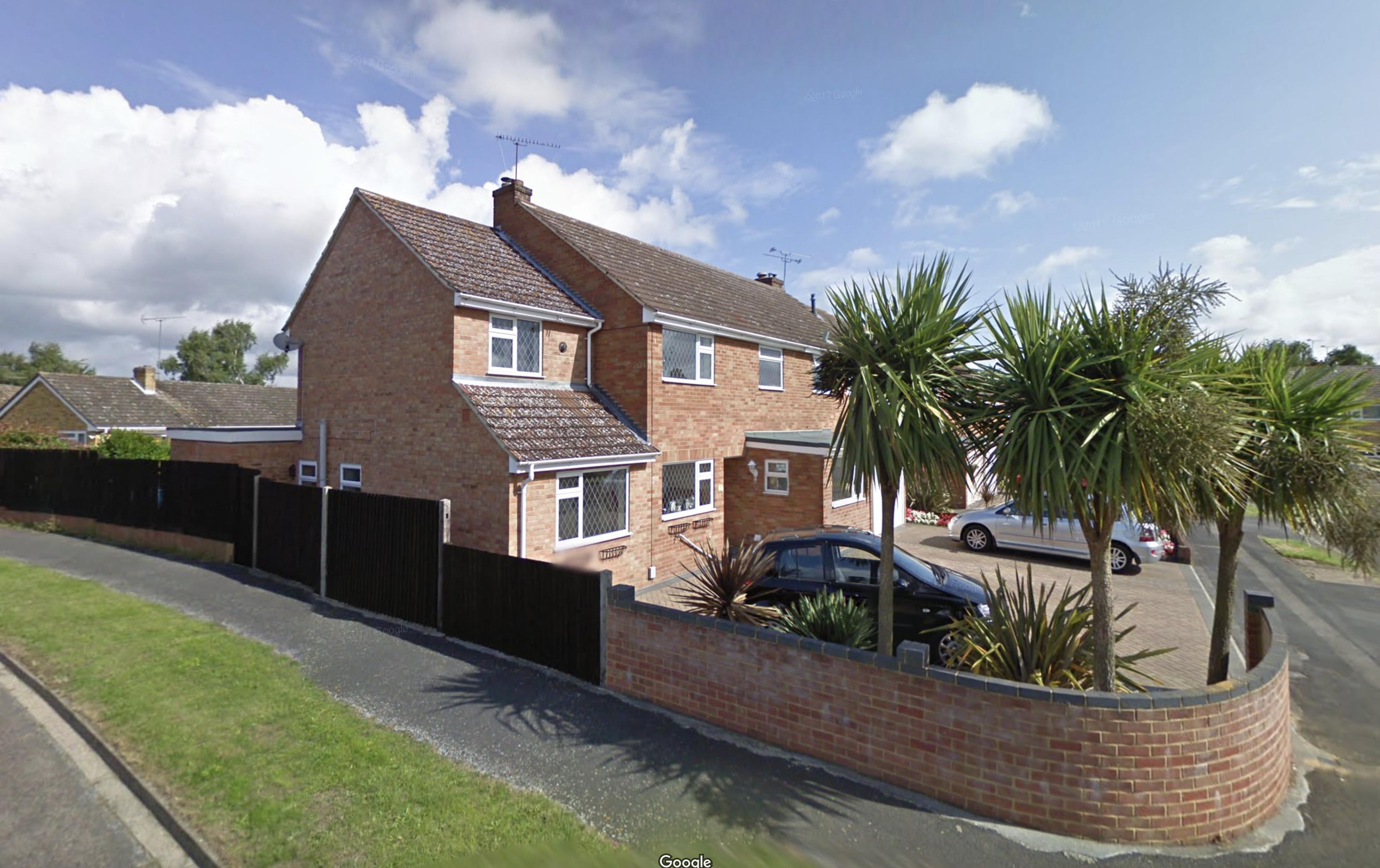

The house at the other end of the terrace was extended to the side and rear a long time ago (planning granted 1984), originally as a self-contained granny annexe which has subsequently been incorporated into the main house. So there is a precedent for a two-storey side extension here. The ground floor has been extended up to the front building line but the upper floor has a setback - see photo attached.
Unfortunately I don't have quite as much space to play with as the house at the other end did. The distance from the external house wall to the inside of the boundary wall is 3.6 metres at the front of the house, and 3.8 metres at the rear. Obviously I would like to use as much of this space as I can but I assume I would not be allowed to build closer than 1 metre to the boundary? That would mean adding a 2.6 metre wide extension which would mean maybe 2.3 metres of usable internal space, assuming the existing external wall is still in place. Assuming I would have to set back the upper story to mirror the house at the other end of the terrace that would be more space lost.
View of current situation:

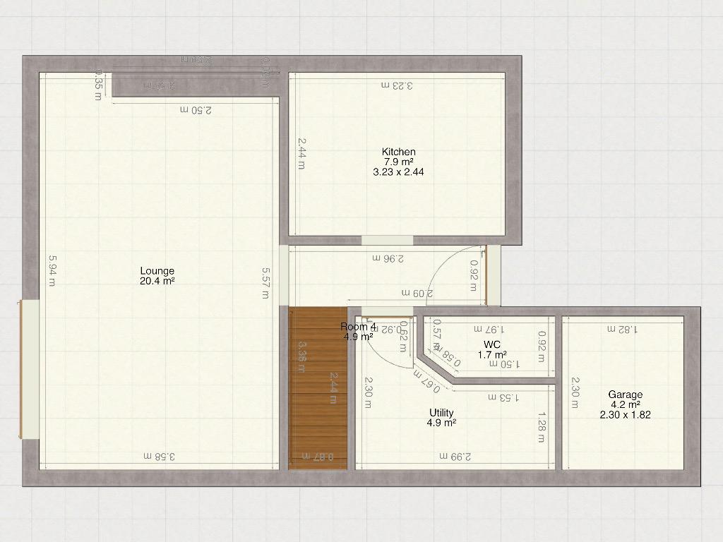

Existing floorplans are attached. North is towards the top left corner of the plans. There's an open fireplace at the north end of the lounge (currently with a woodburner) and the chimney then rises diagonally, which is what the thick part of the wall indicates on the plan.
Apart from any advice on the best way to use the space and what sort of budget I might need, I am looking for thoughts on heating. The house is currently heated solely by electricity (apart from the woodburner), with a combination of storage heaters, electric radiators and electric underfloor heating in the kitchen and bathroom. Heating costs are very high for the size of the house. There is a mains gas supply but it has never been connected and used. I would like to do something greener than gas heating but not if the cost would be astronomical. I gather the RHI scheme could offset some of the upfront costs if I installed a renewable source of heating but I don't know whether this would be feasible with a 1960s house that is not terribly well insulated?
Downstairs:
Upstairs:

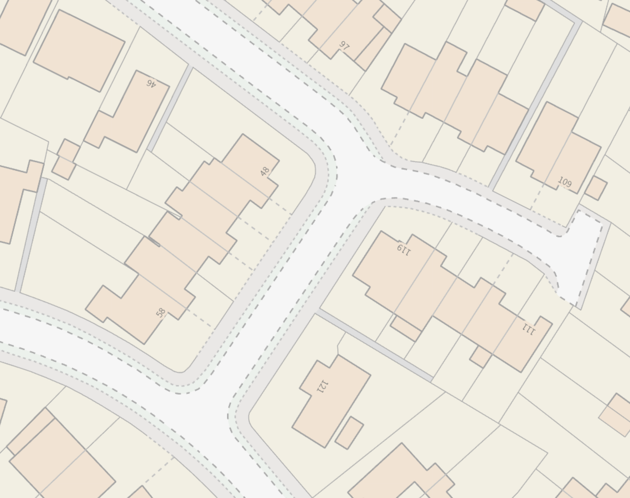

Your issue will be how close to your boundary the planners will accept.  The building line of the adjoining road will be an issue, you will be going in front of that.  On the plus side your tall garden wall already breaches the building line and blocks any visibility so there won't be a visibility issue.
Only by putting a planning application in will you find out for sure.

  • I think you're going to have problems with the layout given where the staircase is - you're going to lose a fair bit of room from one of the bedrooms (probably #1) if you want to add a side extension upstairs and the resulting shape might feel very awkward.
  • It's worth thinking about what you could do on the ground floor only to get what you want - if you put a big kitchen/diner on the side as the extension (which as a single-storey may be able to go closer to the boundary) then you could convert the garage/WC/utility into a big bedroom and most of the existing kitchen space into a ground floor shower room plus a utility room.
  • Maybe also worth looking at the feasibility of a loft conversion - because you'd continue the existing stairs upwards that's likely to be more space-efficient with the existing bedrooms than a side extension. Probably depends on how much headroom you have in the loft - looks like you're ~7m front to back with a 45° roof so with a decent sized dormer on the back that's probably a fairly good option.

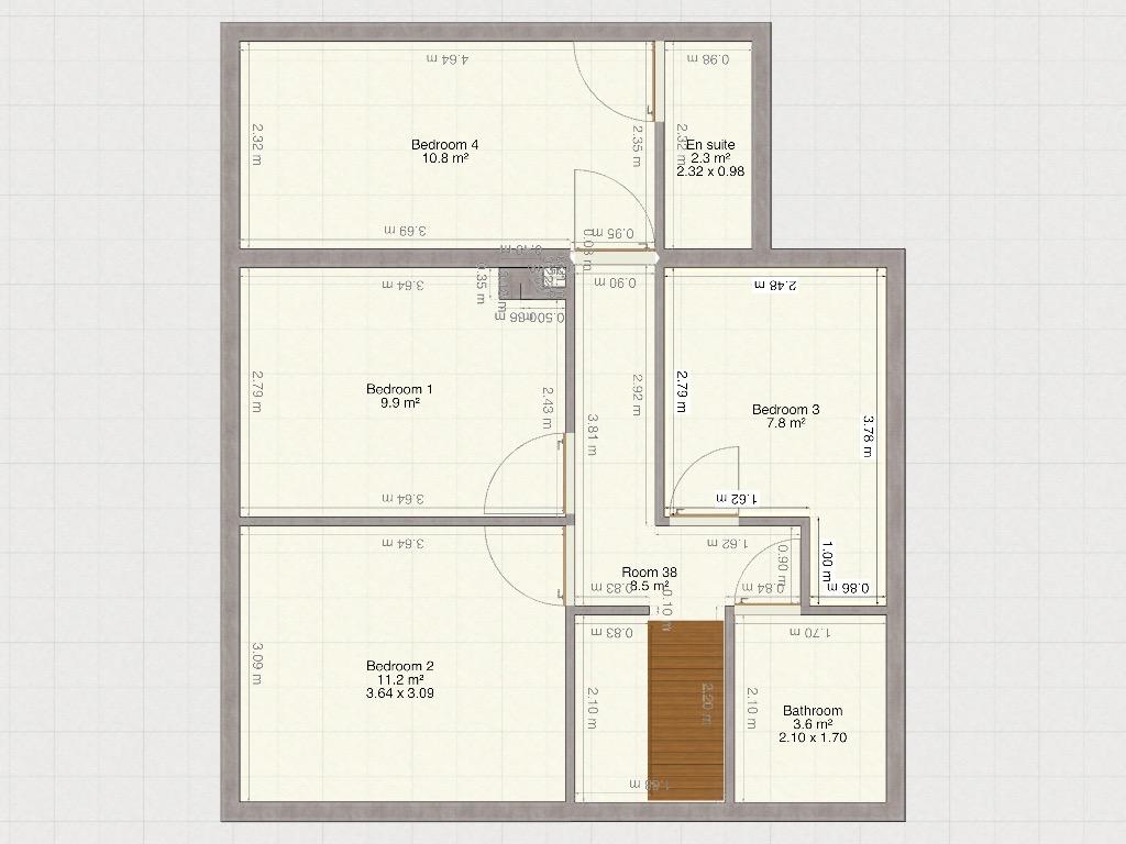

Thanks, that's some useful food for thought. I agree about the upstairs layout. The only access really would be to steal some from the existing bedroom 1 and create a new access through where the airing cupboard is.
 I have had a look at the floor plans of the house at the other end and they did something similar to this, creating a new master bedroom in the whole extension upstairs - quick sketch plan but squashed in to what I could potentially fit in the space:
However their new side extension was wider (2.8m internal) whereas I wouldn't have that much width - 2.3 metres or so is no good for a double bedroom. So that wouldn't work!
Something like this could be an option - creating a single bedroom at the front, which would still be bigger than the existing third bedroom, with the remainder for an ensuite shower room in the existing main bedroom. Again just a quick sketch so sizes not to be taken too literally. This would require taking out more of the existing external wall of course.
I'd still need to find space for a hot water cylinder too if I got rid of the existing airing cupboard. Basically I think the problem is there might not be quite enough width to make the two storey idea worthwhile. Plus of course adding a fourth bedroom might not be possible if the local council want one parking space per bedroom, as I wouldn't get four cars out there even if I paved over every square inch! And of course the integral garage, as with most 1960s houses, is no good for a modern car so we have already converted most of that, leaving just enough space for bike storage etc.
@ProDave the extension at the other end of the terrace also comes forward of the building line, although as the road curves it is maybe less obvious than it would be at my end. I'm hoping that with the precedent set there they would have less grounds to complain, although I suppose they could argue that things have changed since 1984 when that extension was granted!
I would tend to agree with you - you're in a big enough plot to make it possible, but not big enough to make it actually worthwhile.

Yes, this is another option. Any idea of the ballpark costs for a loft to bedroom conversion incorporating a bathroom? The internal dimensions of the entire footprint are about 7m x 6m. A bit of trawling the internet suggests that a dormer conversion of that size could be done for around £40k, does that sound plausible?
I would still want more space downstairs but that could feasibly be done with a single storey extension to the rear, perhaps extending out to the side. Doing both might well be too expensive though.
This would of course also mean that if the planners insisted on additional parking spaces one could be fitted down the side.
