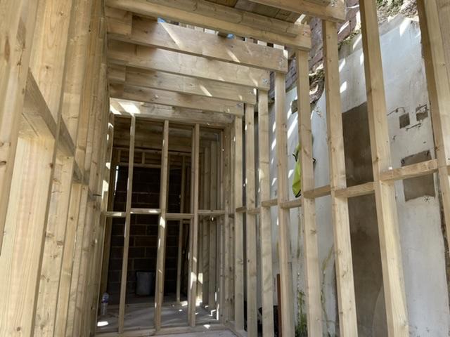

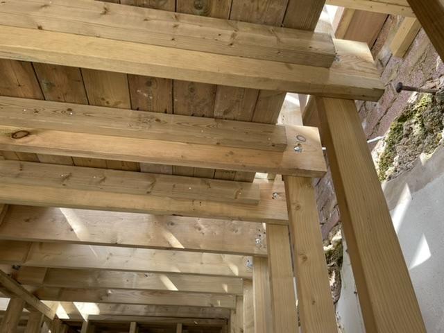

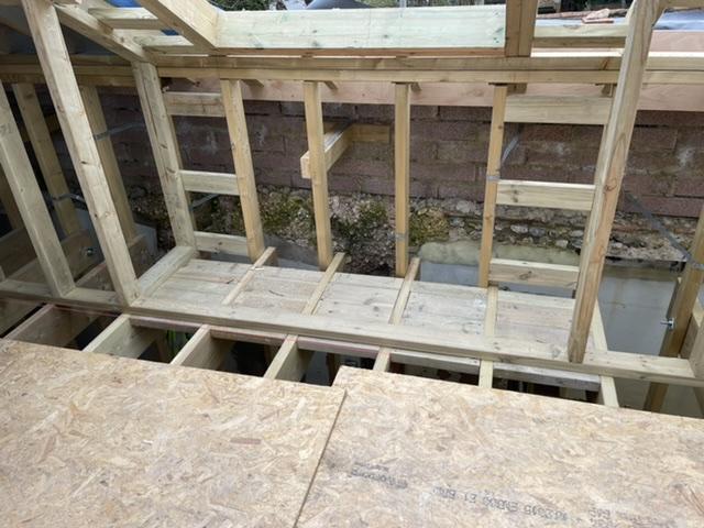

ashthekid Posted April 7, 2021 Author Share Posted April 7, 2021 I am definitely planning to tile it. Do you think this will work in reinforcing the floor joists? Link to comment Share on other sites More sharing options...
PeterW Posted April 7, 2021 Share Posted April 7, 2021 Will what work ..? Not quite sure what the photo is showing ..?? Can I check that those floor joists aren’t just bolted to a single 4x2 with one bolt each ..??! What’s below that floor ..?? And what stops the 4x2 buckling ..??? Link to comment Share on other sites More sharing options...
ashthekid Posted April 7, 2021 Author Share Posted April 7, 2021 I’m referring to the extra supports between the joists. The joists are bolted with a single bolt through 50x100mm Grade C16 load bearing stud walls as per Structural Engineer specification. The bath itself is directly above a pantry roughly the same size as the bathroom above. In your honest opinion does that sound about right? Link to comment Share on other sites More sharing options...

PeterTweeter Posted April 12, 2021 Share Posted April 12, 2021 Well, I don't think much of your SE - IMHO. Those joists are pretty meaty, so there's a lot going on out of shot. This is a scenario seen with old school ballon framing, in which studs rose from sole plate to roof plate. For intermediate joists, a bearing support is housed into the studs to take the floor load. No way should those joists be relying on a single bolt into a stud that is not braced. Whilst not up to speed on bolting schedules - my inner engineer would use a pair of bolts spaced thirds across the stud & 50mm from top/bottom face. Those infill pieces look to be lumps of joist toe-nailed into the principal joists. All these will do is brace the joists & not add any dead/live load capability. To remedy your dilemma, I would rip them out & turn them vertical & attach with joist hangers. As to better support of the joists, if you are able, look to install a bearer below them & use something like simpson structural screws to attach to the studs. Then reinforce the studs with noggins between screwed to this bearer. As a young engineer, I was counselled by our structual tutor "If it looks right, it probably is right". In your case, you need to see that those joists are well supported; the studs braced & this extra load supported. I know, "much better informed - still none the wiser!" Hope this helps. Link to comment Share on other sites More sharing options...
PeterW Posted April 12, 2021 Share Posted April 12, 2021 On 07/04/2021 at 23:51, ashthekid said: I’m referring to the extra supports between the joists. The joists are bolted with a single bolt through 50x100mm Grade C16 load bearing stud walls as per Structural Engineer specification. The bath itself is directly above a pantry roughly the same size as the bathroom above. In your honest opinion does that sound about right? So nortmally there would be a top plate on that studwork and the build off it. You’ve got lots in sheer, and nothing stopping twisting or spreading the loads. Fairly crap design IMHO and not one I would be using. Link to comment Share on other sites More sharing options...
markc Posted April 12, 2021 Share Posted April 12, 2021 @ashthekid can you show us what is below here. I assumed the joists were supported from below and we are looking at Cantilevered ends (continuing over a small corridor or similar) Reading other replies they are thinking the joists are supported by the 4x2`s Studs. Link to comment Share on other sites More sharing options...

PeterTweeter Posted April 12, 2021 Share Posted April 12, 2021 If this is a cantileverd structure then the bolts would be redundant surely - nails would be sufficient. The OP needs to better describe the stucture. 1 Link to comment Share on other sites More sharing options...

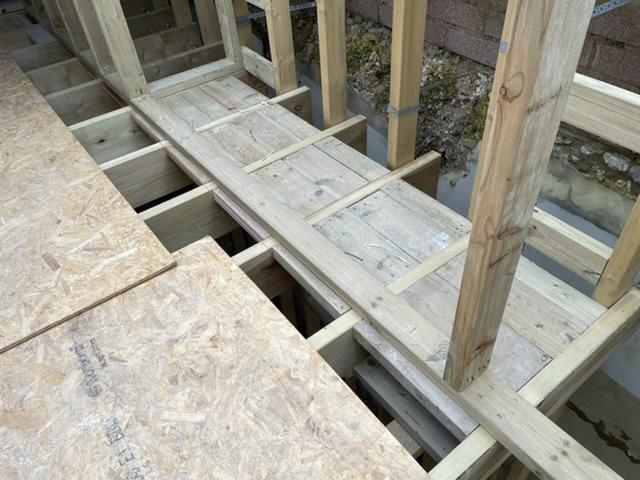

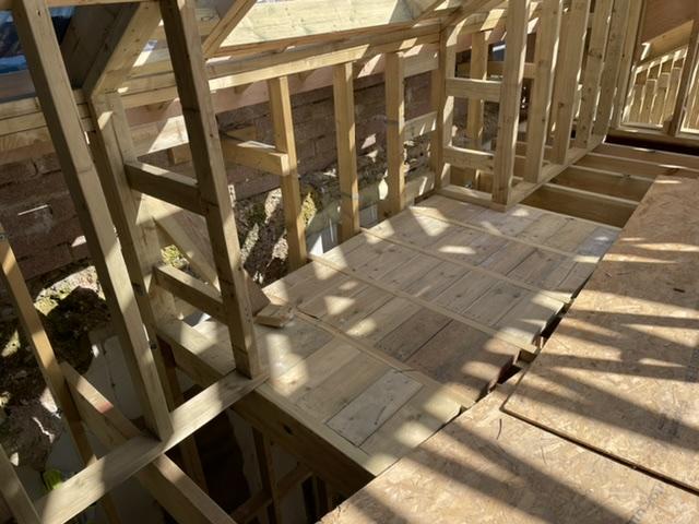

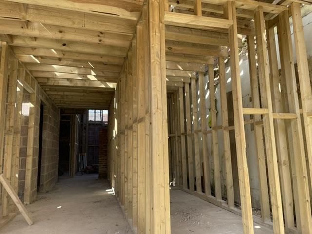

ashthekid Posted April 13, 2021 Author Share Posted April 13, 2021 Here are some photos from today, hopefully it’ll answer any questions. It’s over a pantry room with another load bearing stud wall approx 1.5-2m over from the exterior stud wall so yes a kind of corridor if you like. I’m told the single bolt will have additional nails/screws going in once all carpentry is installed. the extra support between the joists is nailed in multiple times and then supported again underneath again as you can see in the photo. There will also be additional stud wall uprights where the bath is going in. Link to comment Share on other sites More sharing options...
ashthekid Posted April 15, 2021 Author Share Posted April 15, 2021 @markc @PeterW @PeterTweeter Any thoughts on my latest photos showing what’s underneath and where the next load bearing stud wall is located for the joists in question? Link to comment Share on other sites More sharing options...
PeterW Posted April 15, 2021 Share Posted April 15, 2021 Right so it is cantilevered over the wall ..!! Less concerned now ! Link to comment Share on other sites More sharing options...
ashthekid Posted April 15, 2021 Author Share Posted April 15, 2021 Phew! You had me worried. Link to comment Share on other sites More sharing options...
markc Posted April 16, 2021 Share Posted April 16, 2021 10 hours ago, ashthekid said: @markc @PeterW @PeterTweeter Any thoughts on my latest photos showing what’s underneath and where the next load bearing stud wall is located for the joists in question? All good - as i suspected. Single bolt is an odd detail but ive seen it loads of times in heavy Glulam structures to prevent tortional loads in the walls/ends of joists/beams. - By design the bolts should be only just nipped up and not tight but that doesnt really matter Link to comment Share on other sites More sharing options...

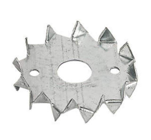

ashthekid Posted April 16, 2021 Author Share Posted April 16, 2021 The bolts do that the teeth plates for extra grip. Link to comment Share on other sites More sharing options...
markc Posted April 16, 2021 Share Posted April 16, 2021 11 minutes ago, ashthekid said: The bolts do that the teeth plates for extra grip. What teeth plates? Link to comment Share on other sites More sharing options...
ashthekid Posted April 16, 2021 Author Share Posted April 16, 2021 Link to comment Share on other sites More sharing options...
PeterTweeter Posted April 16, 2021 Share Posted April 16, 2021 At least these strengthen the single bolt. From the underside, I can see the 2x's are forming a support platform - not very elegant but ok. BTW are you paying your chippies/SE by the cube of timber used? FTW I would still look to further reinforcing the O/B ends of the joists. Link to comment Share on other sites More sharing options...
