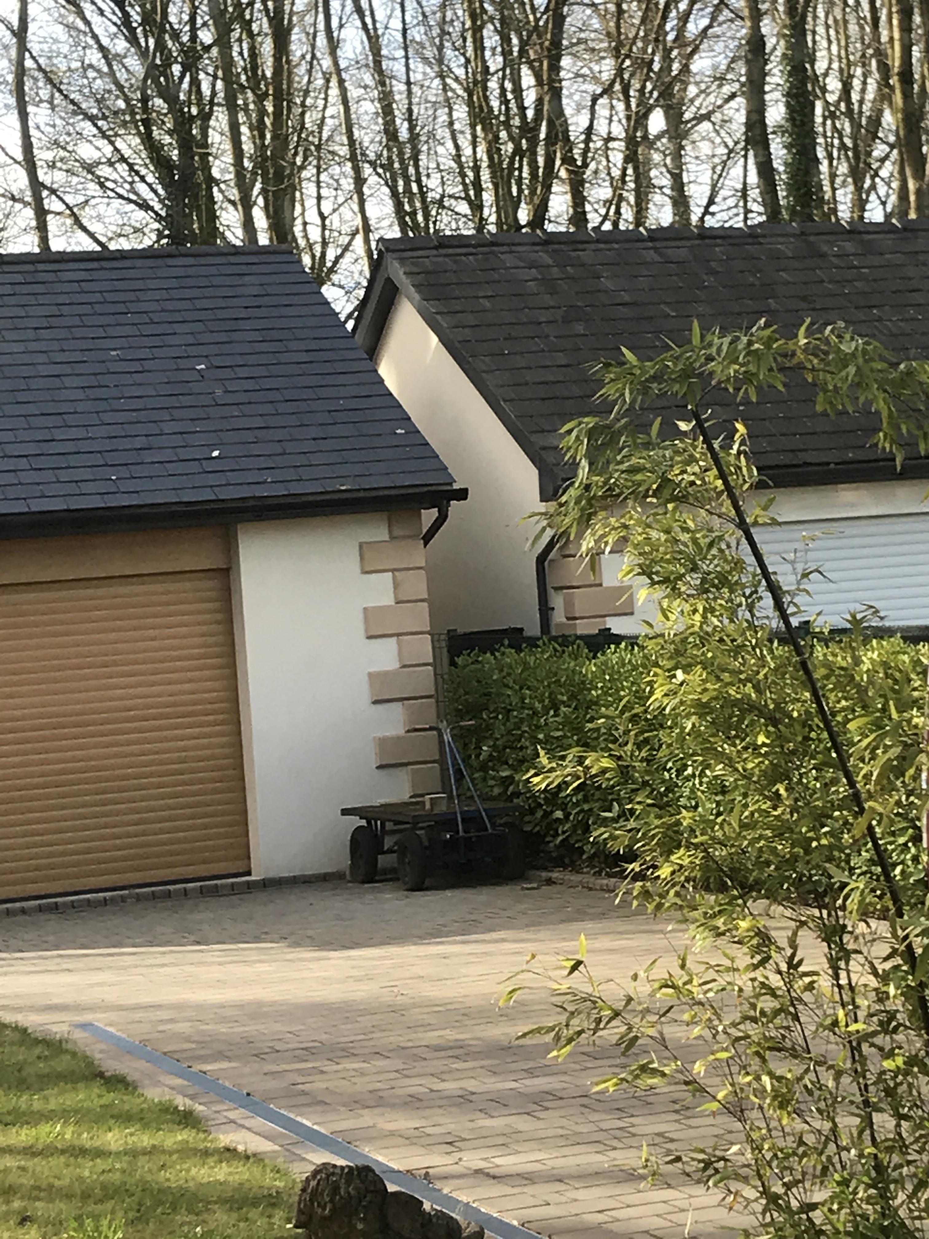

nod Posted March 27, 2021 Posted March 27, 2021 Four years ago we were given a price of £1.20 per slate CASH With a 6 weeks wait We finished up hiring a bumper hoist and my wife and my self skated the roof and two garages ourselves 1
Big Jimbo Posted March 27, 2021 Posted March 27, 2021 3 hours ago, nod said: Four years ago we were given a price of £1.20 per slate CASH With a 6 weeks wait We finished up hiring a bumper hoist and my wife and my self skated the roof and two garages ourselves Looking decent Nod. Me and the Mrs, bumper hoist, done the same a few times. 1
nod Posted March 27, 2021 Posted March 27, 2021 7 minutes ago, Big Jimbo said: Looking decent Nod. Me and the Mrs, bumper hoist, done the same a few times. Thanks
