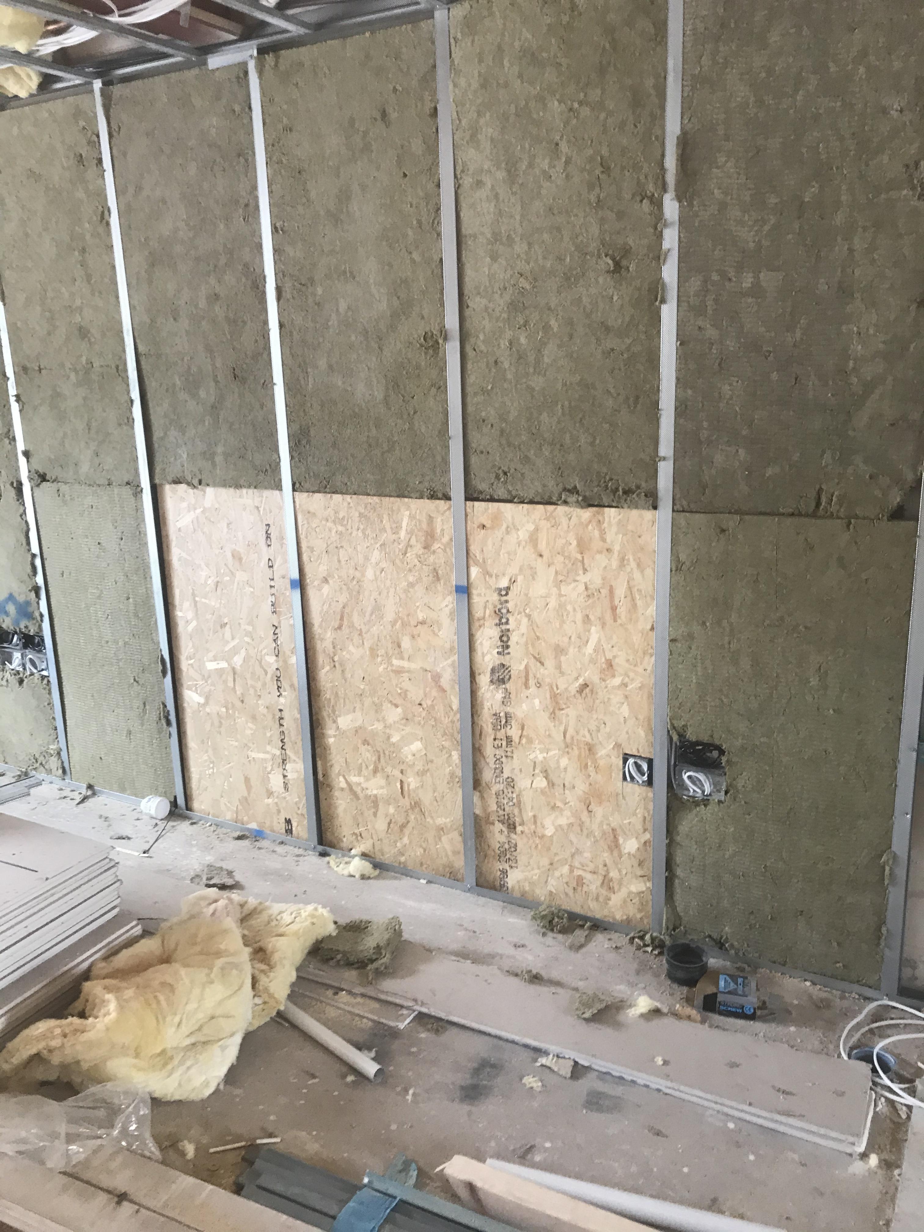

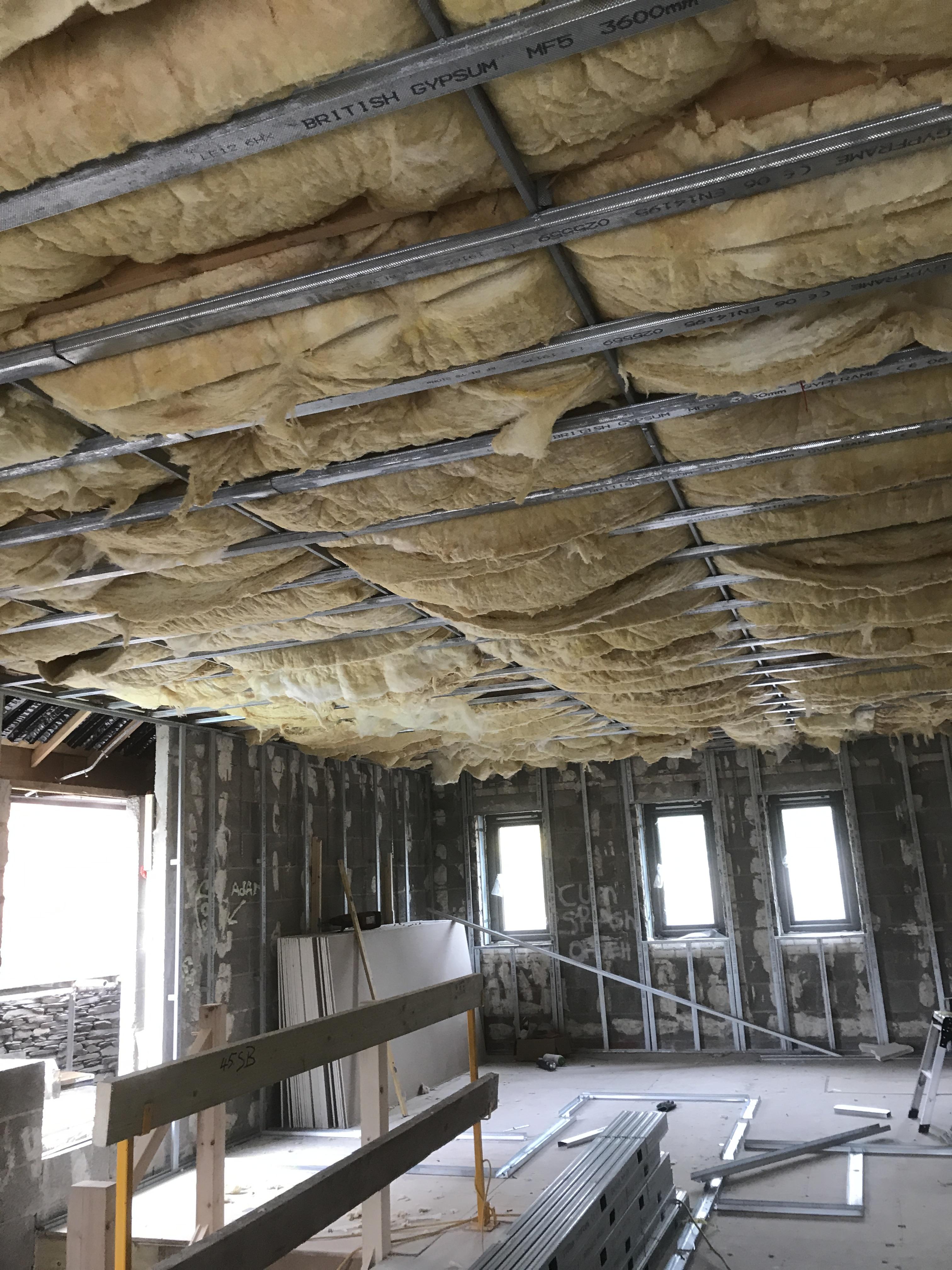

I do a lot of soundproofing in my business You would be wasting your money doing any remedial work As already stated much of the sound will pass via the floor joists and both sets of stairs will be fixed directly to the block work
pictured is a building conversion we did from commercial to residential Single skin block on party walls
These homes had to pass a stringent sound test

The picture is of housing association property to be rented
They go to extraordinary lengths for fire and sound protection
Whilst homes for sale are pretty poor
