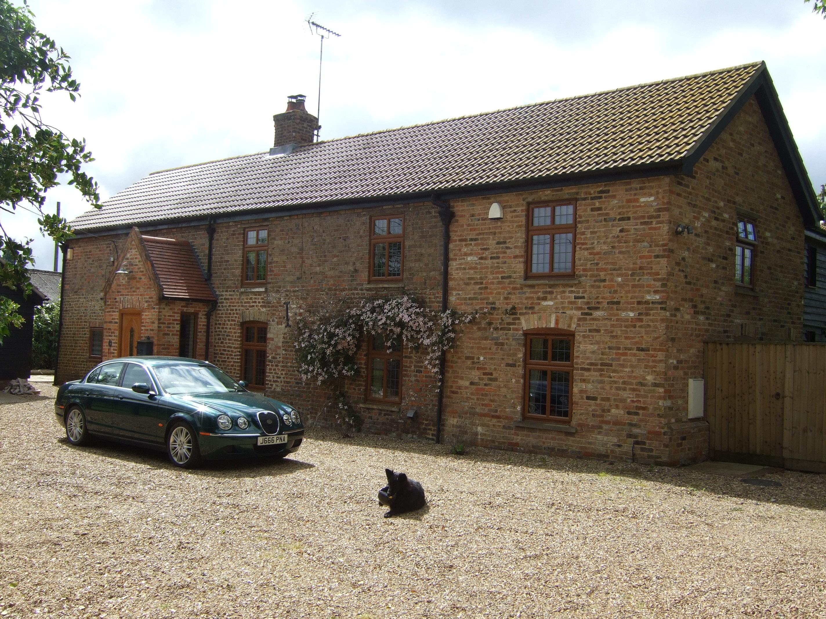

gdal Posted March 25, 2021 Share Posted March 25, 2021 We have just bought a Grade 2 listed stone cottage. Two storeys, tiled roof. Needs a complete renovation - new windows, systems, internal replaster, new bathrooms, kitchen. the works. We will dig out and insulate the existing solid ground floor, using limecrete. The walls are 400-500mm thick limestone. Current heating is an old gas combi fed by a cluster of propane bottles. No mains gas, no room for LPG tank, no room for GSHP. We do have room for an oil tank. The house is in Oxfordshire, elevation 95m, reasonably sheltered. Internal floor area about 150 sq metres. We will install slimline double glazed softwood windows, and insulate the cold loft as well as we can. We will not insulate the walls. I'd like to put UF heating on the ground floor, radiators upstairs, towel rails in the 2 bathrooms. There is a central chimney/inglenook fireplace and we will have a 8-10kw wood burner. I dislike the concept of oil heating, but I really don't want to spend all of our money and be cold. Is an ASHP worth considering? Or shall I go straight for oil. Cheaper, easier, hotter..... Link to comment Share on other sites More sharing options...

Balou Posted March 26, 2021 Share Posted March 26, 2021 GDAL, if its of any use, we live in a house the majority of which was built in 1760's, so thick solid walls, no wall insulation, no under floor insulation, 2 large inglenook fireplaces with wood stoves, about 3300ft2 in size . Luckily, its not listed. 10 years ago we carried out a fairly big renovation, so some of the older part has minimal insulation, new parts were insulated to the standard of the time, loft has lots of insulation, double glazing fitted etc..At the time we also fitted solar panels to the rear south facing roof and for heat/hot water we have been using a Daikin 16KW ASHP. The Daikin has been working fine, especially if its just left ticking over and particularly if youre going to use a woodstove as well. All our heating/hot water/cooking is electric (except the woodstove which is handy when the village has its powercuts) for which we are currently paying around £800 per annum. Hope thats of use. Link to comment Share on other sites More sharing options...

Balou Posted June 24, 2021 Share Posted June 24, 2021 On 04/04/2021 at 22:29, gdal said: Thank you Balfour, interesting. Do you use radiators, or underfloor heating? Hi gdal, sorry only just seen this. Upstairs is all rads, downstairs is a mix of rads and underfloor heating (in the new part). The rads get warm enouth to cope, although in the winter it is boosted by the woodburner. Link to comment Share on other sites More sharing options...
