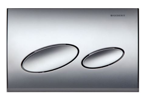

JanetE Posted February 20, 2017 Author Posted February 20, 2017 @Bitpipe well our flush plates are the standard cheapies which fit over the top so shouldn't be a problem for us! 1
Onoff Posted February 20, 2017 Posted February 20, 2017 .....didn't realise you could get a "flush" flush plate"! This is the one I have bought for my UP200 cistern!

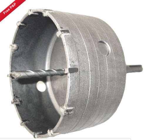

Onoff Posted February 26, 2017 Posted February 26, 2017 On 17/02/2017 at 08:42, PeterStarck said: I used 12mm Hardiebacker board but it's tough stuff and I got through a few holecutters! What did you use, just normal Starrett type ones? Guess my Aquapanel is similar to Hardiebacker.
Gone West Posted February 26, 2017 Posted February 26, 2017 8 hours ago, Onoff said: What did you use, just normal Starrett type ones? Guess my Aquapanel is similar to Hardiebacker. Yup, just bog standard bi-metal hole cutters from Screwfix. I've not seen Aquapanel but Hardiebacker is pretty dense stuff. They say you can score and snap it but I didn't have much luck. I ended up cutting it with a sacrificial TCT blade in the circular saw.
Nickfromwales Posted February 26, 2017 Posted February 26, 2017 1 hour ago, PeterStarck said: I ended up cutting it with a sacrificial TCT blade in the circular saw. Pretty much what you have to do. Aquapanel is like cement board, gritty and reinforced with fibre meshing layers, whereas Hardi is more like Asbestos ( replaced by the likes of Ellis board nowadays ) in looks and consistency. I prefer to stick to one discipline on site so I usually just beef up the carpentry and use 12.5mm MR ( green ) PB. Haven't lost a patient yet.
PeterW Posted February 26, 2017 Posted February 26, 2017 35 minutes ago, Nickfromwales said: Pretty much what you have to do. Aquapanel is like cement board, gritty and reinforced with fibre meshing layers, whereas Hardi is more like Asbestos ( replaced by the likes of Ellis board nowadays ) in looks and consistency. I prefer to stick to one discipline on site so I usually just beef up the carpentry and use 12.5mm MR ( green ) PB. Haven't lost a patient yet. I've been promised a sample of this stuff Powerpanel H2O but unless it comes with a hefty discount I will go with normal fermacell and tank the ar$e out of it with this stuff Aqua Seal I looked at the Fermacell tanking kits but needed to sell a kidney....
Nickfromwales Posted February 26, 2017 Posted February 26, 2017 Same with Roman and Impey, but the only way to get a warranty with their products
Onoff Posted February 26, 2017 Posted February 26, 2017 Aquapanel is Knauf's version of cement board. Can be fully immersed apparently. Was mulling whether my TCT core cutters like these would work. Just to see if they would more than anything.....
Nickfromwales Posted February 26, 2017 Posted February 26, 2017 Loads of revs and no hammer and it should go through. Its TCT at the end of the day.
