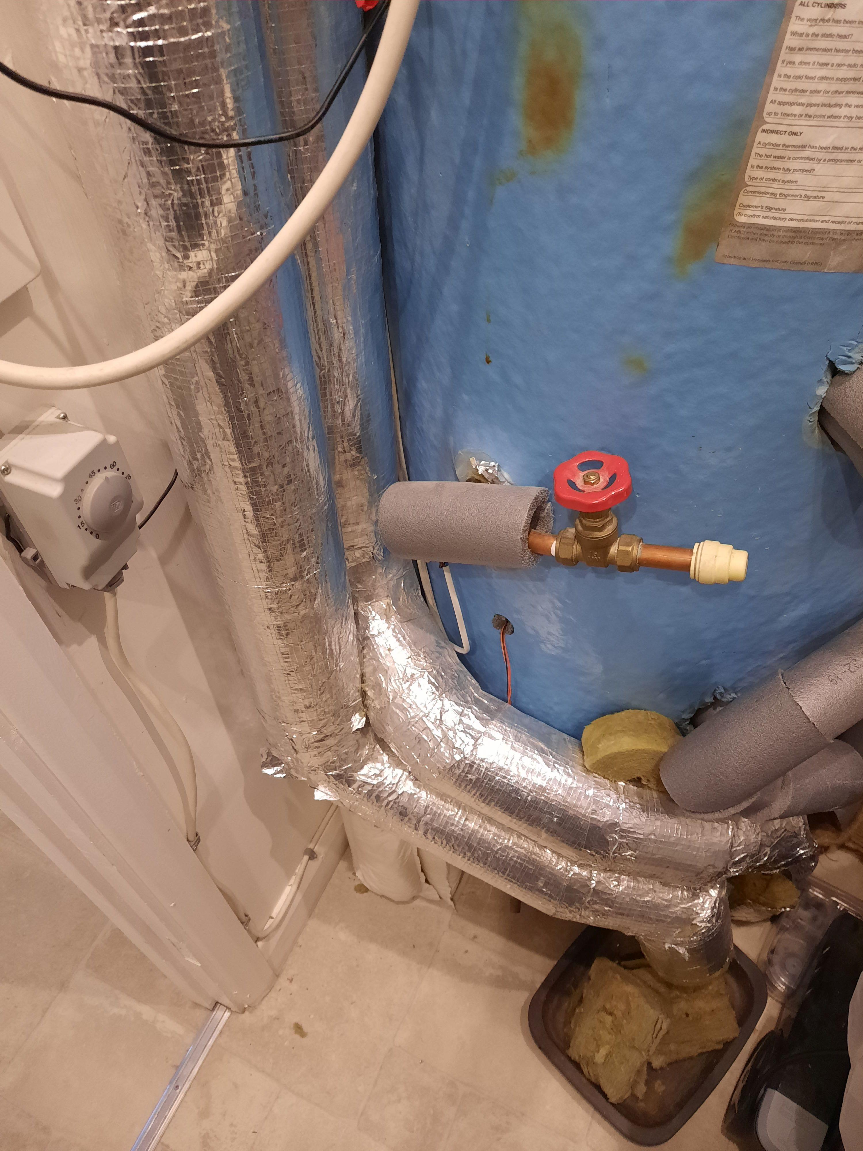

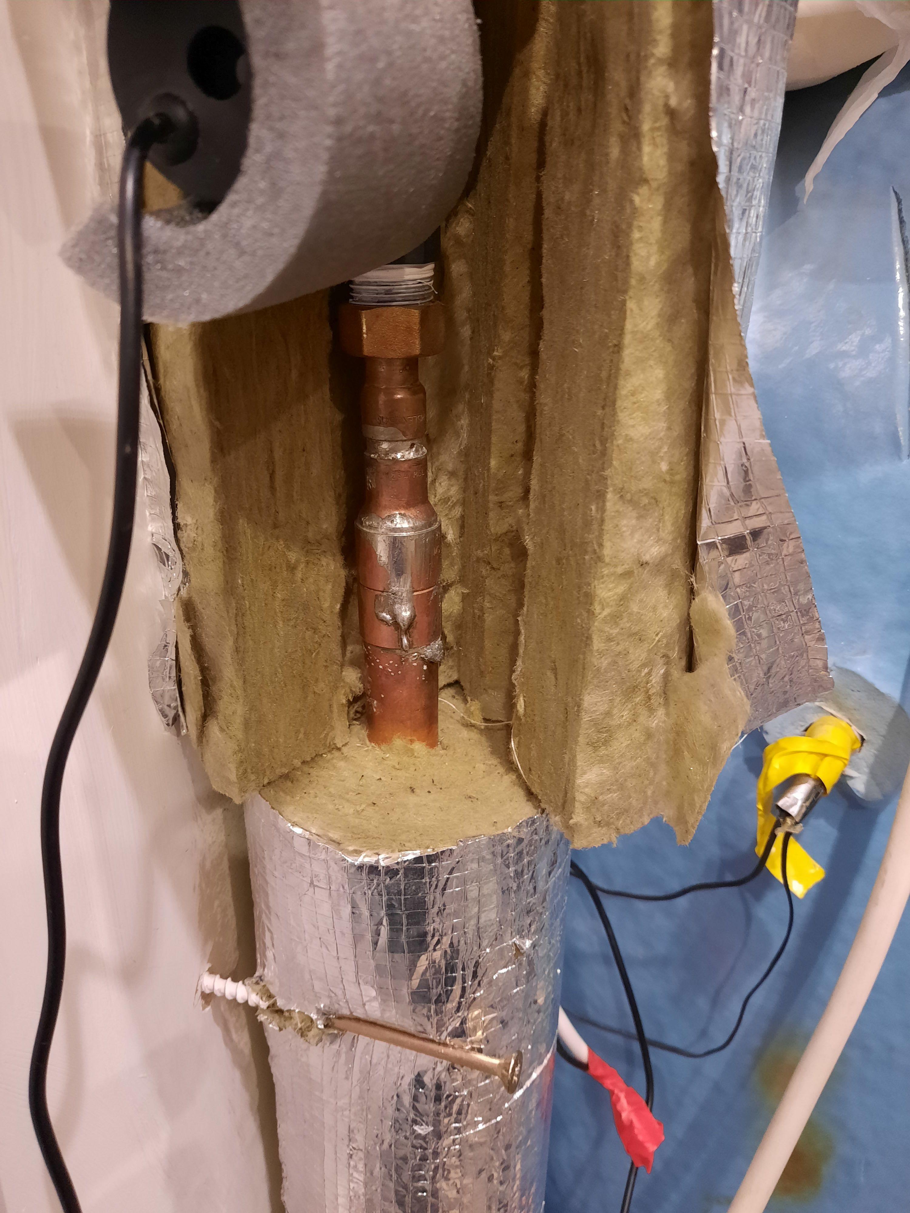

Marvin Posted April 28, 2021 Share Posted April 28, 2021 5 minutes ago, Bruno said: On the inside I was already considering to insulate all pipes. I used in the past (previous plumbing from the wood burner) a kind of cardboard "pipe" filled with rock wool (sorry not sure if this is the correct term) around the pipes. That works very well, as I tested with a thermal camera before and after and the temperature around the pipes was greatly reduced. I'll post a picture later once I get to my archive It's on the outside that I'm a bit lost, I have no idea what to use and how, in order to insulate and also to resist the weather. Will do for sure. Thank you Hi Bruno. Yes Rockwool really good. The thicker the wall the better especially outside. I use metal outside wrapping - see pictures. Yes also resistance from UV and rain is a good idea for the pipes outside. Guess which ones are the hot ones?? Link to comment Share on other sites More sharing options...

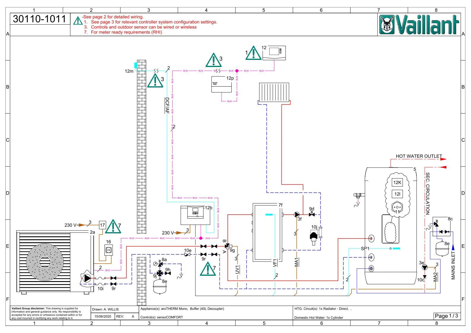

Marvin Posted April 28, 2021 Share Posted April 28, 2021 14 minutes ago, Bruno said: No, there aren't. From the outside unit there are only pipes to the inside. All isolating valves are on the inside. I'm not sure if this is right or wrong I was just looking at the Valliant layout showing 9r isolating valves before 10i the flexible pipes (flexible pipes to reduce vibration down pipes and to stop metal fatigue due to the vibrating of the unit). Here's page 3 with the key: Link to comment Share on other sites More sharing options...
Bruno Posted April 28, 2021 Author Share Posted April 28, 2021 I did see that as well. The installer said that these are to be inside the house as someone could go and close them. Not a big deal there, just a few more liters of water to waste. And of course, to refill the heat pump and part of the circuit. I will install the flexible pipes for sure, then I'll install the rubber pads at the same time. Link to comment Share on other sites More sharing options...
