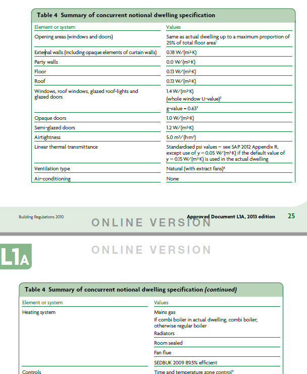

Buzz Posted March 10, 2021 Posted March 10, 2021 Price for the minimum and then keep adding 2k at a time until you hit a number your happy with , if its in budget happy days if not something's got to give , posh kitchen /weak sap , ikea kitchen/good sap . not quite that simple but you get my point . For new build homes, there are two levels for a designer to consider: Limiting Fabric Parameters: The minimum requirements for an individual building element. However if minimum standards were used throughout then the home would fail the overall TER (Target CO2 Emissions Rate). Concurrent Notional Dwelling Specification: A set of requirements for all building elements which together should meet the overall standard (the TER). Area Limiting Fabric Requirement W/(m2K) unless stated Concurrent Notional Dwelling Specification W/(m2K) unless stated Roof 0.2 0.13 Wall 0.3 0.18 Floor 0.25 0.13 Windows 2.0 1.4 Doors 2.0 1.0 – 1.4 depending on glazing Air permeability 10 m3/(h.m2) at 50 Pa 10 m3/(h.m2) at 50 Pa
