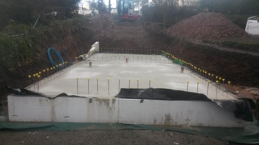

By the time you have excavated all the organic soft top soil, at least a metre here and then built it all back up with infil, then keep on building it up until you get to your slab level you are almost 2M of built up infil.  That would have been an awful lot of material to buy and compact in layers.
Then you would have to continue that raised infill beyond the house and either then slope it down to the ground level, or build a retaining wall.

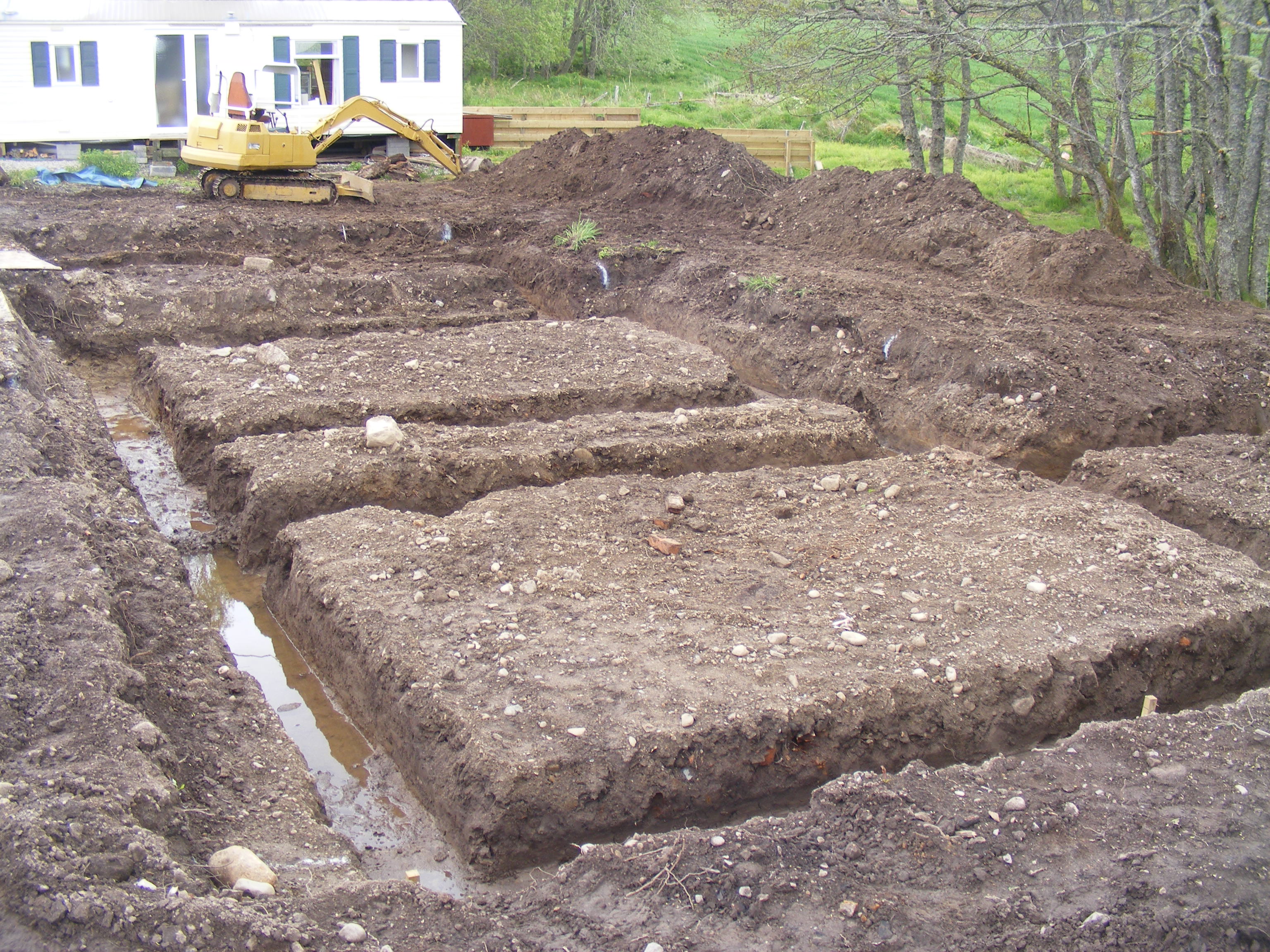

It was oh so much simpler to do stepped strip foundations and then a well insulated suspended floor.  Less work, less cost, still a well insulated floor and nothing fancy to do with the garden levels.

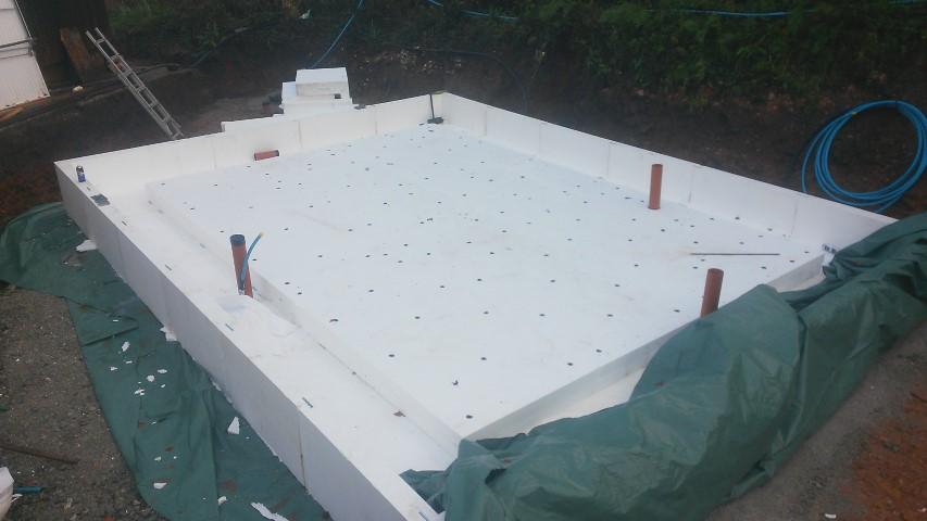

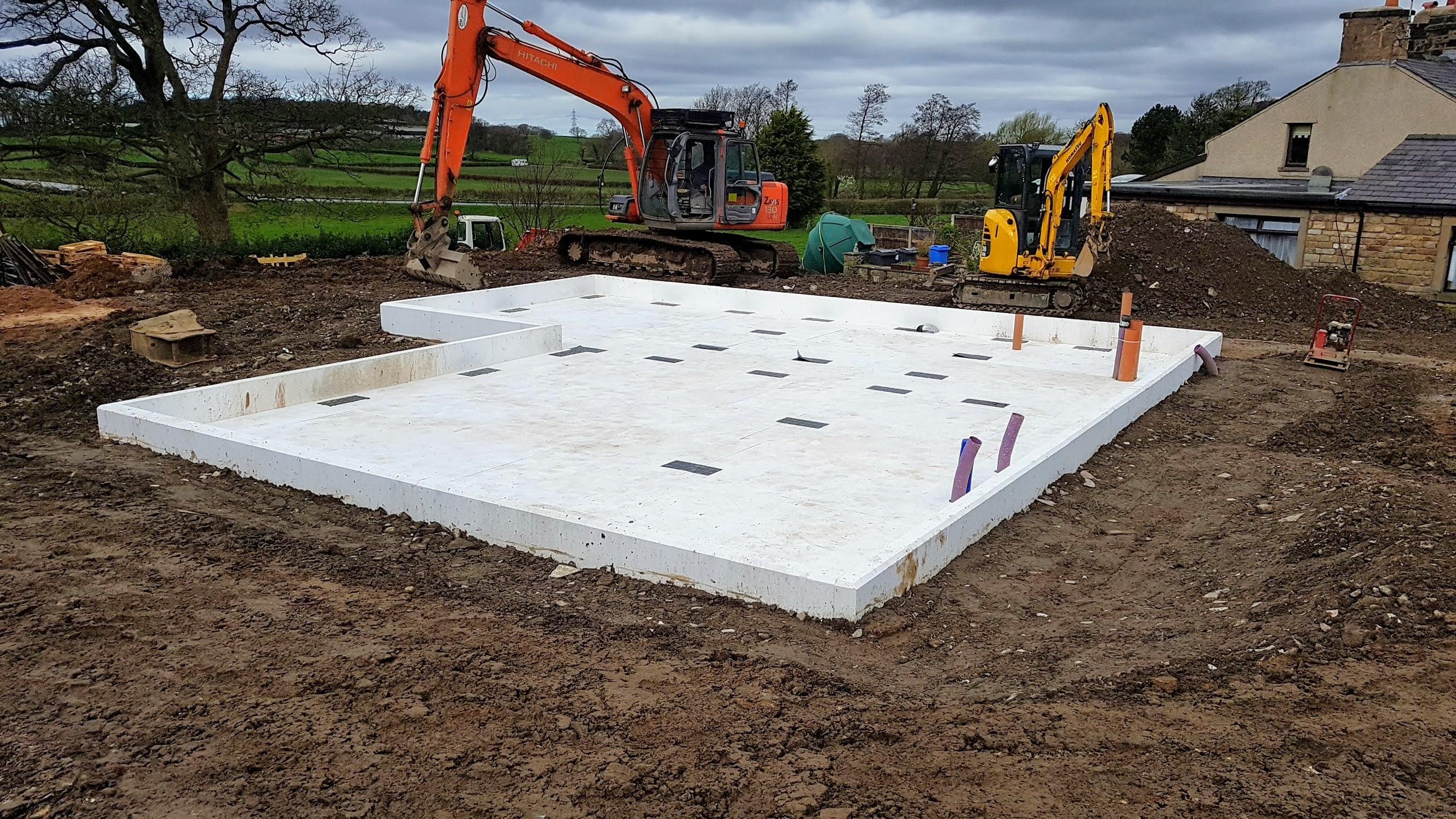

Hi I have put a raft foundation in 5.5m x 12.5 m dug down 2m one end to level up sight removed 28 truck loads. So as long as the ground is good when you dig out it should not be a problem but raft needs to be on a flat level  ground
Keith

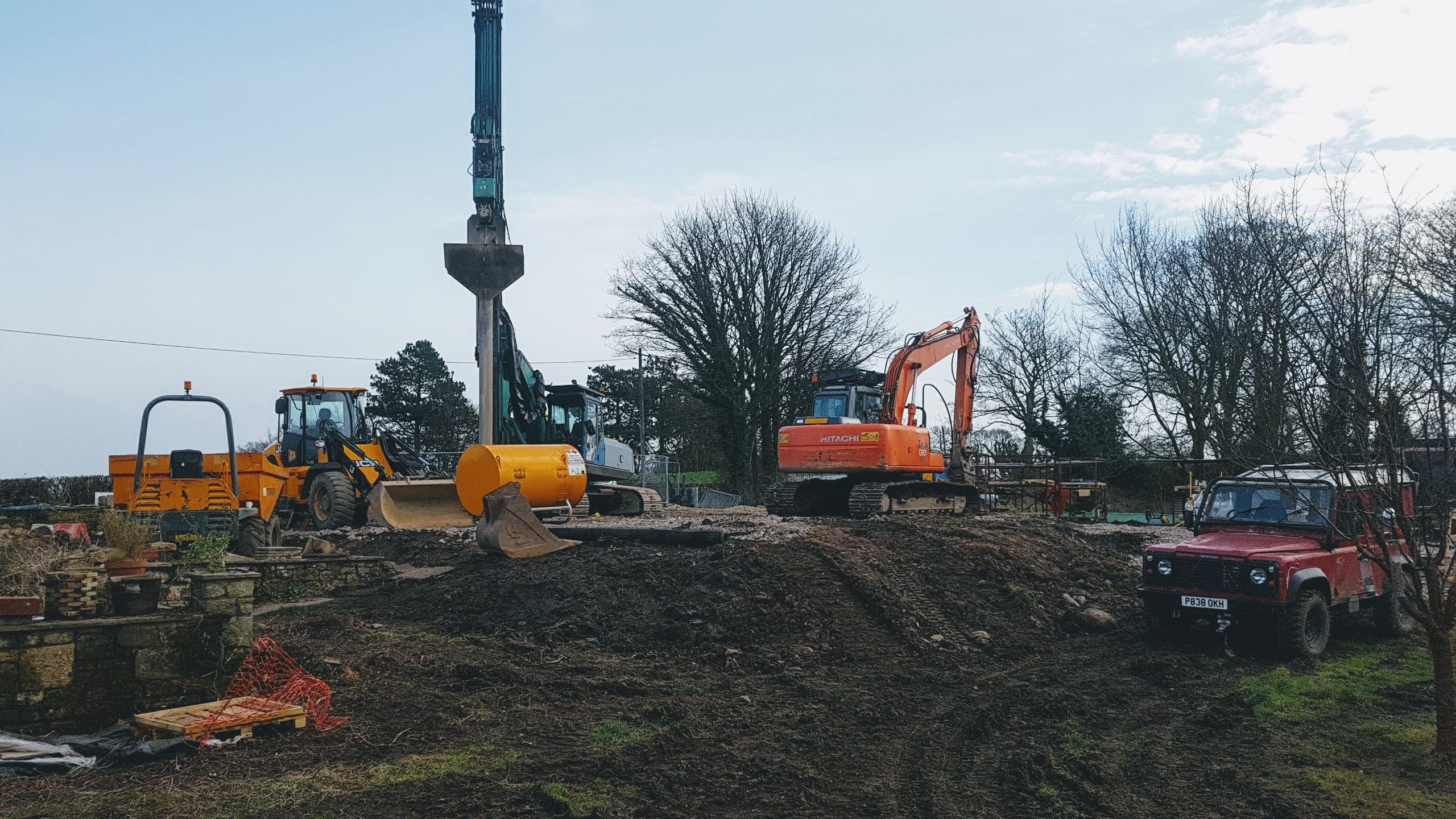

Yes.Ours slope is at least 2 meters (more often more) across the site (25 meters) . The fence behind the 14 tonner is 2 meters high.
The raft has 64 piles underneath it (£6500) because we are on Made Ground .  Piling took one day, everything finished in 3.
This photo shows the fall across the site.
Edited by ToughButterCup

@keith65  I see so you’ve gone longer and narrower. How many bedrooms and what’s your layout? Are those up stands for ICF?

I dug the footings myself with my own little digger, then the builders poured the concrete and built up from there.  Timber suspended floor.
In the above picture the FFL is only just above ground level, but at the far left corner is over 1M above ground level.

Hi
Mine is a one bed house with double garage so house is only 7.25m x 5.5m  two story in Isotex icf
