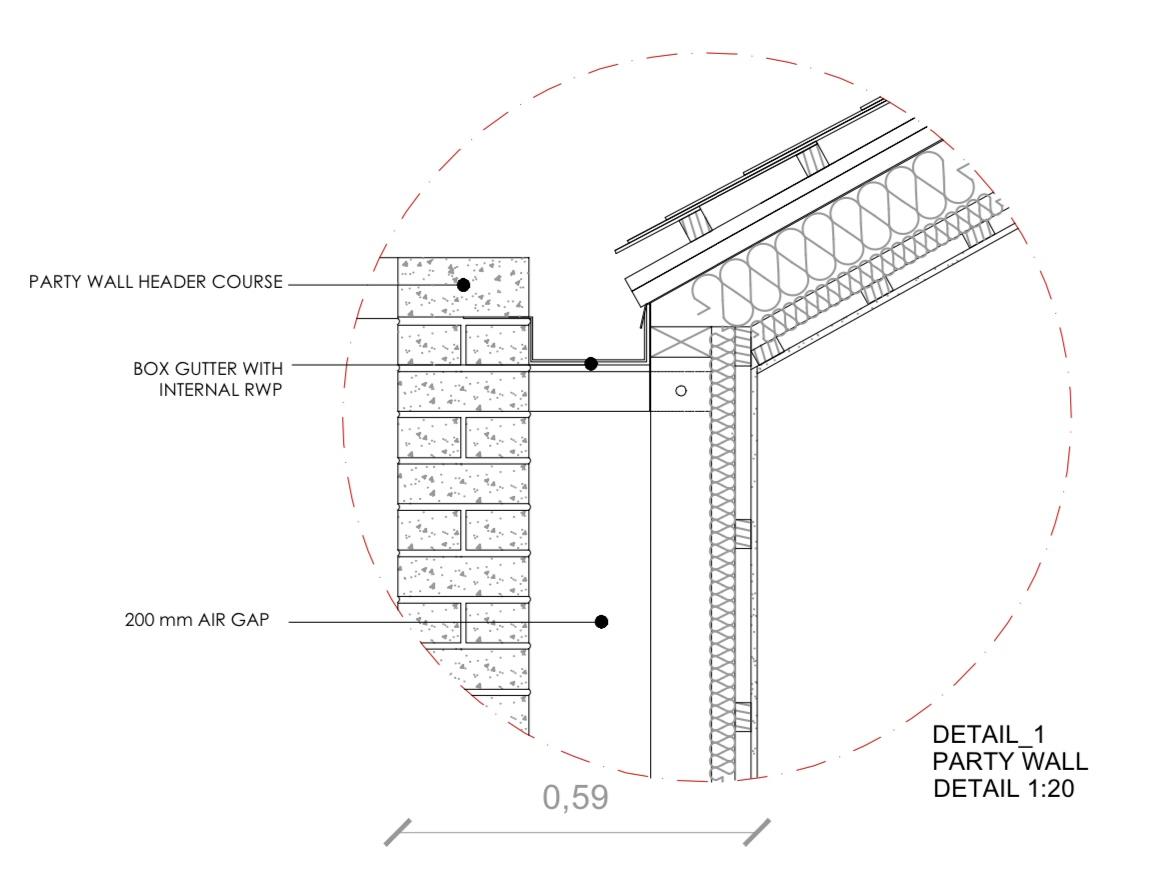

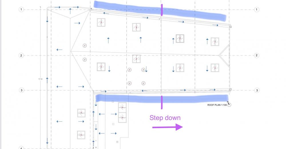

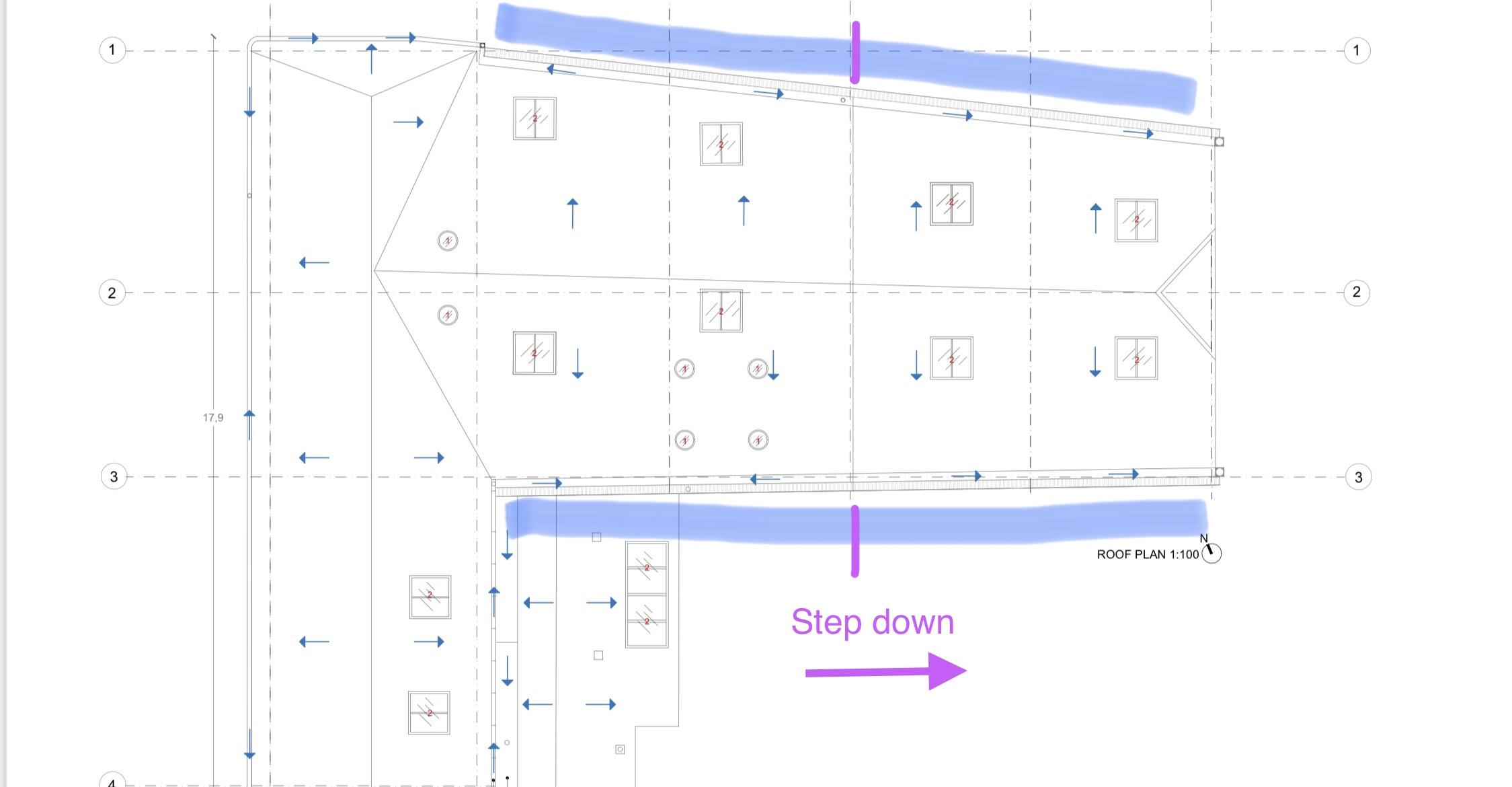

ashthekid Posted March 11, 2021 Author Posted March 11, 2021 Here is where the box gutter is going(in blue) and where there is substantial step down(in pink) but not joining steps as there is an internal RWP in each length, so 4x RWP’s in total because of party wall issues. As a side topic, I am considering installing a couple of water harvesting units within the large air gap we have that the RWPs are also going down into and directly connecting them to toilets which will be back to back to the air gap side wall.

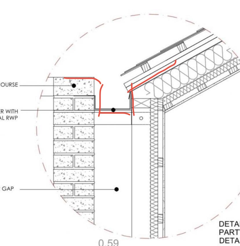

PeterW Posted March 11, 2021 Posted March 11, 2021 Very poor design .. Water shedding at speed will hit the bricks on the top not the gutter. That also looks a very large roof - I think you will need to check volume carefully as your gutter isn’t very deep. Over 10m, even at 1:80 drop you will lose 80mm or more than a course of bricks. I would create a very deep gutter all formed in GRP. It would be minimum 150mm deep, and lap both sides of the gutter up and under the tiles / slates until level. Ideally then add a coping stone on top of the wall or make an aluminum capping to go over the lot. Very rough picture below ..!! You will also need to insulate that corner properly under the edge of the tiles as that’s a horrendous cold bridge if you’re not careful. 1

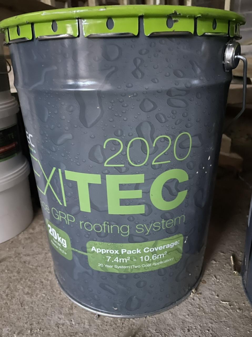

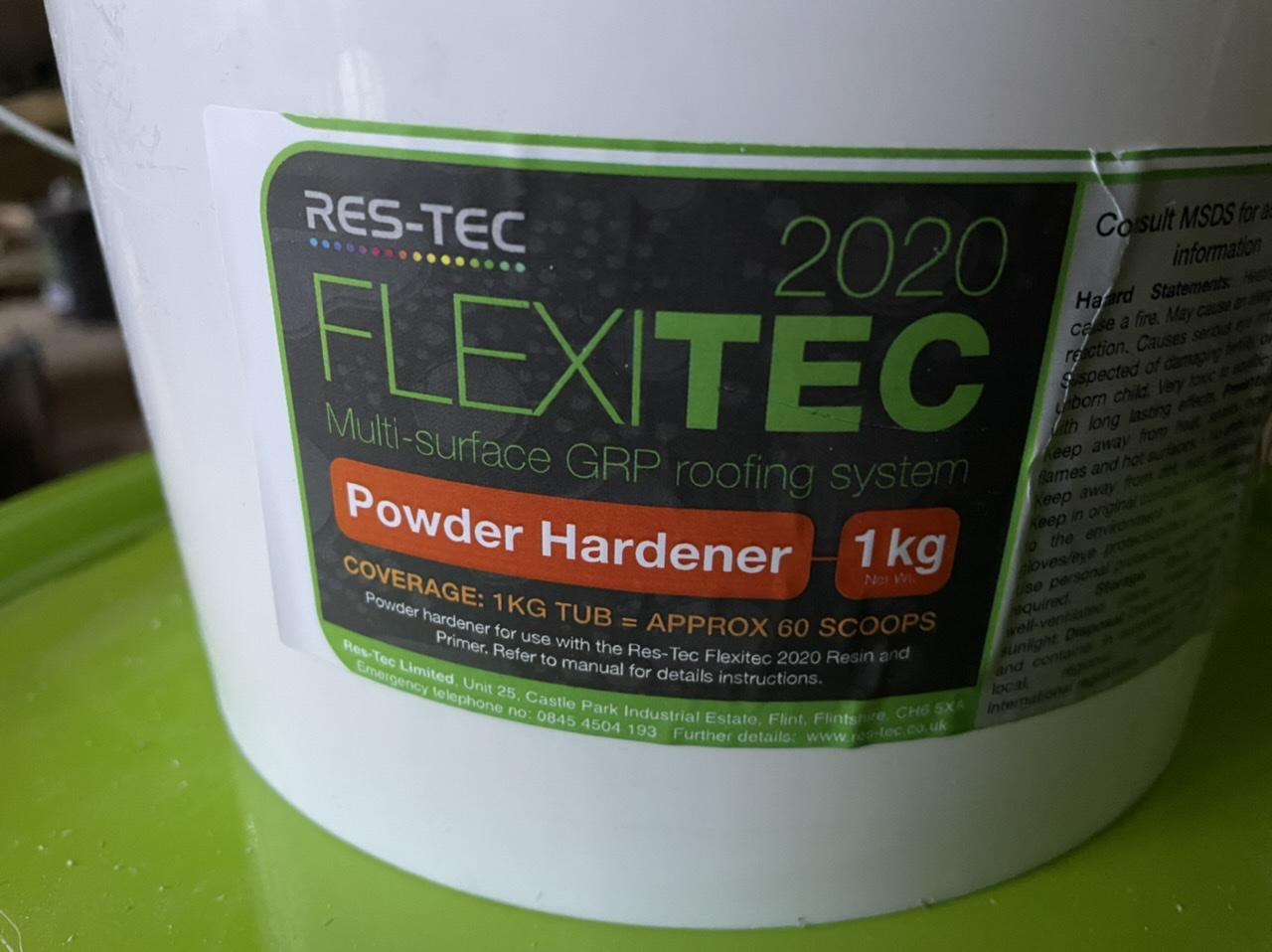

ashthekid Posted May 14, 2021 Author Posted May 14, 2021 (edited) Update: box gutter has been created with ply and now this product below is being used to line it. FlexiTec by RES-TEC. Anyone used it before? Is this the GRP that was suggested? Taken from their website: The Flexitec 2020 System by Res-Tec is a flexible, single resin GRP system with full overlay and new deck capabilities. Combining the best elements of fibreglass with the versatility of overlay systems, no other flat roof solution performs at this level across so many applications. Edited May 14, 2021 by ashthekid
PeterW Posted May 14, 2021 Posted May 14, 2021 It’s a powder hardened GRP - are they also using mesh..? Other option is Desmopol or similar - it is a rubber based product so more flexible but potentially less durable. How will you get to maintain this out of interest ..??
SteamyTea Posted May 14, 2021 Posted May 14, 2021 (edited) The curing agent can come in may forms. Usually a liquid, but often a powder. This powder can be incorporated into the weave or mat. Nothing special about it. Edited May 14, 2021 by SteamyTea
ashthekid Posted May 15, 2021 Author Posted May 15, 2021 @PeterW No mesh matting that I can see being used, just a RES-TEC primer onto the ply then the resin along with powder hardener. I’m assuming mesh only really gets used in larger flat roof type surfaces, rather than small box gutters like this? Access and maintenance from a ladder either side. There is only approx 2m that would be trickier to access because of neighbouring property adjoining the party wall.
