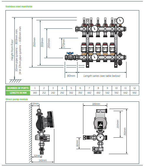

Quick check and the Wilo pump set and 4 port from Wunda is 505mm so you may gain a few mm by rotating the pump but that probably won’t fit between the internal sides of a 500mm cabinet.
  • Like 1
Posted
1 hour ago, daiking said:
This is an 800mm cupboard:
These are exactly the images i was looking for, @daiking you are a star. 800mm looks like a good option.
These are the dimensions i have and it looks like i wasn't accounting for the pump module, for a 4 port that is ~560mm plus some valves so 800mm would be o.k

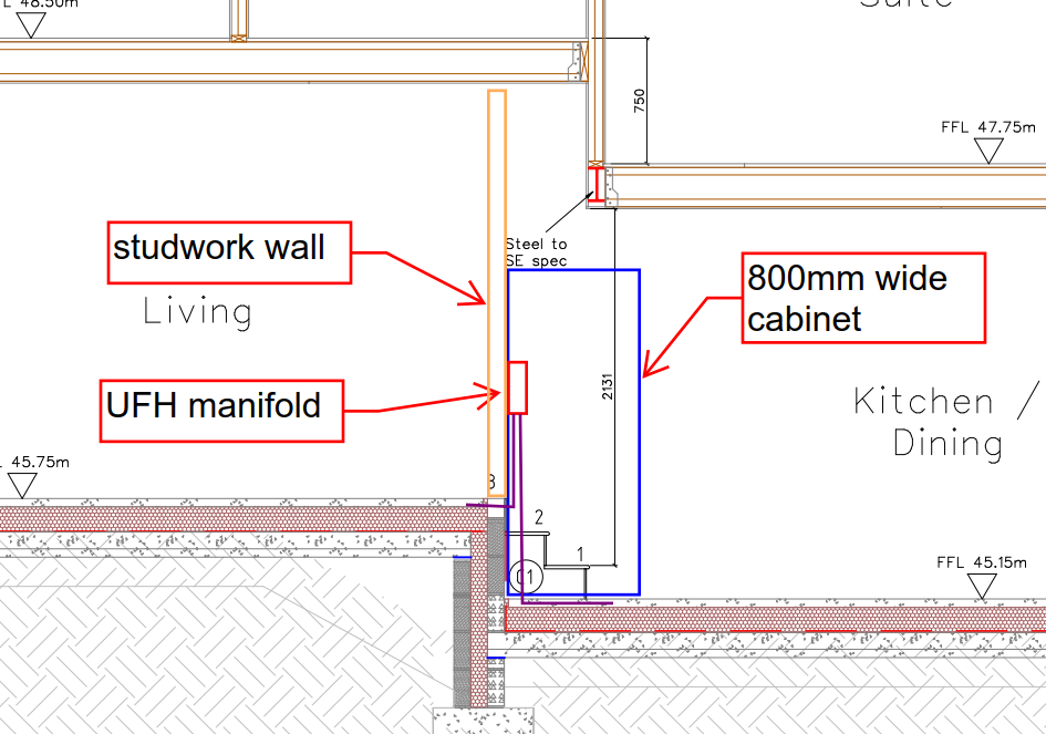

This is where i am looking to put it, so there would be no issue going to a 800mm width tall cabinet.
Though because it is a split level house it would be at a high level to get to the upper floor screed, as below

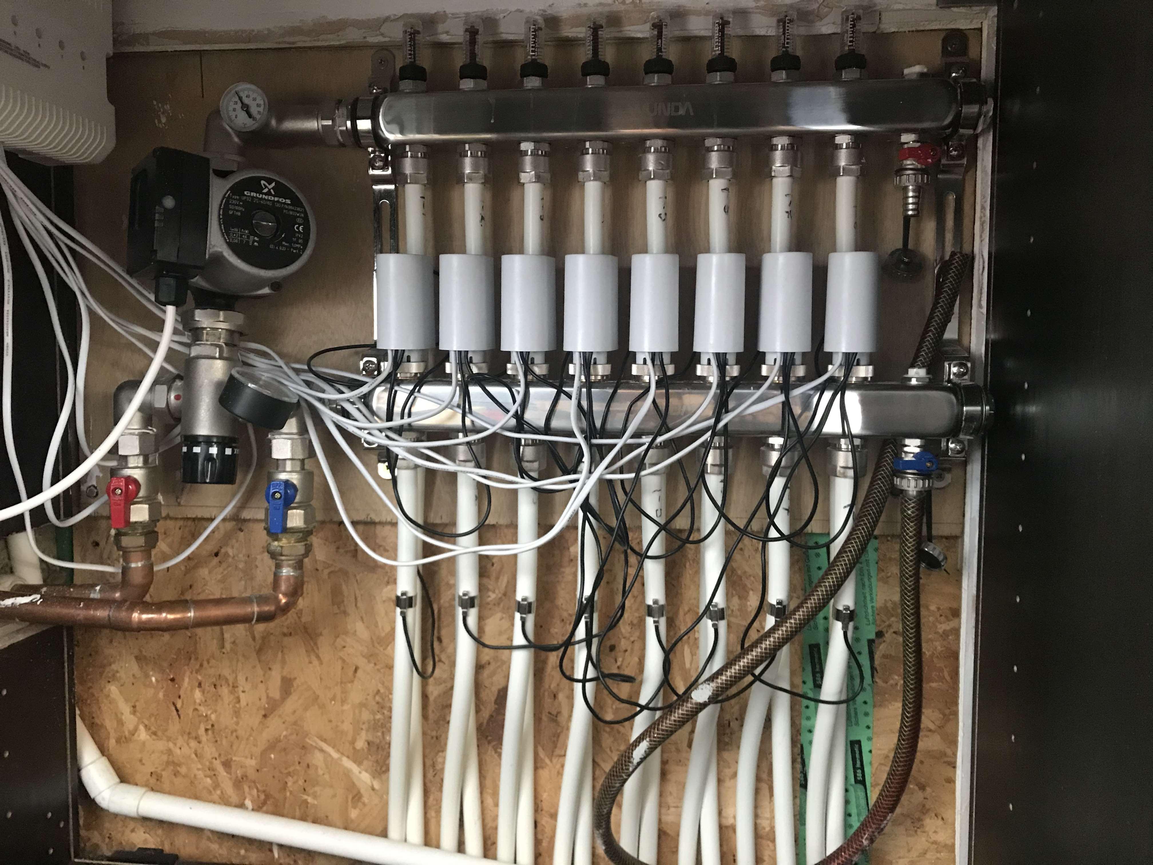

I fitted an 8 port manifold in an 800mm wide cabinet. I did put the manifold to gather first just to double check it would fit.
Posted
That does look tight, and i don't know if i would want to be that close to the margin! :)
