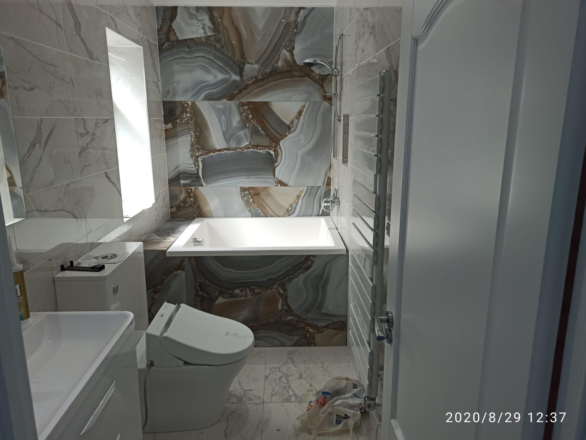

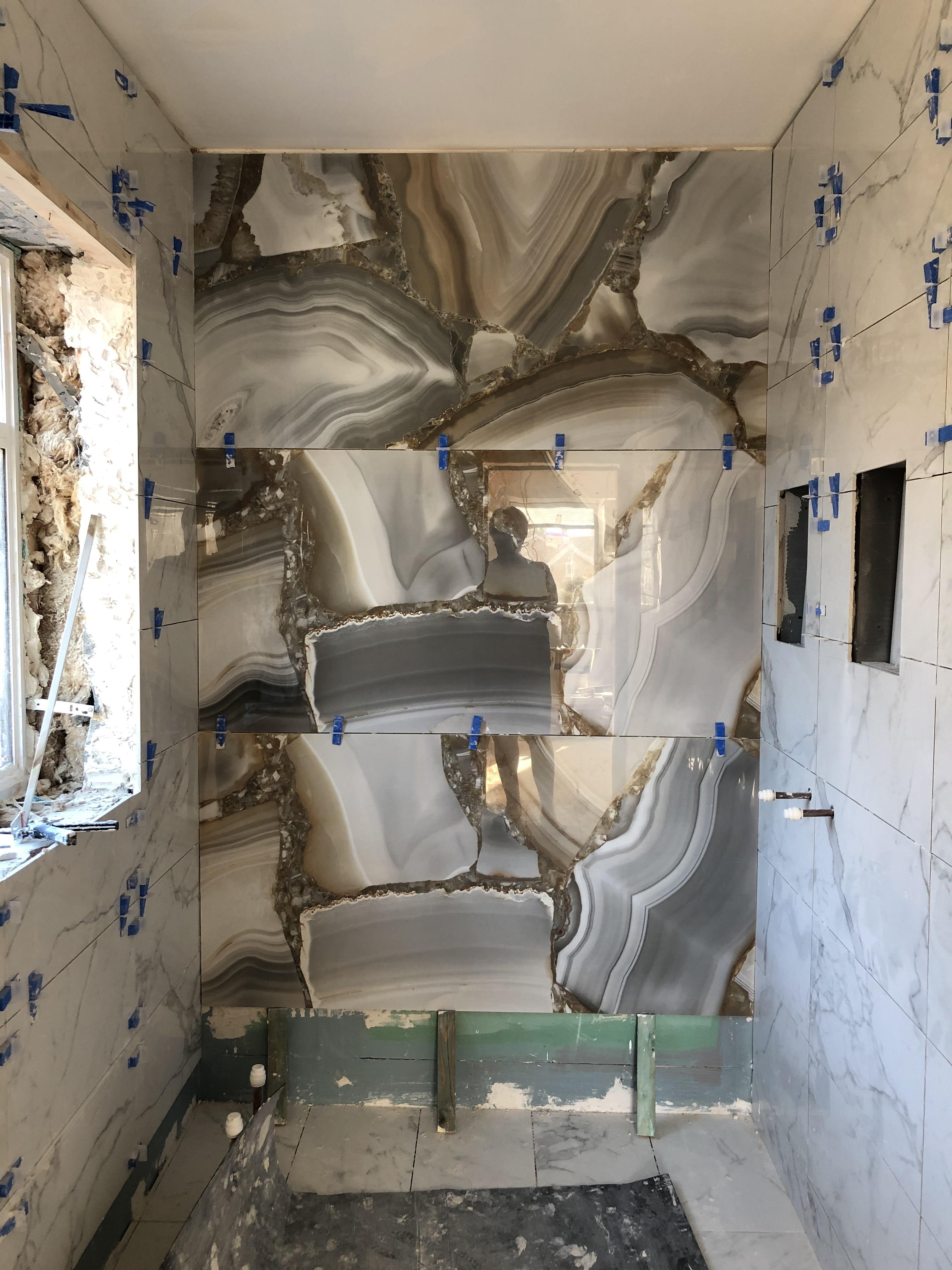

Bored Shopper Posted March 7, 2021 Share Posted March 7, 2021 Hi, yes we did - 5 panels on the feature wall in the bathroom as they were exact width of the ensuite! Our tilers loved working with them as it's a big job done in half the time. Yes they do require a second pair of hands to lift and position, but doable and looks fantastic. They are not thick so not mega-horrible to maneuvre in position. Link to comment Share on other sites More sharing options...

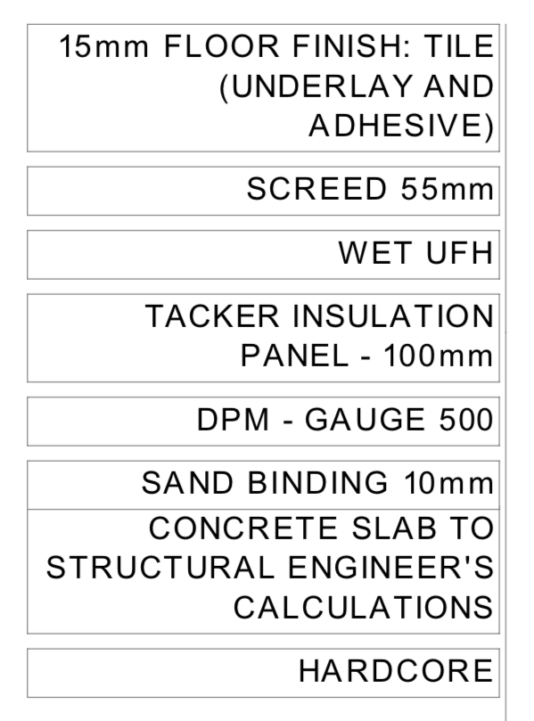

Adsibob Posted March 7, 2021 Author Share Posted March 7, 2021 1 hour ago, nod said: the bed needs to be thicker 20 mil Thanks @nod i had only allowed 15mm, for a 6mm tile and 9mm for the underlay and adhesive Attached is a diagram of my proposed build up. I might be able to borrow some mm from the screed and have thinner screed or I could have slightly less insulation. Or potentially increase the floor level, but it is potentially complicated to do that as they have already laid the foundations of the extension. What would you recommend: Link to comment Share on other sites More sharing options...
nod Posted March 7, 2021 Share Posted March 7, 2021 You will need 6 mil for the underlay 9 mil tile would need 10 mil of adhesive making 24 mil build up A larger tile means less adjustment = Thicker bed Link to comment Share on other sites More sharing options...
Adsibob Posted March 7, 2021 Author Share Posted March 7, 2021 24 minutes ago, nod said: You will need 6 mil for the underlay 9 mil tile would need 10 mil of adhesive making 24 mil build up A larger tile means less adjustment = Thicker bed Sorry, I’m confused. What is the build up for a large format 6mm tile? 6 for underlay plus 20 of adhesive, so including the tile itself 32? Or does the 20 you mentioned originally include the 6mm underlay? Link to comment Share on other sites More sharing options...
nod Posted March 7, 2021 Share Posted March 7, 2021 2 minutes ago, Adsibob said: Sorry, I’m confused. What is the build up for a large format 6mm tile? 6 for underlay plus 20 of adhesive, so including the tile itself 32? Or does the 20 you mentioned originally include the 6mm underlay? No you will have 6 for the matting Which ever tile you use 20 adhesive for the 2.4 x 1.2 tiles Link to comment Share on other sites More sharing options...
PeterW Posted March 7, 2021 Share Posted March 7, 2021 51 minutes ago, Adsibob said: Thanks @nod i had only allowed 15mm, for a 6mm tile and 9mm for the underlay and adhesive Attached is a diagram of my proposed build up. I might be able to borrow some mm from the screed and have thinner screed or I could have slightly less insulation. Or potentially increase the floor level, but it is potentially complicated to do that as they have already laid the foundations of the extension. What would you recommend: Lose the sand - it’s pointless. Slab is also a mildly contentious issue with a few people too as it is a hang over from old build methods. With UFH do not lose the insulation or you’re just heating slab and ground below it. 100mm is bare minimum for UFH. With 55mm screed you’re in liquid screed territory anyway - how big is this space ..?? and do you really mean tiles that are 8 ft x 4ft..??!! Link to comment Share on other sites More sharing options...
nod Posted March 7, 2021 Share Posted March 7, 2021 8 minutes ago, PeterW said: Lose the sand - it’s pointless. Slab is also a mildly contentious issue with a few people too as it is a hang over from old build methods. With UFH do not lose the insulation or you’re just heating slab and ground below it. 100mm is bare minimum for UFH. With 55mm screed you’re in liquid screed territory anyway - how big is this space ..?? and do you really mean tiles that are 8 ft x 4ft..??!! The largest I’ve used have been 200 x 1200 and they where very heavy Link to comment Share on other sites More sharing options...

Adsibob Posted March 7, 2021 Author Share Posted March 7, 2021 2 hours ago, PeterW said: Lose the sand - it’s pointless. Architect tells me the sand is to make sure any imperfections in the slab don’t puncture the DPM. The area we are tiling is about 7.5m by 9.5m. And yes I do mean 1200 x 2400. The tiles we are going for are a cement effect tile. The alternative is to lay microcement, but so that it didn’t crack my understanding is that first the screed has to be fully cured before laying the microcement (so 55 days for 55mm to fully cure) and the underfloor heating must never to exceed 26 or 27 degrees at the floor. Is it me, or does that sound a little onerous/ stressful. Can the builder do other jobs whilst the screed is curing? When can one walk on the screed? Link to comment Share on other sites More sharing options...

PeterW Posted March 7, 2021 Share Posted March 7, 2021 26 minutes ago, Adsibob said: Architect tells me the sand is to make sure any imperfections in the slab don’t puncture the DPM. Architect is from the 1950’s... Use a layer of 12mm EPS, it will crush to the imperfections and then provide additional insulation to the slab (which you will need with UFH) Sand is not required. Neither is a structural slab these days, do it with concrete and bin off the screed. Look at a resin floor - can’t remember who has it here but looks stunning ( @Bitpipe..?) and will allow you the finish you want in about 6mm. Or look at one of the commercial flow coats you can get, all of which will be cheaper than your tiles as I’m pretty sure they will be £100/m or more. Link to comment Share on other sites More sharing options...

Adsibob Posted March 7, 2021 Author Share Posted March 7, 2021 22 minutes ago, PeterW said: Architect is from the 1950’s... he’s actually only qualified in the last 3 years and his specification complied with NHBC guidelines which say blinding must be “sand or other fine material”, as far as I can see that wouldn’t include polystyrene, although I agree that that would give better insulation: https://nhbc-standards.co.uk/5-substructure-ground-floors-drainage-and-basements/5-1-substructure-and-ground-bearing-floors/5-1-16-blinding/ Link to comment Share on other sites More sharing options...

PeterW Posted March 7, 2021 Share Posted March 7, 2021 1 hour ago, Adsibob said: he’s actually only qualified in the last 3 years and his specification complied with NHBC guidelines which say blinding must be “sand or other fine material”, as far as I can see that wouldn’t include polystyrene, although I agree that that would give better insulation: https://nhbc-standards.co.uk/5-substructure-ground-floors-drainage-and-basements/5-1-substructure-and-ground-bearing-floors/5-1-16-blinding/ NHBC “standards” are crap, they are bare minimum and pretty much never adhered to. Go look at an NHBC signed off house then make your own mind up. 12mm Polystyrene more than meets the requirement, it is a pliable material which will support the DPM and prevent puncture, it has insulation value and also is quick and easy to lay. Link to comment Share on other sites More sharing options...
Adsibob Posted March 7, 2021 Author Share Posted March 7, 2021 11 minutes ago, PeterW said: NHBC “standards” are crap, they are bare minimum and pretty much never adhered to. Go look at an NHBC signed off house then make your own mind up. 12mm Polystyrene more than meets the requirement, it is a pliable material which will support the DPM and prevent puncture, it has insulation value and also is quick and easy to lay. Okay, fair point. What compressive strength polystyrene would you recommend. Is 70kpa enough for a very firm floor? Link to comment Share on other sites More sharing options...
