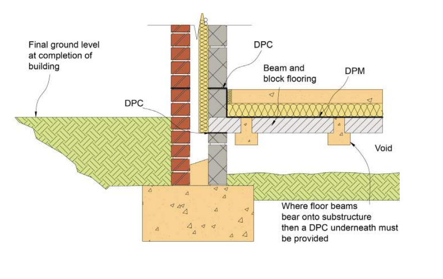

crispy_wafer Posted March 5, 2021 Share Posted March 5, 2021 Sat in work and a daft question entered my head, it not important right now, but I cant work out what's the right way to go about? So, DPM, does it go down before block internal walls get built or after? If it goes down before then it's gonna get shredded and ripped up, so has gotta go down after , right? Internal block walls will have a dpc built into them then you dpm each room connecting to the DPC layer separately? - Is that right? Block+Beam floor if it makes any difference. Link to comment Share on other sites More sharing options...
Temp Posted March 5, 2021 Share Posted March 5, 2021 Typically the beams in a B&B floor rest on/in internal walls/stub walls to reduce the span. So the situation is similar to external walls. You put in two DPC. One under the beams and one at the normal height. The DPM goes on top of the B&B before the insulation and connects with upper DPC. Link to comment Share on other sites More sharing options...
Temp Posted March 5, 2021 Share Posted March 5, 2021 Google found a drawing that shows outer walls but internal walls can be done same way.. https://www.premierguarantee.com/media/1212/technical_manual_v11_-_chapter_6compressed.pdf Link to comment Share on other sites More sharing options...
crispy_wafer Posted March 5, 2021 Author Share Posted March 5, 2021 gotcha, Thankyou, pictures are perfect Link to comment Share on other sites More sharing options...
