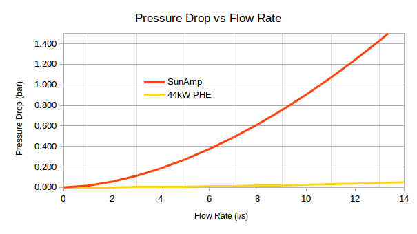

TerryE Posted February 14, 2017 Author Posted February 14, 2017 @JSHarris @jack this issue of when to use flexible hoses vs copper is an interesting one. The SunAmps are supplied with 2×½" (or 15mm) flexible hoses which seems daft to as the internal diameter of flexible fittings is slightly less that the equivalent copper pipe. The SunAmps give flow:PD curves up to 14l/min which a flow speed of ~1.7 m/s which is getting rather high, IMO. Surely it would be better to come out of the SA in 15 copper and jump to 22mm flexible if we really want flexible connectors. The best price so far that I've found for the Harveys Crown Water Softener is £885 inc VAT from Fountain Softeners complete with 22mm high flow install kit. BTW. Have you seem my latest blog posts giving an intro to SunAmps?
Jeremy Harris Posted February 14, 2017 Posted February 14, 2017 (edited) Terry, I have no flexible hoses on our Sunamp PV, and it didn't come with any, there were just 15mm copper stubs sticking out the side to connect to, so I plumbed it in with solid pipe, the same way as a thermal store would be plumbed in. Like a thermal store, the Sunamp PV is pretty heavy, so isn't going to move anywhere. The water softener is a different issue, as the internal twin cylinder unit is quite light and just sits loosely inside the outer case, that is also the brine container. There's enough risk of movement that I thought it did really need flexible connections, particularly as it has 3/4" BSP plastic threaded fittings. I didn't like the idea of risking cracking those by any strain caused by fitting rigid pipes, so used a couple of short, large bore, flexible hoses to connect it. The hoses supplied with the Harvey units are a bit like large washing machine hoses, and apart from the small bore they were also way too long for our installation. It's worth looking around for the best price on the twin cylinder water softeners, as I think we paid less than £800 for ours. Unfortunately I can't recall where we got it from, I'll try and remember to have a look this evening to see if I can find out. I know I bought it online, and that I spent ages looking around to get the best price. As far as I've been able to work out, all the twin cylinder softeners use exactly the same internal Harvey assembly, just in a different case. The spare one I bought is a Crown, but under the lid it's absolutely identical to the TwinTec, just a different casing. Yes, I read your latest entry. Nice to see that internal flow diagram, as I still think it's a clever way to use a couple of NRVs to make a "primary" re-circulating system. Edited February 14, 2017 by JSHarris typo "that" when I meant "than"
