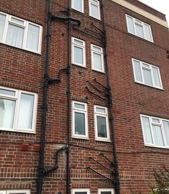

TonyT Posted March 4, 2021 Share Posted March 4, 2021 I’ve never seen black waste pipe used before! we only ever use solvent weld and only ever seen it in white. is it common in England? Link to comment Share on other sites More sharing options...
Gav_P Posted March 4, 2021 Share Posted March 4, 2021 39 minutes ago, TonyT said: I’ve never seen black waste pipe used before! we only ever use solvent weld and only ever seen it in white. is it common in England? Yup... used to make the outdoor plumbing more subtle and classy... 1 Link to comment Share on other sites More sharing options...
joe90 Posted March 5, 2021 Share Posted March 5, 2021 8 hours ago, TonyT said: I’ve never seen black waste pipe used before! Not everyone stocks it, I believe plumbcentre do. Link to comment Share on other sites More sharing options...
TonyT Posted March 5, 2021 Share Posted March 5, 2021 I never even thought About external pipework ! Link to comment Share on other sites More sharing options...

riv990 Posted March 7, 2021 Share Posted March 7, 2021 The picture of the back of the flats , real workman ship cast iron stacks with copper wastes would cost a fortune now Link to comment Share on other sites More sharing options...
