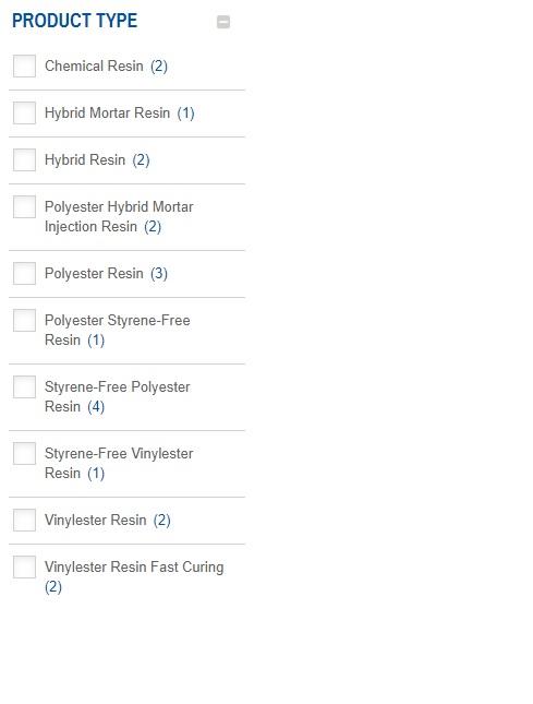

epsilonGreedy Posted March 3, 2021 Share Posted March 3, 2021 I thought I would experiment with resin anchoring today in a trial brick. It is for a small task, I have two metal lateral restraint straps to fix to the facing bricks at the point of a pitched roof abutment. The purpose of the straps is to prevent the ridge and trusses easing away a few mm from the abutment wall. The smallest metal studs for resin fixing seem to be 6mm. My question: Screwfix list different varieties of resin, which one should I use? Link to comment Share on other sites More sharing options...
Mr Punter Posted March 3, 2021 Share Posted March 3, 2021 (edited) As it has not been specced by an engineer, just buy the cheapest that will fit into whatever gun you have. If it is just 6mm studs just use rawlplugs and screws. Edited March 3, 2021 by Mr Punter Link to comment Share on other sites More sharing options...

Roys Posted March 3, 2021 Share Posted March 3, 2021 I use a fair bit of resin, usually just buying the cheapest. I have the resin gun which is a bit wider and heavier duty than a standard skeleton (silicone) gun. If you don’t have a resin gun make sure the tube of resin you buy fits a normal skeleton gun. Also make sure the drilled hole has been dusted out, either by a resin bicycle type pump to blow the dust out of by a vacuum cleaner with a bit of 6mm tube botched on to the end of the hose with duct tape, and when you start to use it the first 3 or 4 inches of resin is not used as it won’t be mixed, there is a distinct colour change when the mixed stuff comes out. For 6mm screwed rod I would be drilling a 7 to 8mm hole. Fantastic stuff. 1 Link to comment Share on other sites More sharing options...

TonyT Posted March 3, 2021 Share Posted March 3, 2021 I use resin a lot, generally 6mm rod will be a 8mm hole, drilled out, dust blown out, damped if required/time allows/ instructions specify resin gun spout inserted into hole all the way in, and trigger pulled, pull out an inch and trigger pull continue until end of hole. screwed rod, twisted into resin not pushed. warmer the ambient temp the quicker it goes off. As other say don’t use the first few dribbles of resin until it’s consistently mixed. Link to comment Share on other sites More sharing options...
