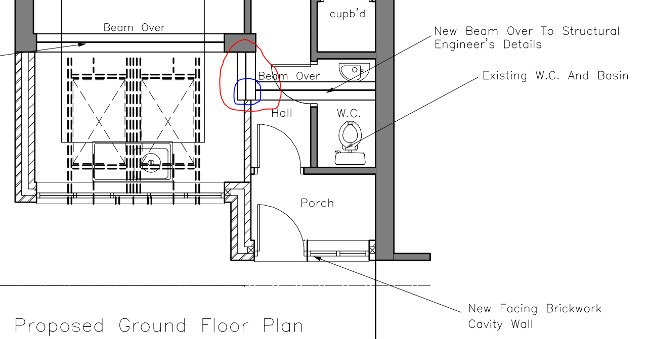

  7. Hi, I am attempting to complete most of the work on my extension myself. It's going good so far, foundations dug, poured and just building cavity up to damp in prep for the oversite. Its brick and block construction and it's 8 courses between the foundations and DPM.I am happy that the outer cavity will just be 8 courses of F2/S2 bricks but for the inner cavity I plan to lay 2 courses of solid concrete blocks and 2 courses of engineering bricks. Is this acceptable or do I need to buy Dense Concrete Common Bricks Grey 215mm x 100mm x 65mm to use for the top 2 courses above the concrete blocks (to make up to 8 brick courses)? Concrete commons don't seem to be available near me and I have some engineering bricks spare. Thanks, David

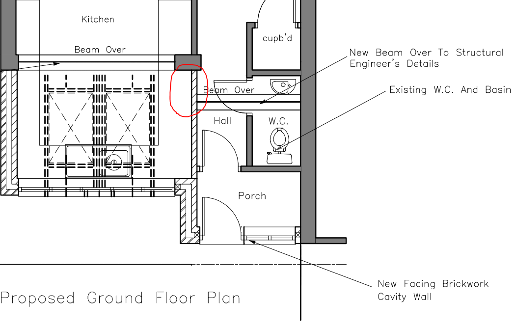

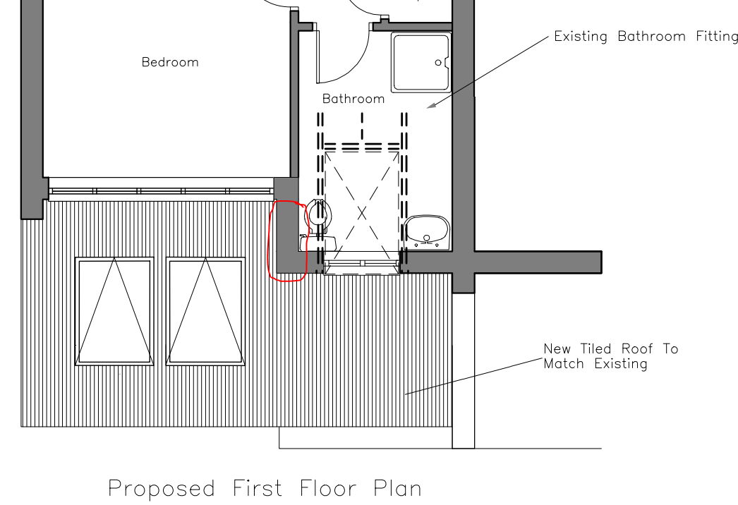

  9. Hi, I've spent my spare time in lockdown learning Autocad, laying bricks/blocks to a line and attempting to build corners I've bought a belle mixer, 110v transformer, wacker plate, hilti 3000 breaker, blakes profiles, cat scanner, pick axe trench shovel,wheelbarrow and all the hand tools required for brick laying I plan on trying to do as much work as I can on a small front extension. The house is semi detached and staggered, so my house is set back from it's attached neighbour and the neighbours already have a single height front extension. Other houses in the street with the same configuration had planning approved for single height front extensions, that extend out to the end of the party wall to match attached neighbours. Originally I drew some plans that were for a single height extension, which I was reasonably happy with but then I thought I might try to get planning permission on a partial double height extension to allow the upstairs bathroom to be extended (it currently only has a shower, as there isn't space for a bath). I was about to submit my attempt at plans but I have just realised I have an upstairs cavity wall floating above an internal (100mm) internal wall (circled in red below):- and wider cavity wall on the first floor:- Looking at the above, I have also just realised I have drawn a cavity for the extended section on the ground floor but a solid block on the first floor, should I change that? Can I just put a beam in the drawing, as below? Would it need a vertical post where I have circles it in blue? It would have a 100mm internal wall under to support it. I guess a structural engineer would advise. Thanks in advance for any help/suggestions on the drawings/build. Cheers, David
