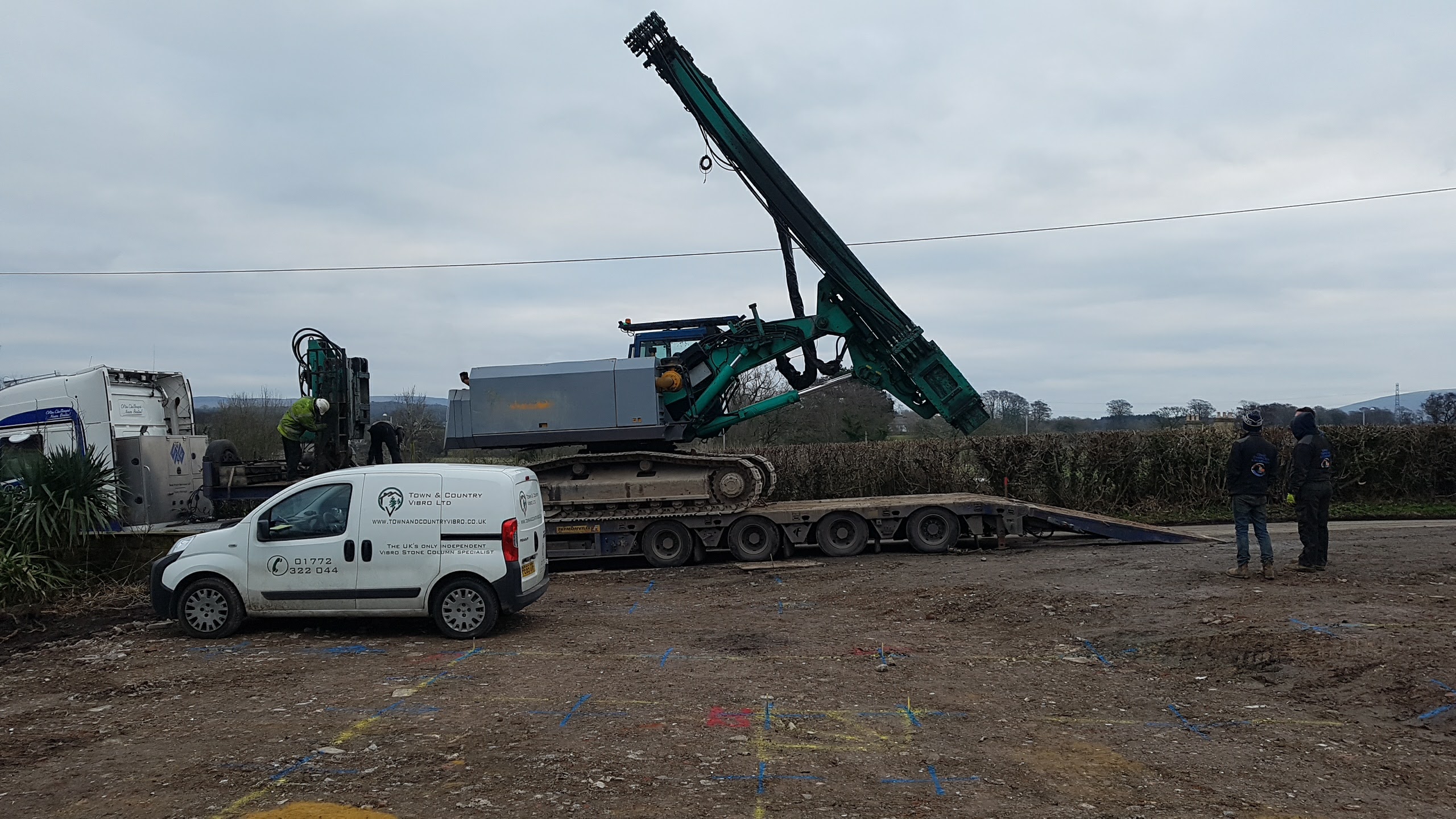

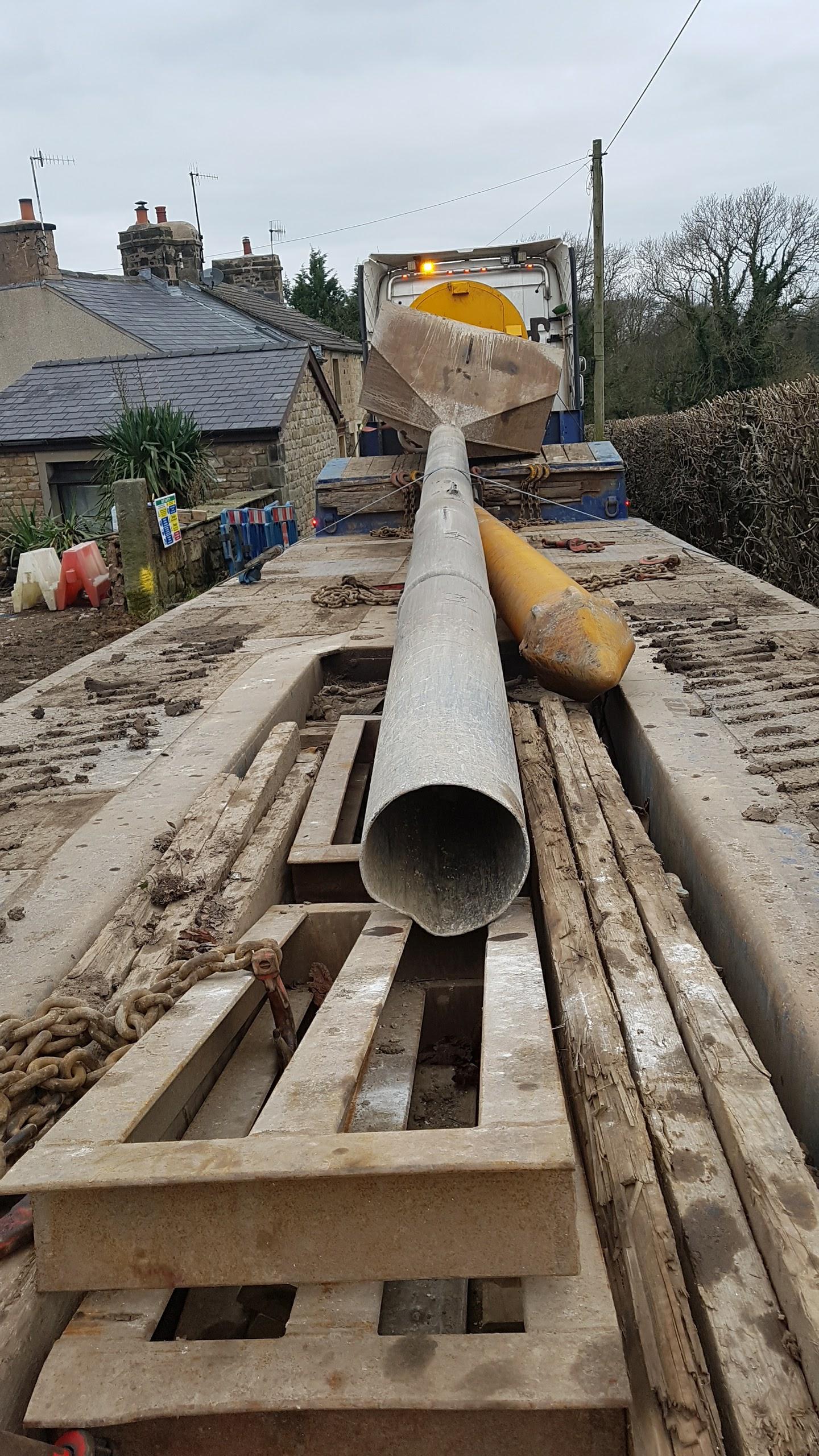

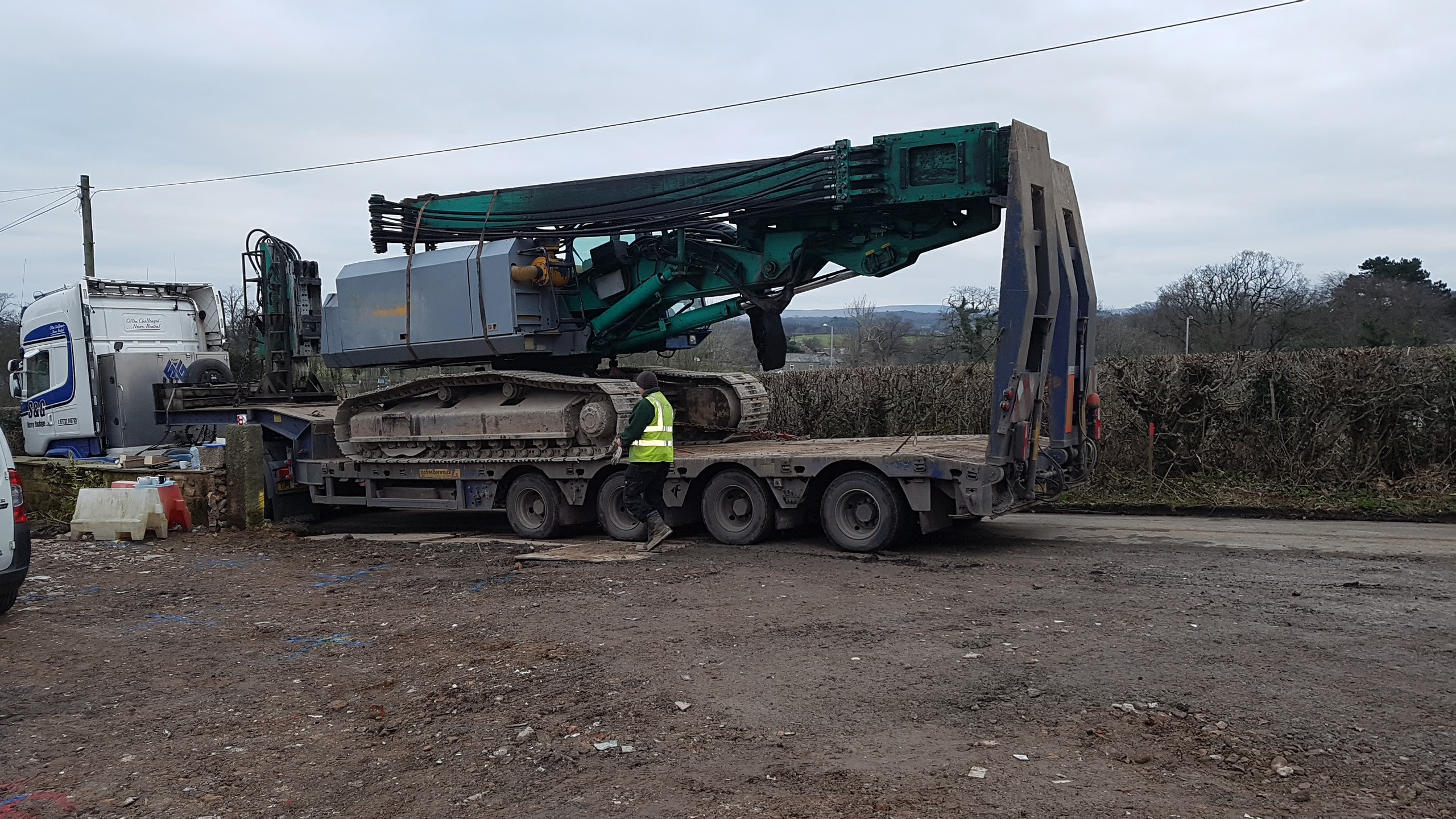

ToughButterCup Posted February 11, 2017 Share Posted February 11, 2017 You see before you an extremely relieved person. 64 piles in, done, dusted, testing happening now. I'm trying to remember when I was so nervous for so long.... and can't. Tucked up warm and comfortable on our bed, and lying in the crook of my knees, the cat growled - he's never done that before - a car had parked outside the house and stopped at stupid o'clock. It was the pile driver chappie arriving a day early. Swiftly followed by a 42 tonne rig.... thus; and before you could say 'That's Big', this happened The piling probe (called a poker) that sits on the front of the rig looks like this Big innit? So how does it work? The rig picks up the poker (heart-in-mouth-stuff), and when positioned correctly, vibrates the poker into the ground to a predetermined depth: in our case 4m or less if refusal occurs before that point. But the trick is to tip some stone into the hopper at the top of the probe. Pull the probe back up a bit, reinsert the probe (into which more stone flows), compact, and do that a few times until the pile is made. Now, this thing vibrates. A lot. So for fun I did this with a bowl of water and some Vimto. Cos frankly, it worried me.... there's a water pipe running very close to 4 of the piles (2m) Not much, but it's hardly a scientific test. Town And Country Vibro set up a wobble meter (forgotten what it's proper name is) which is connected to a modem so the Head Office can see how much wobbling is going on. For comparison I went up to my office and had a look at my wobble waves there. None, or almost none. That did absolutely nothing to allay my fears of bursting the water main. We had prepared properly, though, thus; Man was I relieved when the vibration stopped. No leak, No fountain, no bill from United Utilities. That's not going to stop me taking photographic evidence of the pipe and pit when the road plates come off on Monday and it gets back-filled. Only to bump into a cliff-hanger on the last pile The probe had hit a glacial boulder smack in the middle and split the stone such that the remains filled the exact diameter of the probe. So none of the stone fill could flow into pile hole. Jammed. Solid. Four lump hammers and one sledge hammer all hitting the probe at the same time. Me hitting it as hard as an old codger can; which was a sight harder than the lads were. Too much invested in this pile.... Plop. Out it fell after 5 long minutes. Angels sang Heavenly music when the 8 litre engine stopped and the foreman jumped down. "Ya weren't worried were ya whack?" he asked grinning like a Cheshire Cat. "Naaah" I lied. Ian 2 Link to comment Share on other sites More sharing options...

ProDave Posted February 11, 2017 Share Posted February 11, 2017 All good stuff. I didn't know the glaciers were that far south (I don't suppose many people talk of you being in the south do they) Glacial boulders are everywhere here. Did they let you have a go driving it? In essence it;s just a slightly modified digger (take off the bucket, replace with a vibro rod) Link to comment Share on other sites More sharing options...
ToughButterCup Posted February 11, 2017 Author Share Posted February 11, 2017 12 minutes ago, ProDave said: ... slightly modified digger (take off the bucket, replace with a vibro rod)... That's a generous description. I'll take a few minutes tomorrow to jump up on the rig and take a few close up photos. It looks like a lot of hydraulic gubbins are needed to grasp the probe in the first place and then shake the living daylight out of a tonne of stone plus the weight of the probe - and ram both four meters into the earth (6F2 to. 38 of a meter) . The ground visibly bulges like a bow wave around the probe as it descends, perhaps bulging by 50mm sometimes more. I'm told the power plant is an 8 litre beast. Link to comment Share on other sites More sharing options...

ProDave Posted February 12, 2017 Share Posted February 12, 2017 4 minutes ago, recoveringacademic said: Yes @MikeSharp01, it was a baptism of fire. And I do remember the thought that 'nothing-will-be-as-bad-as-this' when the the rig engine shut down for the last time. Swiftly followed by the thought that this board is full of cautionary tales, and full of support for people who have been through far worse. I can see the rig from the office window: sitting there putting many tonnes of pressure on two piles. The first test completed yesterday, showed that a single pile took in excess of 11 tonnes on a wall that will, at most, need to take 4.... serious engineering indeed. The SE's PI must be expensive eh? You mean it hasn't left the site yet? Search you tube for machinery falling off the low loader, low loader getting bogged down, machinery and low bridges / power lines. That will ensure you don't sleep until it's off your land and not your problem. Link to comment Share on other sites More sharing options...
ToughButterCup Posted February 12, 2017 Author Share Posted February 12, 2017 29 minutes ago, ProDave said: You mean it hasn't left the site yet? Search you tube for machinery falling off the low loader, low loader getting bogged down, machinery and low bridges / power lines. That will ensure you don't sleep until it's off your land and not your problem. The job requires tests to three piles. One has already been done. (11 tonnes on a single 4 m pile) The hydraulic jack needed failed between tests, so there has been an enforced delay. Your point about transport is EXACTLY correct. I wrote a carefully worded Traffic Managementment Plan, and sent it to the TCVibro. They outsource their transport. I am not sure what happened, but the rig arrived on a low loader with a fairly cross driver. He needed a good deal of reassurance and charm to bring him down from his annoyance-induced high. As luck would have it, Daniel Cowley -our Groundworks Company- was there as the rig arrived. Daniel had brought his 16 tonner, dumper and other gear (by sheer chance) on a bigger low loader than the one needed for the 42 tonne piling rig. Daniel's brand of no-nonsense plain talking to the driver was a significant asset. It was then left to me to do the soft stuff: bacon butty, coffee, drive around several exit routes with him for reassurance. For the return trip, I am trying to arrange that the company rings me before the rig sets off. At least I can meet the driver a few miles out on the A6 and we can agree a strategy in relation to unforeseeable hiccups - like people parking in the lane and going for a walk blissfully unaware that a piling rig will be passing a few millimeters away from their brand new Ferrari. By then, of course, it won't be my problem. But, no need to spoil the ship for a ha'porth of tar, eh? Link to comment Share on other sites More sharing options...
