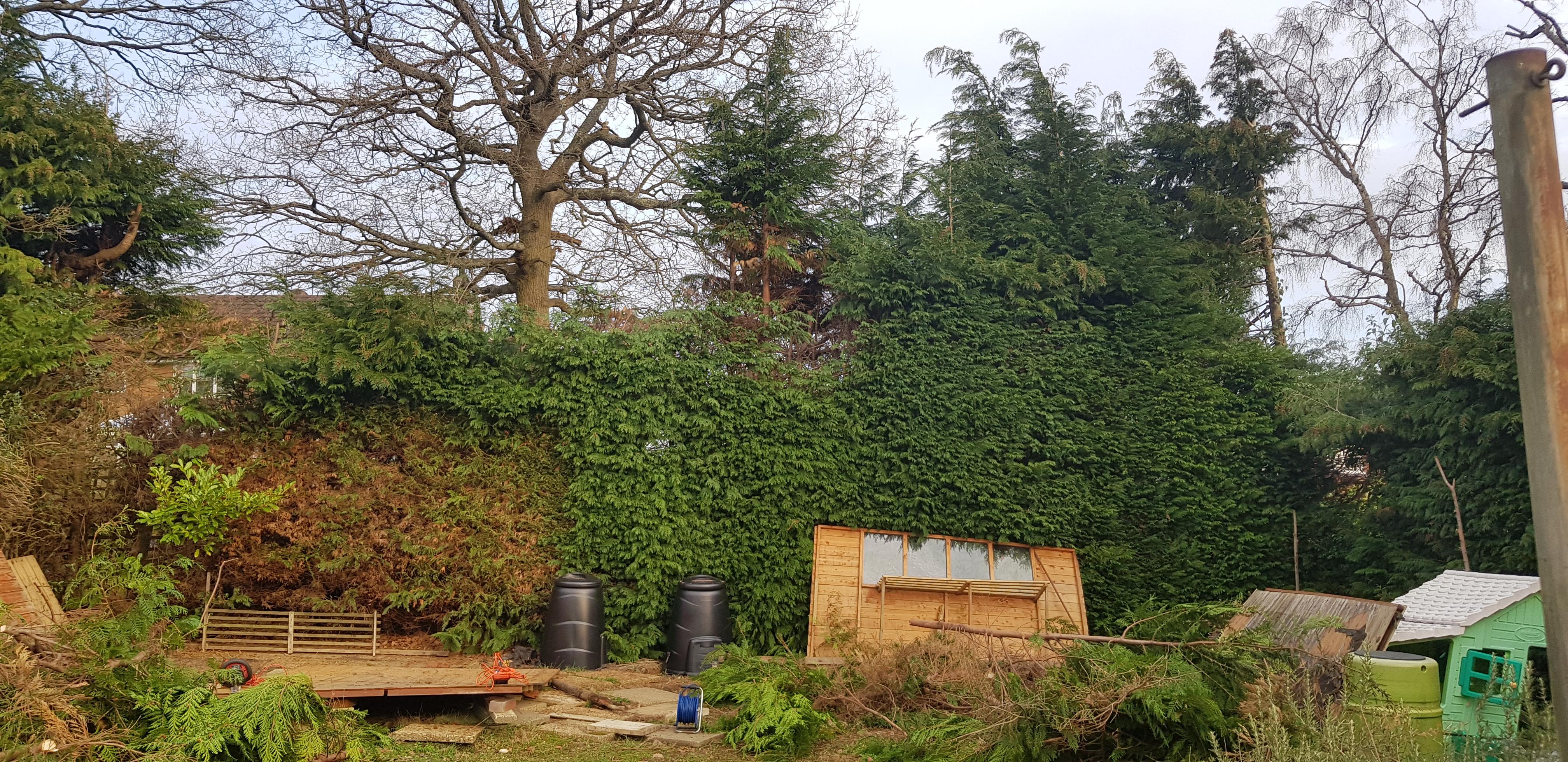

oldkettle Posted February 21, 2021 Share Posted February 21, 2021 37 minutes ago, Adsibob said: No, both we and our neighbours are on the same level. We have an old shed at the back of the garden at the moment which we are getting rid of. It is 2.5m high (so higher than the shed we would build) and provides no screening at all. I need something that will grow to about 5 - 6m in height, maximum 7m. Carpinus Betulus Fastigiata sounds like an option, though will take time to fully mature. Though i could spend a bit more to get a semi mature one. But that might cost a fortune actually, as I will need about 4. I am slightly confused, sorry. How come a 2m solid structure provides no screening? Or do you mean between first floor windows? Attached a picture of how it looks from my side at the moment - seems 4m ridge we planned should be more than enough. Carpinus Betulus Fastigiata looks like a proper tree. Are your neighbours not concerned about something so big close to a boundary? I must admit I was surprised ours never requested a cut as the hedge blocks all light in their garden after about 4pm. Link to comment Share on other sites More sharing options...
Adsibob Posted February 21, 2021 Author Share Posted February 21, 2021 51 minutes ago, oldkettle said: I am slightly confused, sorry. How come a 2m solid structure provides no screening? Or do you mean between first floor windows? Attached a picture of how it looks from my side at the moment - seems 4m ridge we planned should be more than enough. Carpinus Betulus Fastigiata looks like a proper tree. Are your neighbours not concerned about something so big close to a boundary? I must admit I was surprised ours never requested a cut as the hedge blocks all light in their garden after about 4pm. I am more concerned about the first and second floor windows. Obviously second floor is so high up that not sure I will be able to do anything about this, so main concern is first floor. Re putting trees on the boundary instead of the leylandii, the neighbours won’t object - when we were going to cut the leylandii down they objected! Link to comment Share on other sites More sharing options...
