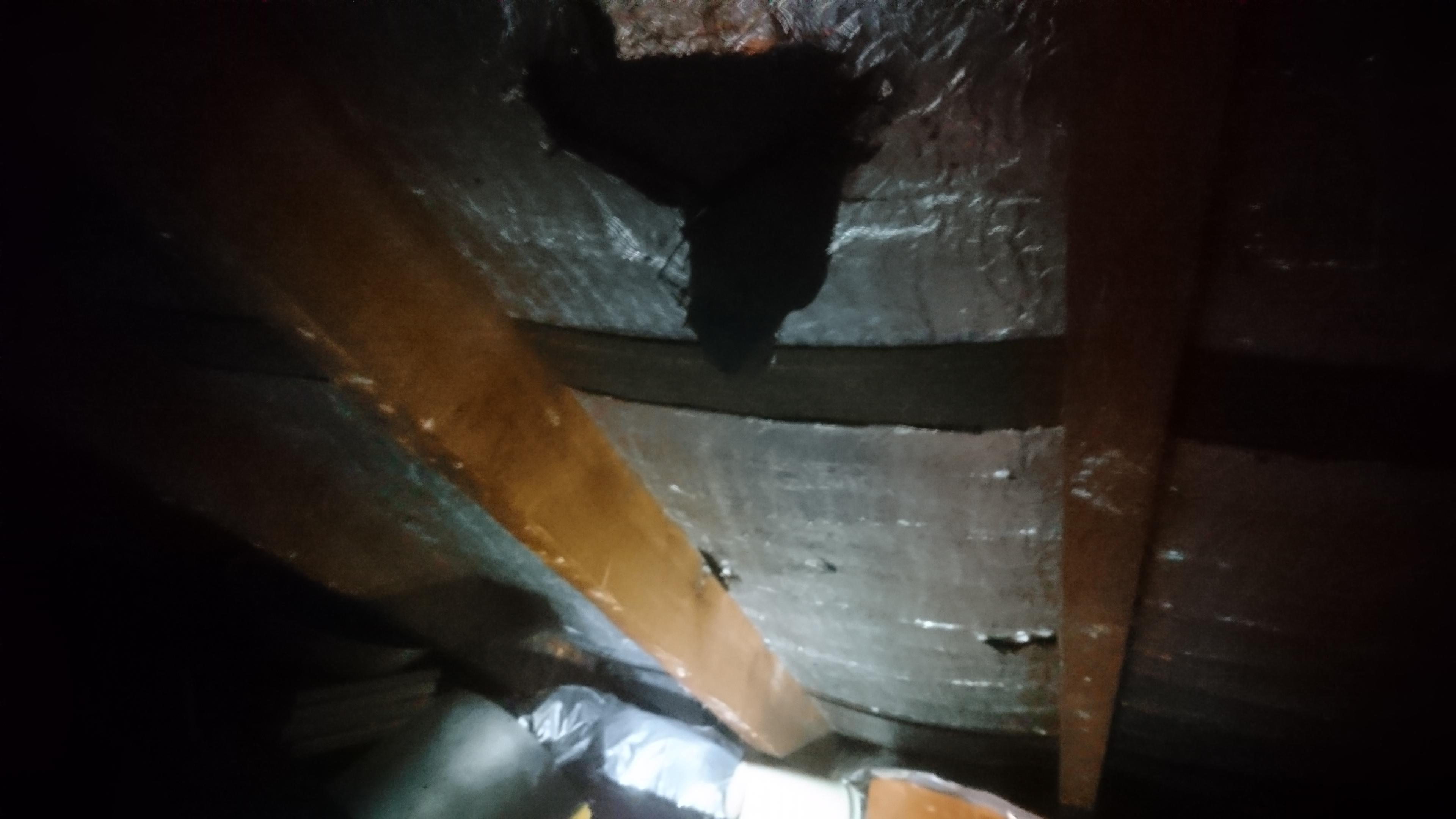

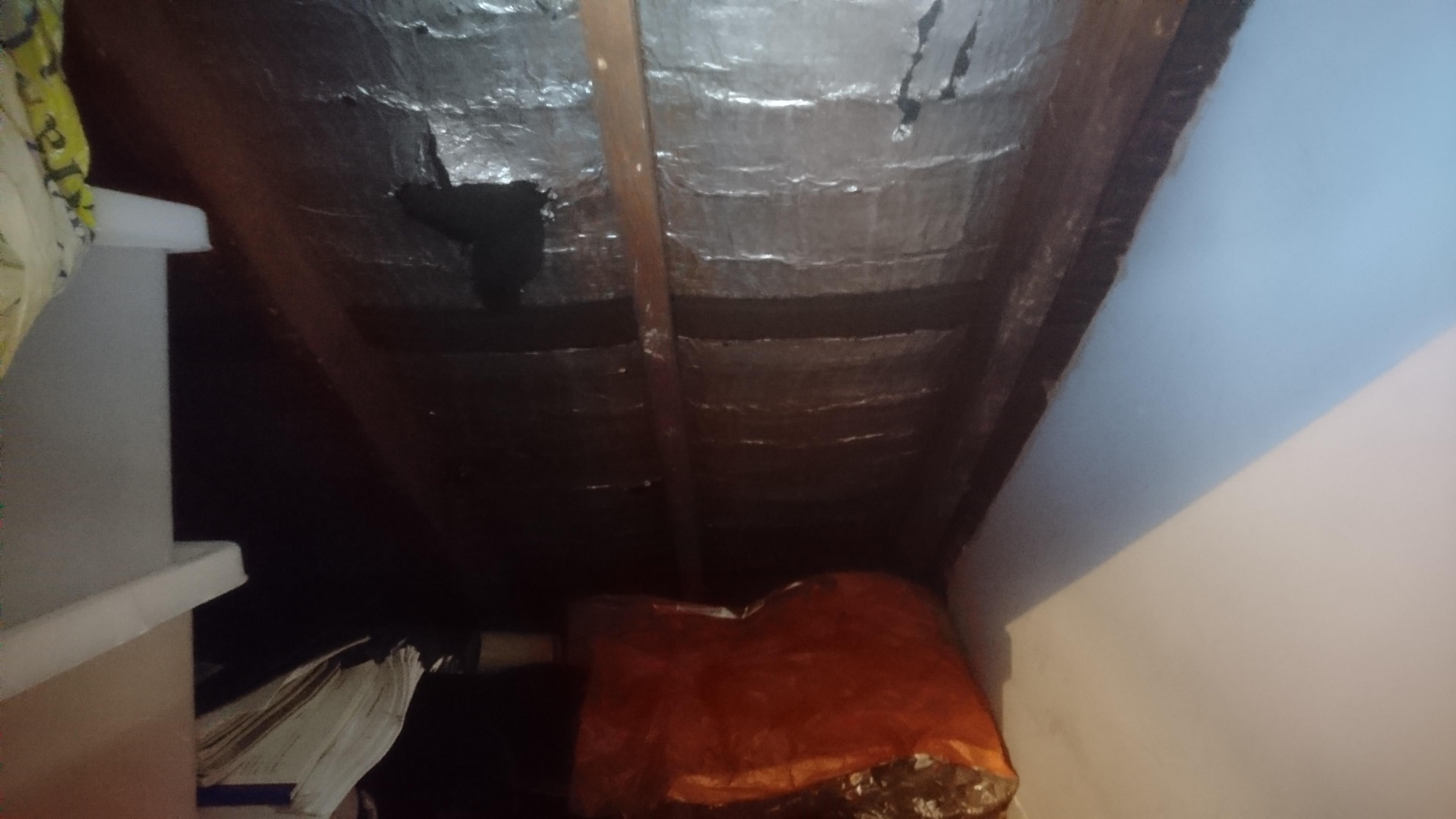

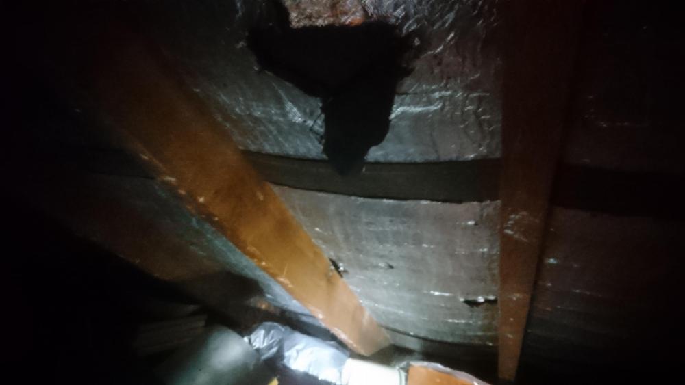

Post some pictures of the roof and what you are trying to do.
I think spray foam properly applied in a new build is okay.  The issue with mortgages is an old roof, with no under felt, and spray foam applied from the inside as a "fix" makes the roof completely un repairable as the tiles are stuck by the foam,. so in the event of any repairs then being needed it is a new roof required.
Right, I had assumed their problem was because they had a moisture concern regarding the roof timbers but you seem to be suggesting it might be the fixity to the roof covering itself that is their problem.
I am trying to add a decent amount of insulation that is protected from wind wash and at the same time improve the airtightness.
