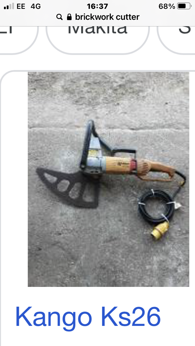

nod Posted February 14, 2021 Posted February 14, 2021 Smiths hire have a cutter for this I’ve used them for removing face bricks for cavity trays Quicker and cleaner than a grinder and you can use the bricks again About 50 quid for a day

phatboy Posted February 15, 2021 Author Posted February 15, 2021 Thanks everyone! @scottishjohn makes a good point about time spent, and i don't think I could handle 3 solid days of cutting the holes! When we get to trial holes we will find out if there is enough space for an extra wall. If not, then will need to re-assess! Will see if the cutter @nod mentions is available locally, although I cannot find it on Smiths Hire site, as an option.....
