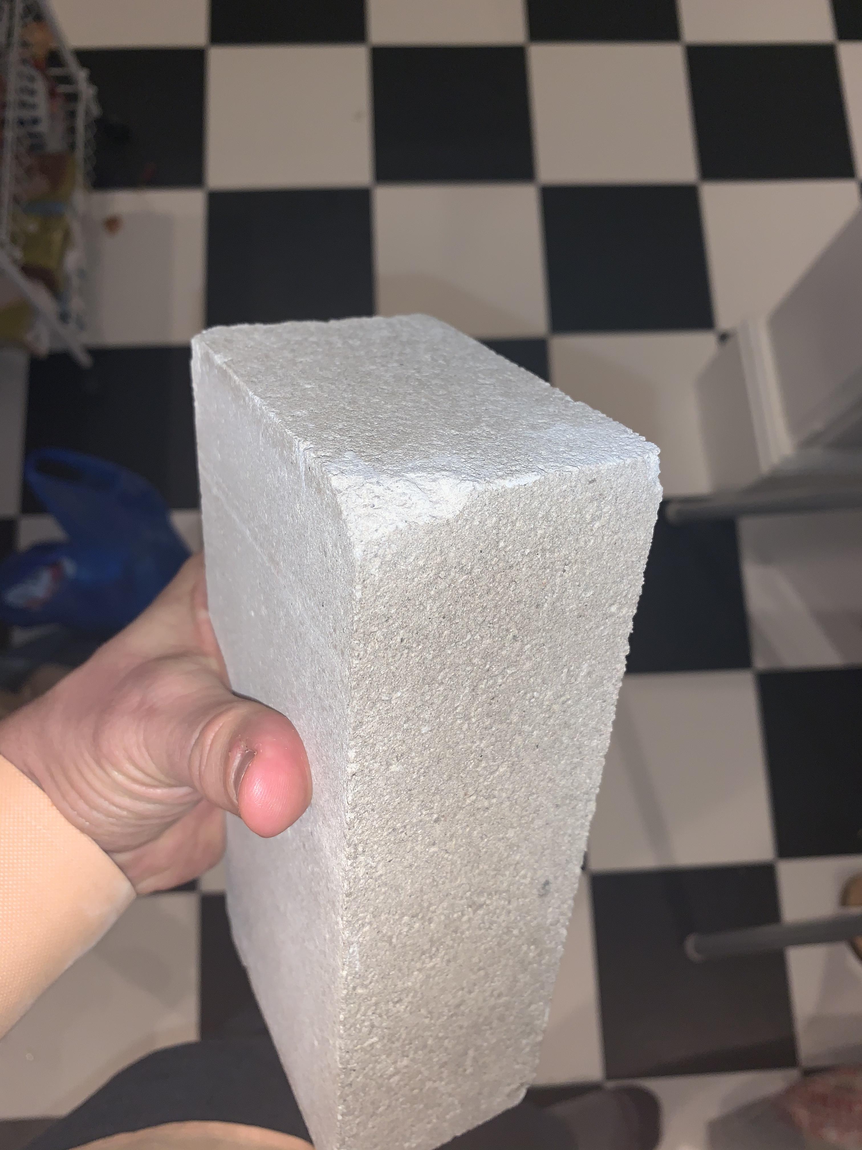

Adsibob Posted February 11, 2021 Share Posted February 11, 2021 I’m about to order about 2800 facing bricks for our extension. After much searching, its come down to this brick (pictured). However, two things are concerning me: first, is it normal for bricks to crumble slightly at the edges/corners before they have even been handled very much? This brick was sent to me by the manufacturer wrapped in bubble wrap, by fedex, as a free sample, together with two others which were also individually wrapped in bubble wrap. On taking the brick out of the wrapping it looked to be in mint condition, but just taking the brick from one room to another and looking at it in different light it has somehow started to crumble. second, why is the facing side of the brick slightly darker than the top side (the top side being the side upon which my thumb is resting)? I asked the salesperson about this and she replied “as with every single brick on the market place all bricks only ever guarantee one good header and one good stretcher; the bricks are not coated or varnished with any coatings that is the natural finish of the facing brick” but it really doesn’t make sense to me why it looks slightly darker as if it has had some sort of sealant applied to it. I prefer the lighter side, so I’m almost tempted to lay them on their sides, but that is probably a recipe for disaster. Link to comment Share on other sites More sharing options...

Russell griffiths Posted February 11, 2021 Share Posted February 11, 2021 Bricks are fired by being put in a kiln, depending on how they are stacked I would say they will all have a variety of colours. If you are after them all looking identical I think you need to look for a better quality product. Link to comment Share on other sites More sharing options...
Adsibob Posted February 11, 2021 Author Share Posted February 11, 2021 7 minutes ago, Russell griffiths said: Bricks are fired by being put in a kiln, depending on how they are stacked I would say they will all have a variety of colours. If you are after them all looking identical I think you need to look for a better quality product. Helpful, thanks. What about the crumbling corner/edges? Link to comment Share on other sites More sharing options...
Russell griffiths Posted February 11, 2021 Share Posted February 11, 2021 3 minutes ago, Adsibob said: Helpful, thanks. What about the crumbling corner/edges? Poor quality??? looks like something called a sandlime. Is it sold as a facing brick, does it have a weather resistant rating. Link to comment Share on other sites More sharing options...

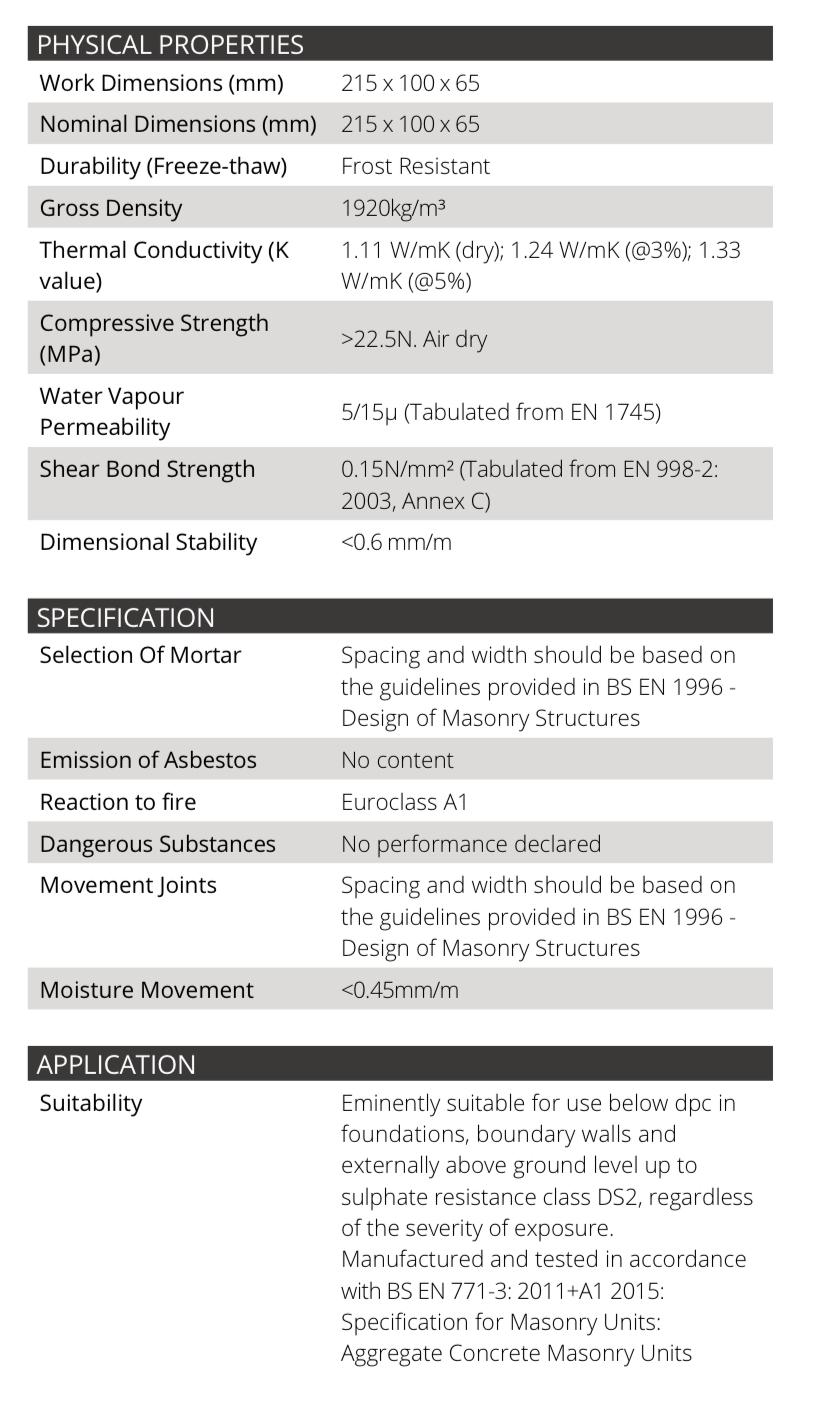

Adsibob Posted February 11, 2021 Author Share Posted February 11, 2021 17 minutes ago, Russell griffiths said: Poor quality??? looks like something called a sandlime. Is it sold as a facing brick, does it have a weather resistant rating. Yes, it is meant to be a facing brick. Not sure what you mean by weather resistant. It is marketed as frost resistant. here are specs: Link to comment Share on other sites More sharing options...
Vijay Posted February 11, 2021 Share Posted February 11, 2021 Maybe they sent you a damaged one as it was just a sample?? Link to comment Share on other sites More sharing options...
epsilonGreedy Posted February 11, 2021 Share Posted February 11, 2021 Facing brick specs usually quote "F2" and I cannot see that in your spec. Also no maximum water absorption percentage is quoted, something near 15% is typical. Are you sure these are fired bricks as opposed to bricks formed from a concrete type mush that chemically sets. Link to comment Share on other sites More sharing options...
