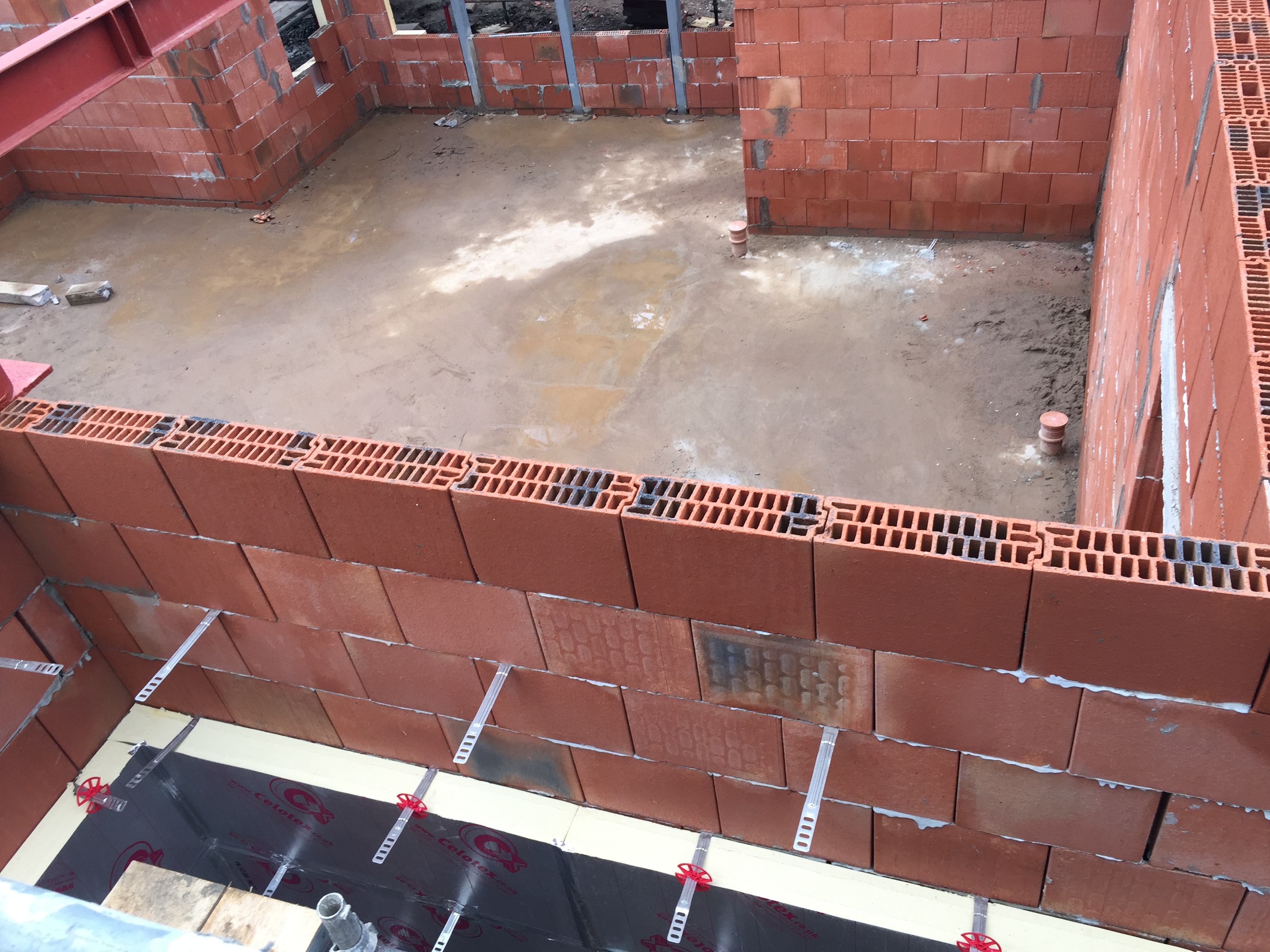

AliG Posted February 6, 2017 Share Posted February 6, 2017 (edited) Scared to start this. The builders started to put the Celotex on the outside of the inner leaf last week. There are plastic ties which should hold it close to the Porotherm blockwork, But I noticed a couple of pieces were maybe 2cm away from the blocks. I have asked the builder to tape all the joints and the cavity is not ventilated so it should be pretty hard for air to blow behing the insulation. In this scenario do you think the gap materially affects the U-value or as long as the air cannot move does it not make a difference? There will also be insulated plasterboard on the inside walls which means there will be some insulation everywhere no matter what. FYI Wall build up is - 20mm render, 100mm porotherm, 50mm cavity, 100mm Celotex CW4000, 100mm porotherm, parge coat, dot and dab 37.5mm insulated plasterboard, plaster skim Thanks Edited February 6, 2017 by AliG Link to comment Share on other sites More sharing options...

AliG Posted February 10, 2017 Author Share Posted February 10, 2017 I went up today and had a good look around at the insulation. The vast majority is tight up against the wall and looks pretty neat. The main issue seems to be on outside corners and at the ends of runs and I have asked them to seal these off. I think this looks tight enough? 2 Link to comment Share on other sites More sharing options...
