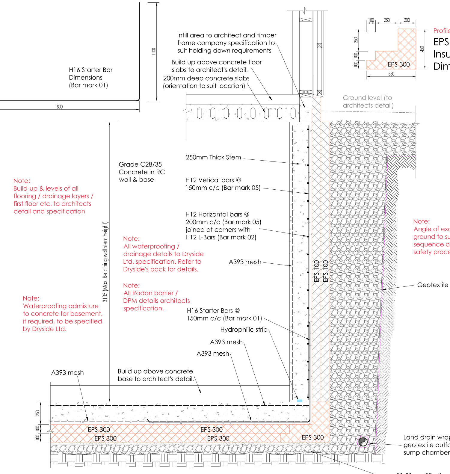

will do on all that. here's the detailing by Tanners showing the insulation. I'll make sure it's built to these specifications.

Whats your plan for that corner section? If the crew are doing traditional shuttering then can you just lay the 300 flat and butt the 100 vertically on the edge?
Also are 200mm sheets cheaper / more expensive than two 100mm sheets?
Tanners designed a Kore system but (see other threads on this subject) I've had issues with them being able to deliver to an individual since Brexit so I've kind of dropped them for now. as such I believe the groundworks company would do as you suggest but as I'm still at the decision stage for choosing a groundworks company those details can be had once that decision has been made.
thanks for the tip about 200mm sheets being cheaper. appreciated.
