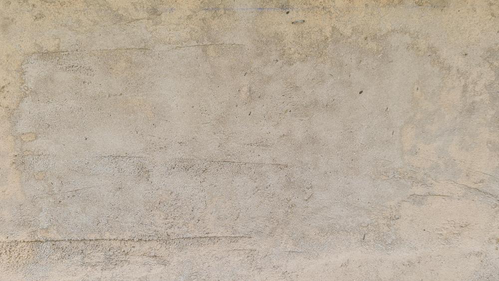

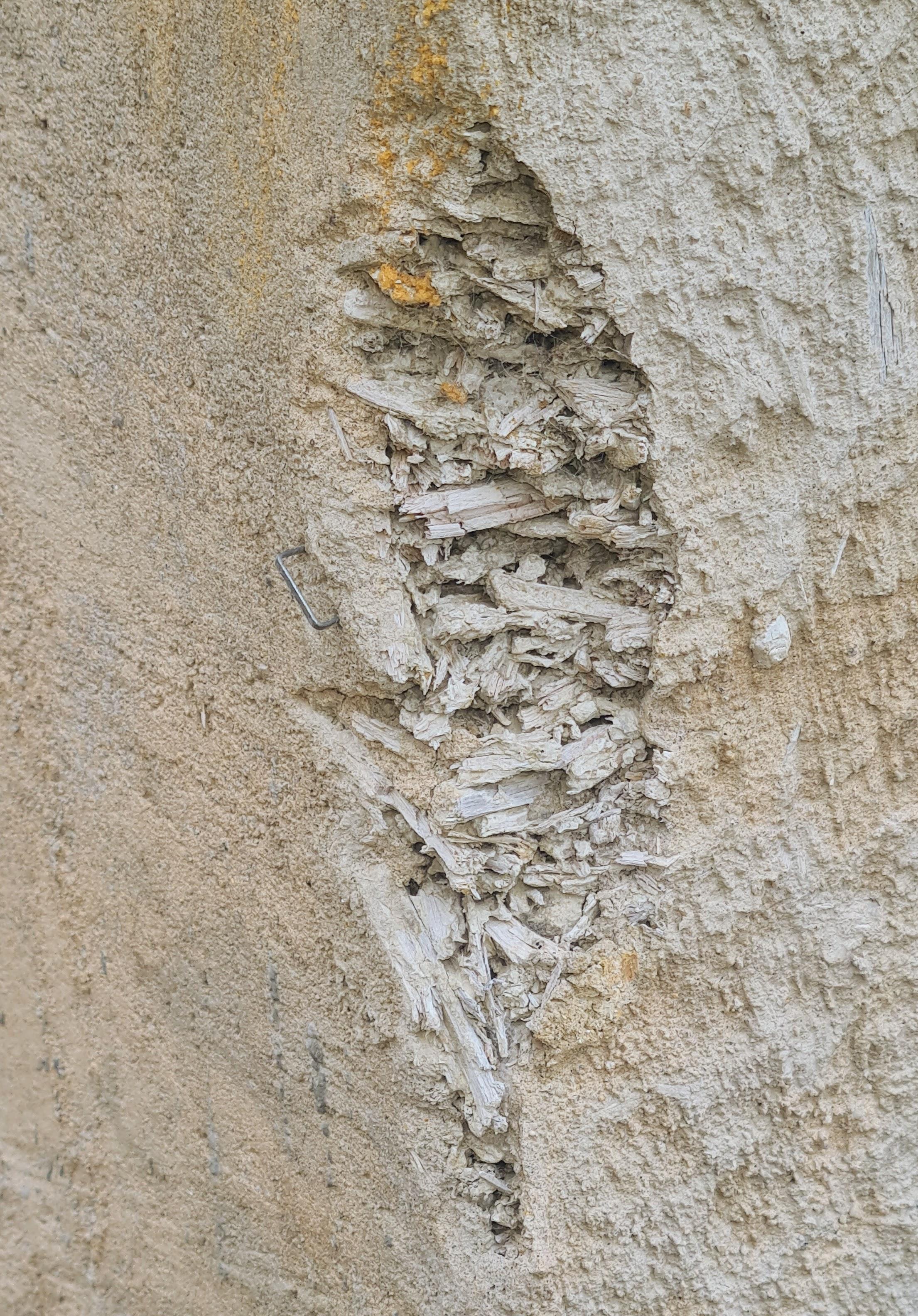

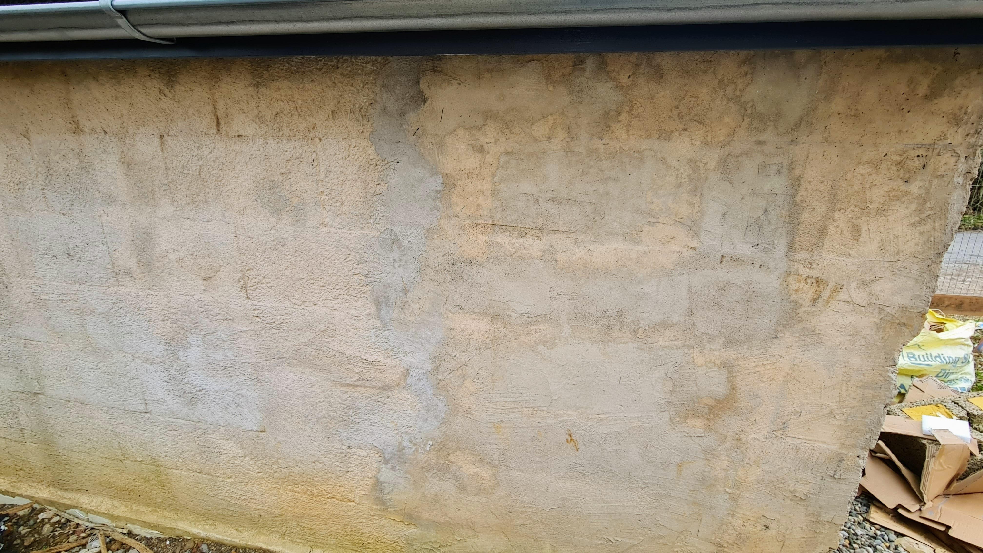

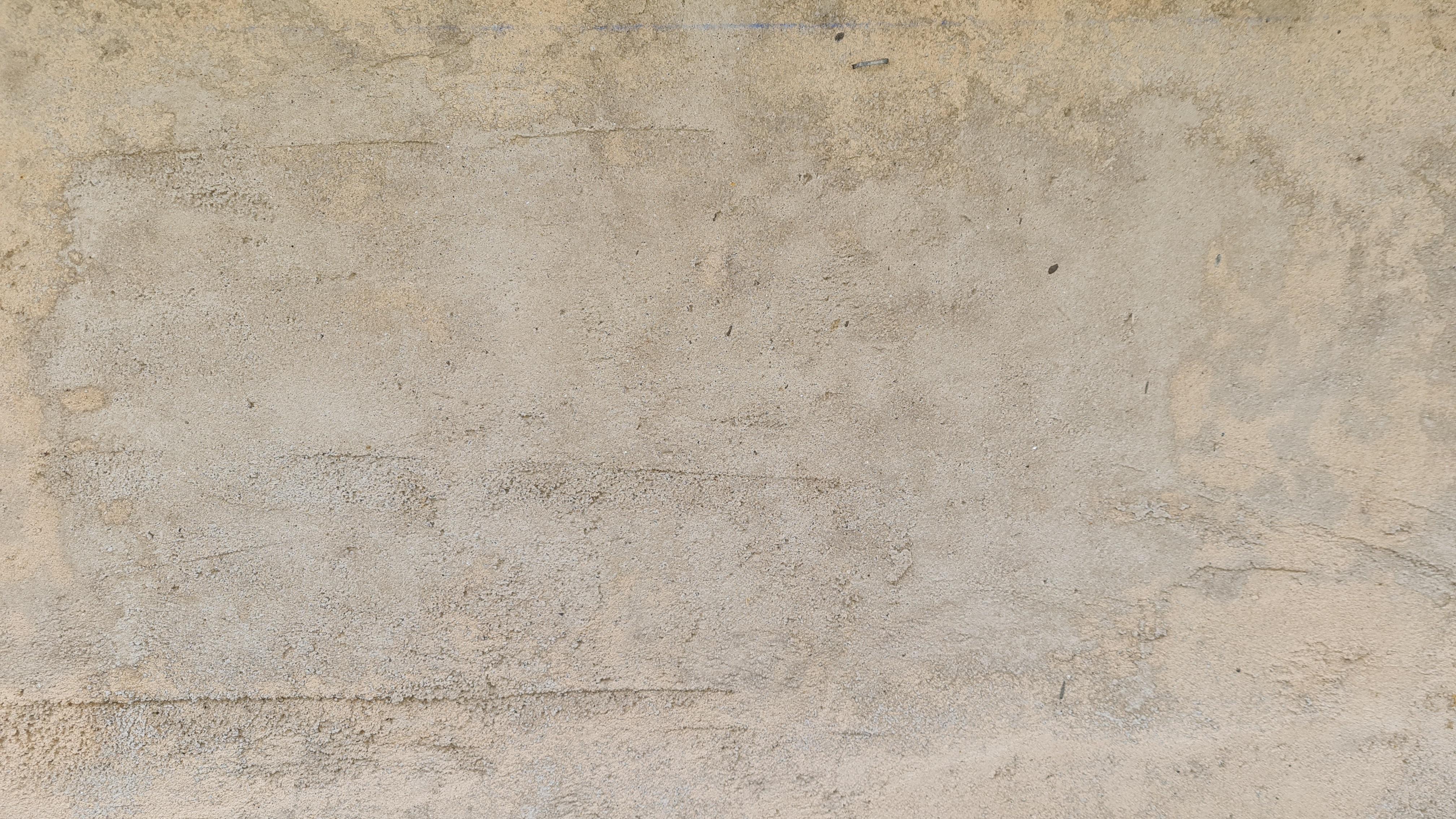

I got a PM from a member who is about to parge his Durisol build.  On my build, as usual, I had never done this before. So this is a brief review of what, how, when .... and mostly it demonstrates yet another steep learning curve.
Here's what I wrote about it at the time

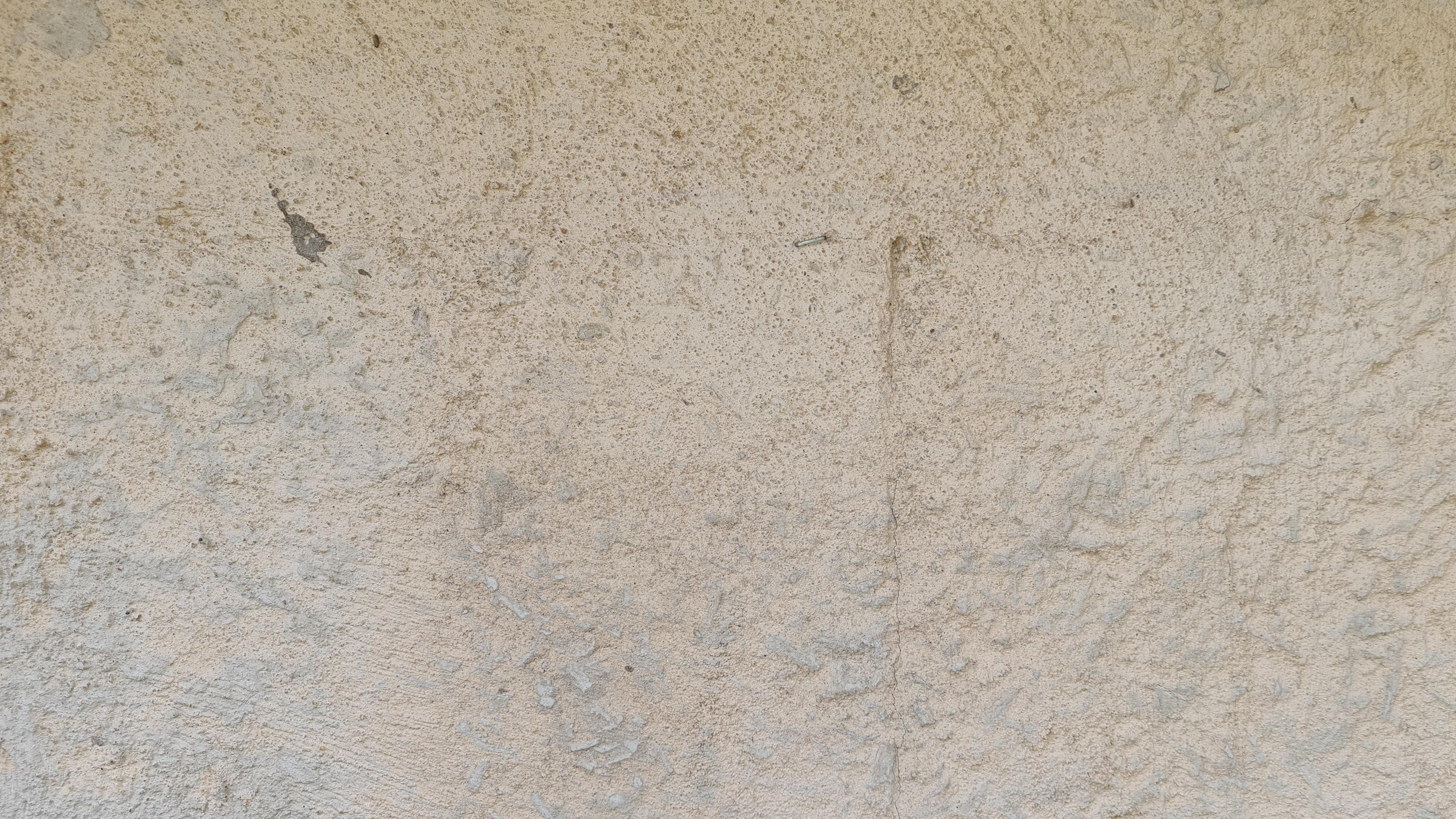

And this is the result ; each photo has a brief annotation to help explain.
This photo shows two levels of parging - the RHS parging is thicker, much thicker than the LHS. You can hardly see the blocks

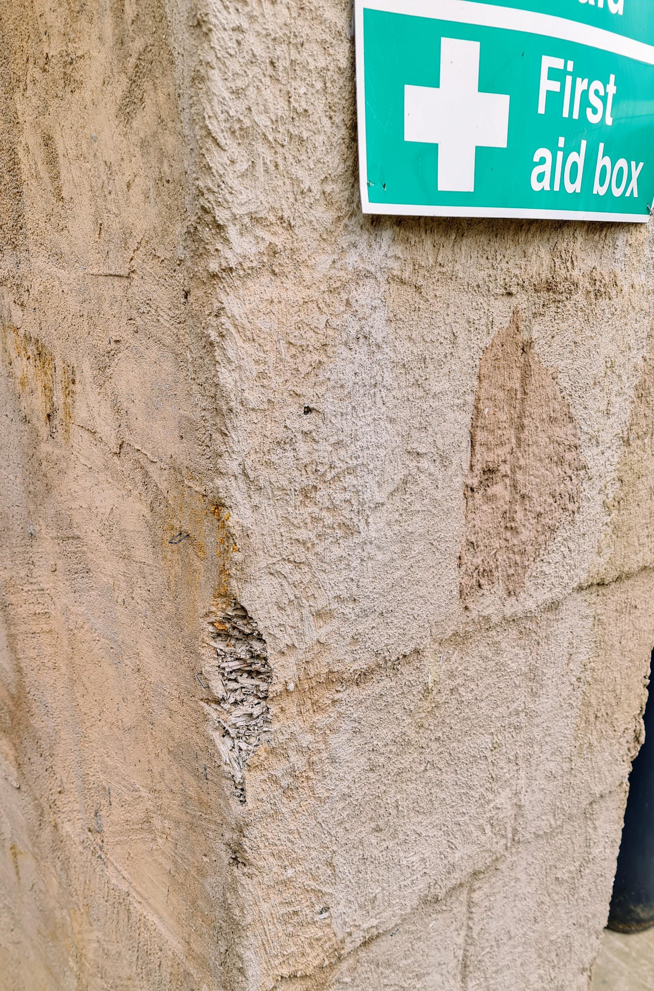

I've chosen this photo (of the damaged corner) because it shows clearly the difference in thickness in coating: LHS much thicker
Here's the spiel about rendering and airtightness  : thing is from experience, I don't think you can get airtightness out of the parge coat alone : well, I can't anyway. Much more airtightness might well be provided by the following covering ( in our case ) Clober Permoforte Quattro. And, at that price, it should provide that. It's excellent by the way.
Put an  good plaster coat inside and you're well on the way to a decent breathable, airtight wall.
Thing is - what happens in way of (behind) the wall plates. I think I've missed a trick there.
Here's the point: I should have made the coating thicker.
