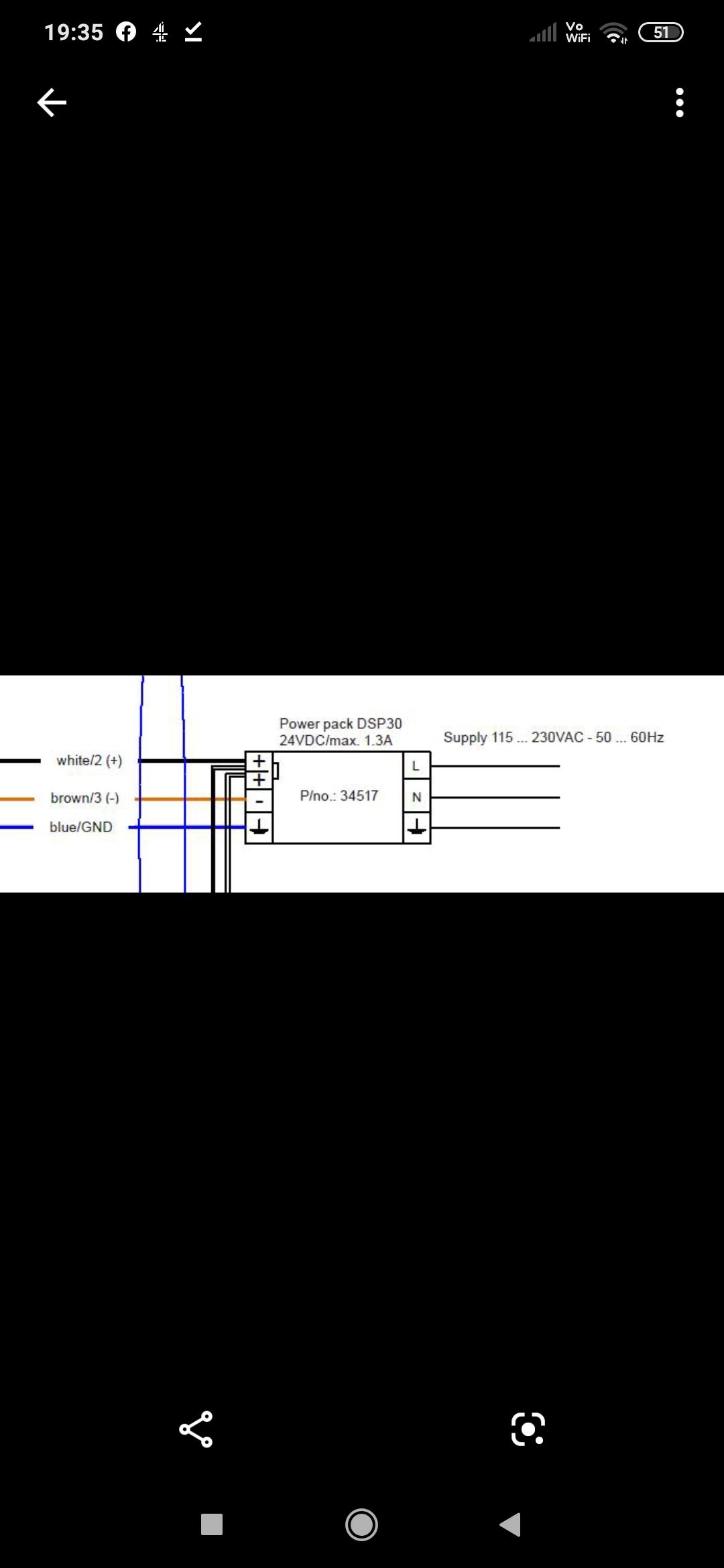

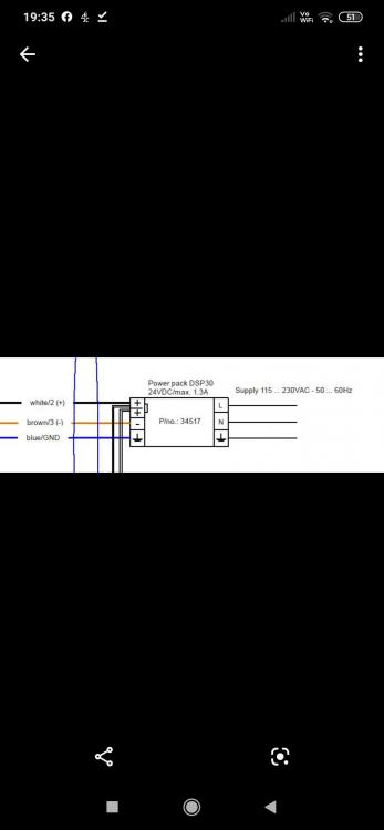

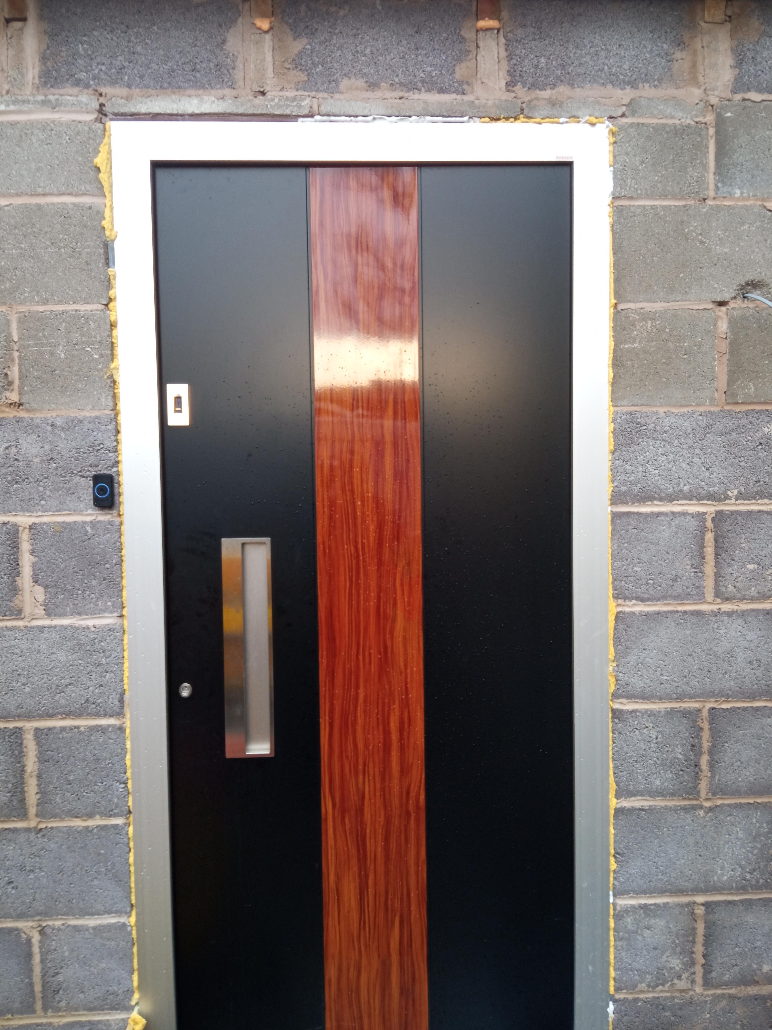

canalsiderenovation Posted January 26, 2021 Posted January 26, 2021 Can anyone advise where I can get a transformer suitable for our Internorm front door fingerprint sensor. They have sent through a wiring diagram but I'm not sure exactly what transformer is needed. Can anyone point me in the direction of where I can get what is on the diagram please. Ta
TonyT Posted January 26, 2021 Posted January 26, 2021 https://www.amazon.co.uk/Din-Rail-Power-Supply-MeanWell-NDR-120-24/dp/B07BFCCPVB/ref=mp_s_a_1_9?adgrpid=53928596875&dchild=1&gclid=EAIaIQobChMI5-TvwK267gIVDLTtCh30owr2EAAYAiAAEgJ2EvD_BwE&hvadid=259150435849&hvdev=m&hvlocphy=9046870&hvnetw=g&hvqmt=e&hvrand=17678314962473593575&hvtargid=kwd-298956512635&hydadcr=16905_1776277&keywords=24v+dc+power+supply&qid=1611690109&sr=8-9&tag=hydrukspg-21You so the drawing says 24vdc 1.3 amp. so any 24vdc transformer with a higher rating of 1.3amp. Will work. you could get cheaper that comes with a plug like a laptop plug, cut the end off, and connect up, but you would need a multimeter to prove polarity. 1
TonyT Posted January 26, 2021 Posted January 26, 2021 https://uk.farnell.com/tdk-lambda/dsp30-24/psu-din-rail-24v-31-2w/dp/1456481 Or the correct model if you Google the numbers written on the drawing 1

canalsiderenovation Posted January 26, 2021 Author Posted January 26, 2021 On 26/01/2021 at 20:02, Onoff said: Or this, nice and cheap: https://uk.rs-online.com/web/p/din-rail-power-supplies/1368308/ You might want a bit of DIN rail to mount it. Shout if need a short length. Expand Is there any difference between this and the ones @TonyT linked to or are they the same thing?
canalsiderenovation Posted January 26, 2021 Author Posted January 26, 2021 Thanks both. Ordered the cheaper version. Thanks for the offer of DIN rail. We have some thanks. Not quite sure where it is going yet nor how we are going to disguise it. @Onoff

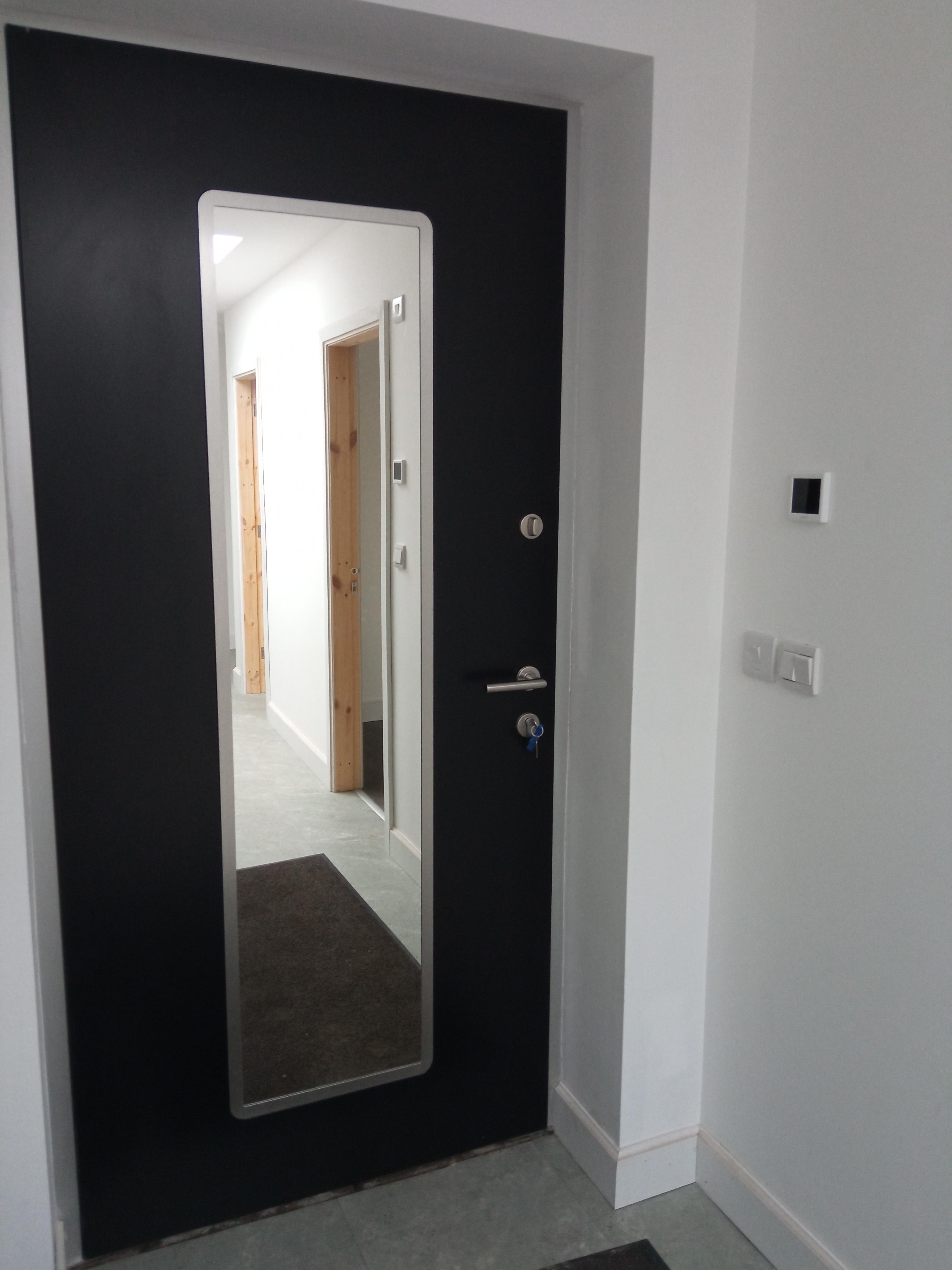

Onoff Posted January 27, 2021 Posted January 27, 2021 On 26/01/2021 at 21:56, canalsiderenovation said: Thanks both. Ordered the cheaper version. Thanks for the offer of DIN rail. We have some thanks. Not quite sure where it is going yet nor how we are going to disguise it. @Onoff Expand Huh? You mean it's not going in a control cabinet of some sort with wires running to the sensor? A photo of the area might assist with any adjacent plug socket etc.
Onoff Posted January 27, 2021 Posted January 27, 2021 On 26/01/2021 at 22:10, canalsiderenovation said: Blew my brain a bit.... ? Expand What Tony's getting at is with the plug in type, you would potentially take the plug-in adapter and cut the plug off on the right hand side. (Whilst it's unplugged!) You would then pare back the end of the black cable by stripping it and exposing the two inner cores. With a test meter you'd next identify the polarity as in which wire is + and which -. Suitably make off the ends by say tinning with solder or putting on some ferrules (neither strictly necessary but good practice). You'd then need to connect to your sensor unit and plug in / switch on. Of course you'd need to hide the cable. That could be in surface trunking at it's simplest/ugliest. Any decent cavities adjacent to the area that you could get power to? Up in the ceiling and down etc? It's all in the planning...or not! ? 1
TonyT Posted January 27, 2021 Posted January 27, 2021 Probably best to keep it near the door as much as possible to reduce any volt drop to the lock mechanism, depending on what type of lock, it could draw more current. 1

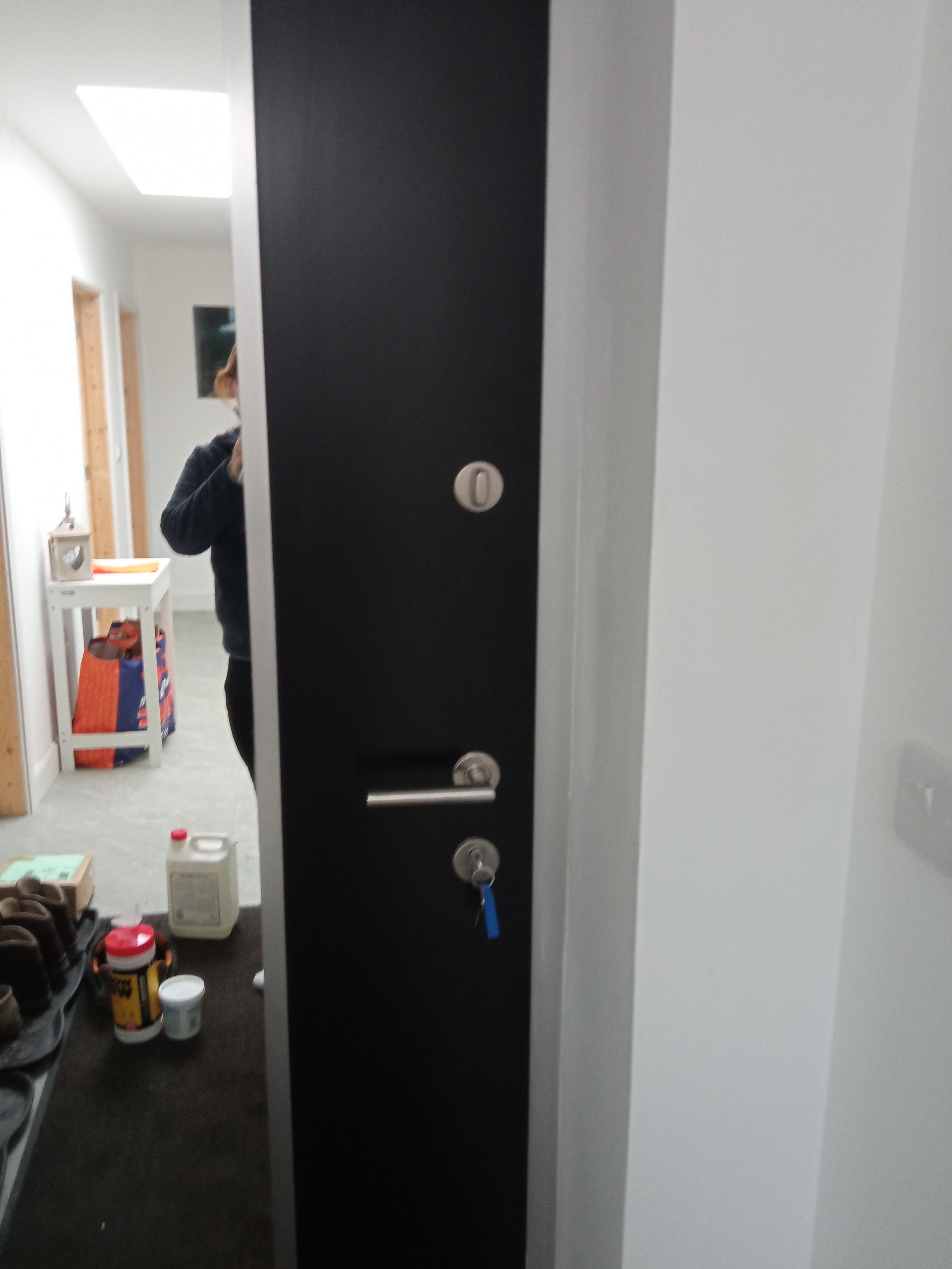

canalsiderenovation Posted January 27, 2021 Author Posted January 27, 2021 (edited) On 27/01/2021 at 06:24, Onoff said: It's all in the planning...or not! ? Expand I know! Frustratingly we have been going on about this ever since the door got put in and saying about the fingerprint sensor and location and we are a bit pi**ed off it wasn't done at the stage it could have been hidden in a cavity. Just want to get the thing working, get the house completed in that the snags and the building work is done and when lockdown is over get my uncle who is an electrician but not local to come and sort a couple of post work issues out which may include hacking into walls. They aren't properly decorated as we just had it cheaply sprayed white and no woodwork has been painted yet so we need to gradually work through each room when money permits..... An example of one of our oops issues being going to wall mount a TV in a guest room so having high socket to find it actually would be better on a cabinet so we need a low socket. I did tell the other half this so I'm not taking the blame for this one. Edited January 27, 2021 by canalsiderenovation
Onoff Posted January 27, 2021 Posted January 27, 2021 It is probably not want you want at all but you can get access panels like this: https://www.screwfix.com/p/manthorpe-access-panel-white-243-x-193-x-16mm/20924? https://www.amazon.co.uk/Manthorpe-GL100-Plastic-Access-Inspection/dp/B00TYNQTPY/ref=sr_1_2? This type is "decoratable": https://www.amazon.co.uk/Secret-Access-Panel-Door-300mm/dp/B00I9ZSDFW None are really invisible per se. Maybe make a feature of it, cover with a picture of your dogs etc! ? You could.....maybe mount a 2 gang faceplate, spray painted black or whatever next to the lock as access to the cavity. Just cut the back out of a dry lining box. Whatever, the connections to that psu need to be secure and it needs to remain accessible.
TonyT Posted January 27, 2021 Posted January 27, 2021 Do you have a cupboard near the front door? is there a control box or is everything integral to the finger print/intercom external unit? what kind of locking mechanism are you using? Something in the door or in the frame? if you let us know a make/model I’m sure we can offer some more advice to make it easier for you.

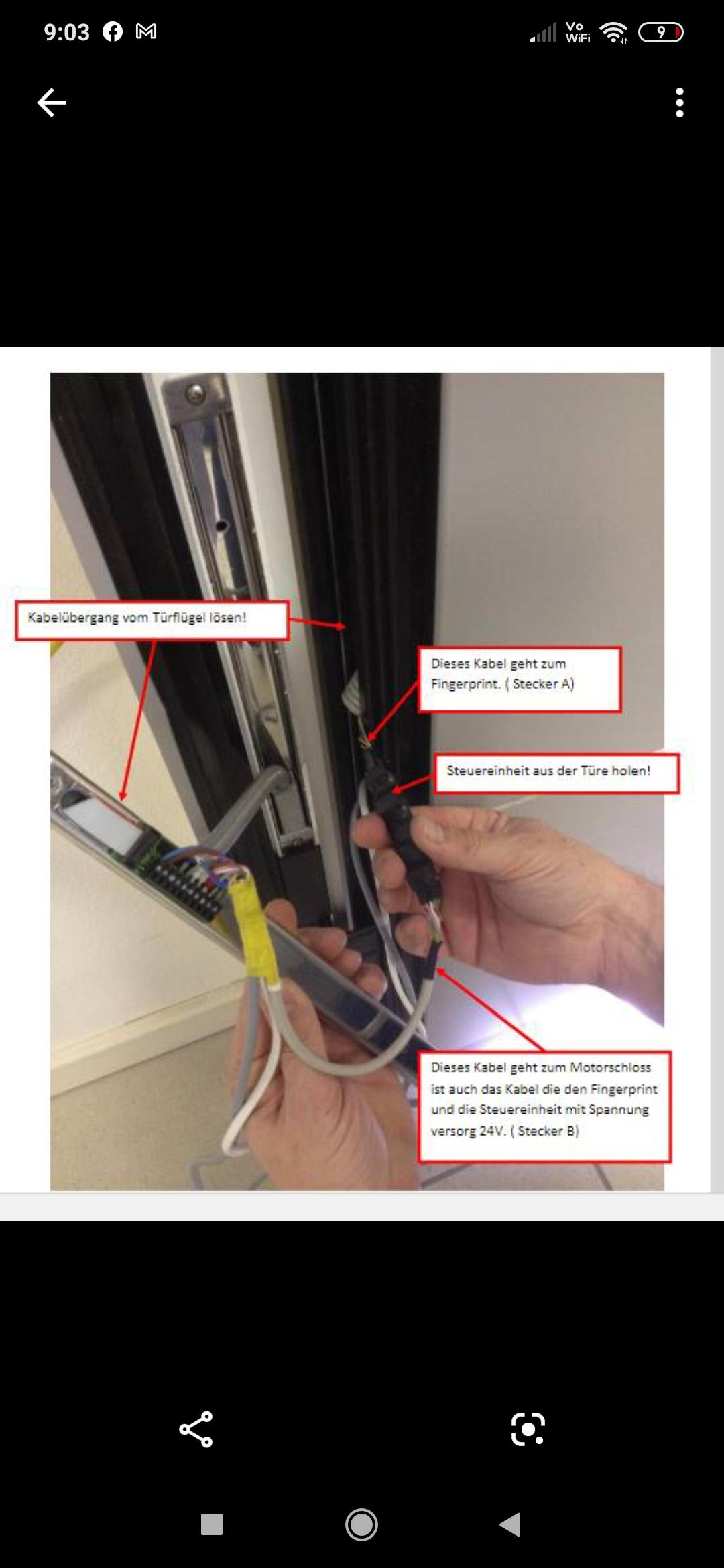

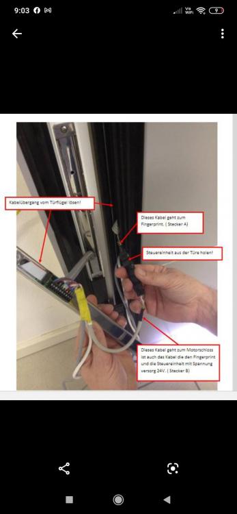

canalsiderenovation Posted January 27, 2021 Author Posted January 27, 2021 (edited) Thanks both. It's an Internorm front door with fingerprint sensor. I've had contact with a very helpful guy in Austria at Internorm who sent through lots of info and we have the manuals ready to set it all up. Some info they sent. I believe everything is in the frame itself as this is where all the wires were. I also think we don't have studded walls rather it is blocks (other side is a bathroom). No cupboard etc. There is a fuse button so think this is for the front door. The little screen is a thermostat. 4_1_5_Electrical connection plans - ENGLISH.pdfFetching info... Also see file attached. Edited January 27, 2021 by canalsiderenovation
TonyT Posted January 27, 2021 Posted January 27, 2021 Do you have a conduit in the door frame to take the cable away? Transformer has to be within 8 metres max of door cabling. What happens when power fails does it lock secure? Any plans to fit a UPS? Is it just a split handle, so that from the secure side the door opens on the handle, with no push to exit button required?
canalsiderenovation Posted January 27, 2021 Author Posted January 27, 2021 On 27/01/2021 at 09:19, TonyT said: Do you have a conduit in the door frame to take the cable away? Transformer has to be within 8 metres max of door cabling. What happens when power fails does it lock secure? Any plans to fit a UPS? Is it just a split handle, so that from the secure side the door opens on the handle, with no push to exit button required? Expand Yep we have a manual lock as well with key. It may be we just get one of those box things @Onoff suggested. Not idea but solves a problem.

TonyT Posted January 27, 2021 Posted January 27, 2021 So imagine your plasterboard wall. with the plasterboard access hatch You could glue a double surface pattress to the rear of the plasterboard to make all the extra low voltage connections nice and safe, you could fix a switched spur for local isolation and fusing down for the mains power and then connect up the power transformer to this. this could keep everything tidy and reasonably managed to make it easy to maintain. 1
