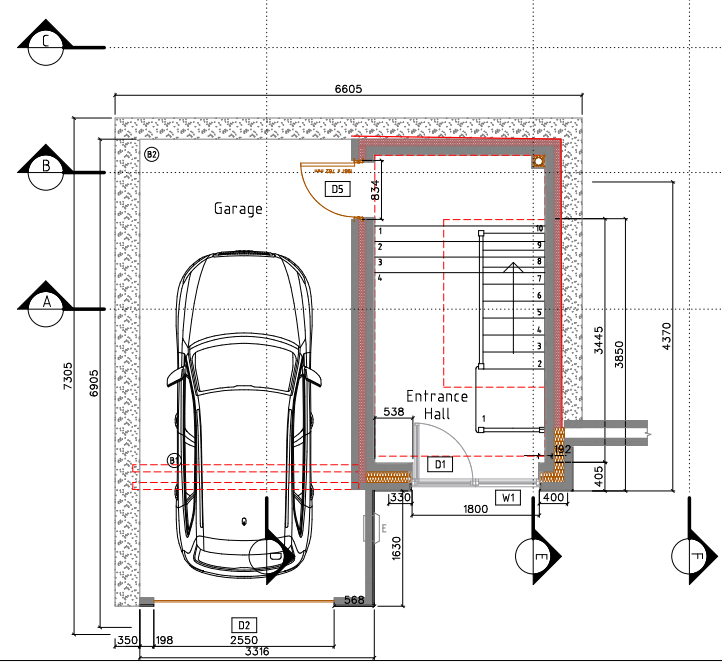

Moonshine Posted January 26, 2021 Posted January 26, 2021 (edited) Has anyone used waterproof concrete (Type B) for waterproofing of a new basement? https://www.sikawaterproofing.co.uk/products-systems/sika-watertight-concrete/ I am looking at this a a possible solution for a semi basement as one level of waterproofing to meet Grade 3 conditions. There is a 60% uplift in material costs of waterproof concrete cost over standard, but it could save a load of material cost and labour to putting a Type A barrier on the external side of the retaining wall. Any experience? Edited January 26, 2021 by Moonshine

Moonshine Posted January 26, 2021 Author Posted January 26, 2021 45 minutes ago, Bitpipe said: I used this exact system. BCO and warranty provider accepted it as a single method of protection. Who was your warranty provider? It would be great if I could get away with single method of protection, though the habitable space in the basement is limited to about 7m of retaining wall and may install a type 3 system in here just to make sure. Did you put a geodrain or similar on the outsite of the retaining wall? The ground investigation of the site found no ground water within any boreholes to depths down to 40.70m, and the lowest proposed raft is located at 42m, The groundwater levels in the area (sample point 7km from the site) are circa 26m. 46 minutes ago, Bitpipe said: The shuttering design needs to allow for a recess / channel in each cast section to hold the waterbar and the team were diligent at making sure that was clean and dry. They also designed a 150mm high kicker as part of the slab pour with a recess in the centre of that. The retaining wall isn't going be a shuttered wall but a probably a reinforced concrete block (100mm) work retaining wall (total thickness 350mm), with 150mm concrete filled cavity, hopefully with sika waterproof concrete.

Moonshine Posted January 28, 2021 Author Posted January 28, 2021 On 26/01/2021 at 15:33, Mr Punter said: I think an issue may be that you cannot inspect the concrete of the join at the floor / wall / kicker junction so SIKA are unlikely to guarantee this. In my opinion, if you are made to use type C anyway, you may as well save your money and just use normal concrete. 12 hours ago, mvincentd said: I think you'll find Sika want their concrete thickness at 200mm minimum to guarantee its waterproofness (is that a word). If your blocks only have 150 cavity i'd think thats a problem even before addressing the fact the cavity can't really be continuous...can it? You are right, i have spoken to SIKA and they a reinforced concrete retaining wall with a minimum thickness of 175mm designed to maximum crack width or 0.3mm. They want to be able to inspect the concrete once poured which they would not be able to do if its behind a blockwork wall. Two options going forward i think - Cavity filled blockwork retaining wall with Type A barrier to exterior, and Type C to internal habitable spaces. - cast in situ retaining with Type B barrier (waterproof concrete), and Type C to internal habitable spaces.

Bitpipe Posted January 28, 2021 Posted January 28, 2021 On 26/01/2021 at 23:36, Mr Punter said: I can't say I am a fan of below ground basements and I can see why the warranty guys want 3rd party warranties to escape any liability! 5 years in and our basement has never had any issues - any system will work provided it's properly specified and installed. But any waterproofing system that is not independently, insurance backed, warrantied should be avoided as if it fails, you'll be responsible. 1 hour ago, Moonshine said: - Cavity filled blockwork retaining wall with Type A barrier to exterior, and Type C to internal habitable spaces. - cast in situ retaining with Type B barrier (waterproof concrete), and Type C to internal habitable spaces. Given your ground water levels are so low, I'd forget type C. You will have pumps that will not be in use but will still require testing and eventual replacement plus monitoring systems for failure etc. Any water ingress risk is going to be from rainfall pooling at the foot of your slab so ensure you have a robust perimeter drainage solution - land drain to soak away at the appropriate depth - and specify backfill with clean stone. Go for A as your main barrier (get a decent warrantied system) and use basic WPC as your backup.
Moonshine Posted January 28, 2021 Author Posted January 28, 2021 10 minutes ago, Bitpipe said: Given your ground water levels are so low, I'd forget type C. You will have pumps that will not be in use but will still require testing and eventual replacement plus monitoring systems for failure etc. Any water ingress risk is going to be from rainfall pooling at the foot of your slab so ensure you have a robust perimeter drainage solution - land drain to soak away at the appropriate depth - and specify backfill with clean stone. Go for A as your main barrier (get a decent warrantied system) and use basic WPC as your backup. I shouldn't need pumps as its a 3 sided basement and i think that i can get the drainage channel out the front open side and be drained by gravity. Most of the warranty providers seem to want two waterproofing systems, even in the garage area!
