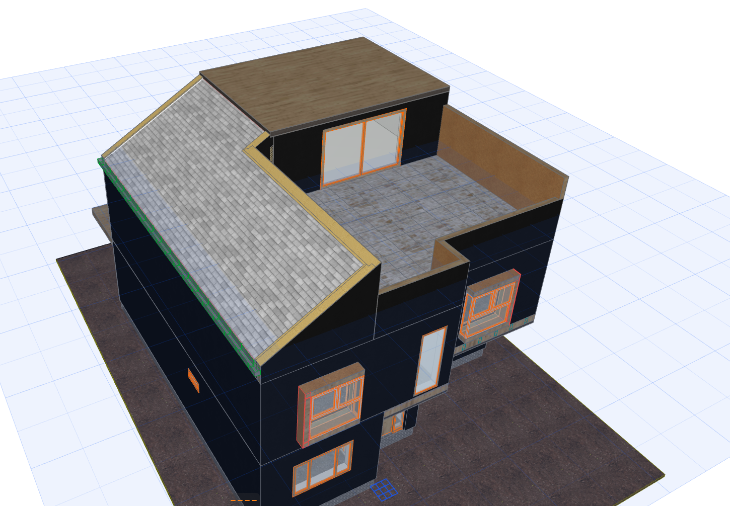

BartW Posted January 24, 2021 Share Posted January 24, 2021 Hi, I am after a bit of advice. I am currently sizing a system for our future home. Current facts: We live in a 2 bed maisonette at the moment. The two of us and a dog Factual 12 month energy use is 3000kWh (Jan '20 to Jan '21, so enough to stipulate 50% daytime occupancy). That is a combination of usual appliances, induction hob, UFH, and plenty of LED mood strip lighting. The current property is 70sq metres. The future: The two of us, and two kids, and (maybe) two dogs Property size 180sq m. Fully detached, 0.15uVal all around Timber Frame home, with all as the above, but also 7kW ASHP, MVHR, very open downstairs, and a total of 4 bedrooms (+gym on the top floor). Also some smart home gear (if money were to allow). Assumed 12month energy use 6000kWh. The following Roof: Assumed 10no 445W panels along the pitched roof (South - tiny-bit-East roof), and 6no 445W panels on the flat roof. All connected up using individual microinverters. No shading. Total 7120W @ 20% panel efficiency x 70% realistic efficiency due to weather, etc gives me 996W per h. If I average 7 hours a day in beautiful Oxfordshire, then there is a potential for 7kWh of energy. Paired with "alleged" 16kWh daily consumption, this is technically not enough to warrant a battery storage, BUT we all know that energy recuperation times are never equal the energy required, due to the lifestyles, and other factors. Take for example washing machine, and tumble dryer. These would usually work evening, or weekends. Would the battery storage help with the "energy management"? If so, would a 7kWh choice be optimal? I can only imagine that anything bigger would never get fully charged, unless we are on holiday. So with the above in mind, I can probably build a 7kWh PV with 7kWh battery for not a lot more than £7k + VAT. Am I being logical? Or a bit naive? Many thanks on this freezing mid Winter Sunday Bart Link to comment Share on other sites More sharing options...

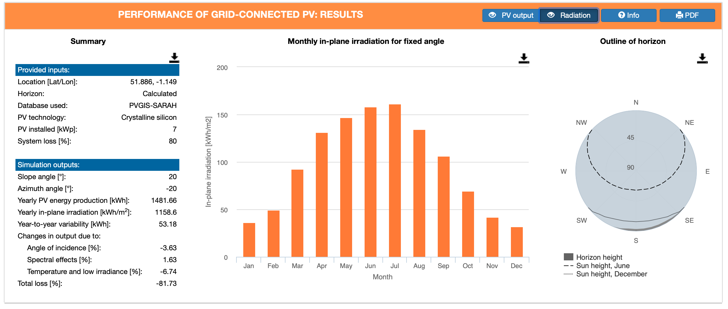

SteamyTea Posted January 24, 2021 Share Posted January 24, 2021 (edited) Go to PV GIS and see what the calculator works it out as. https://re.jrc.ec.europa.eu/pvg_tools/en/#PVP Edited January 24, 2021 by SteamyTea Link to comment Share on other sites More sharing options...

BartW Posted January 24, 2021 Author Share Posted January 24, 2021 5 minutes ago, SteamyTea said: PV GIS That suggests I would produce 1500kWh per year. Which is a 1000kWh less than my brief calculation. Link to comment Share on other sites More sharing options...

SteamyTea Posted January 24, 2021 Share Posted January 24, 2021 Just now, BartW said: That suggests I would produce 1500kWh per year. Which is a 1000kWh less than my brief calculation. Well assuming 70% of 20% is optimistic. As you are putting some of it on a flat roof, you get a lower yield than on a pitched roof. Link to comment Share on other sites More sharing options...
ProDave Posted January 24, 2021 Share Posted January 24, 2021 2 minutes ago, BartW said: That suggests I would produce 1500kWh per year. Which is a 1000kWh less than my brief calculation. My 4kW with a LOT of shading generates way more than that, so you must have done something wrong for 7kW Link to comment Share on other sites More sharing options...
BartW Posted January 24, 2021 Author Share Posted January 24, 2021 Just now, ProDave said: My 4kW with a LOT of shading generates way more than that, so you must have done something wrong for 7kW Here is what I get: Link to comment Share on other sites More sharing options...

BartW Posted January 24, 2021 Author Share Posted January 24, 2021 1 minute ago, SteamyTea said: Well assuming 70% of 20% is optimistic. As you are putting some of it on a flat roof, you get a lower yield than on a pitched roof. That could negate the worth of the extra expenditure indeed. Link to comment Share on other sites More sharing options...

SteamyTea Posted January 24, 2021 Share Posted January 24, 2021 1 minute ago, ProDave said: My 4kW with a LOT of shading generates way more than that You get more hours of daylight in the peak generation period than down south, that will account for a bit of it. You are 7° North of me. Link to comment Share on other sites More sharing options...

TonyT Posted January 24, 2021 Share Posted January 24, 2021 I would try and have the incoming power in a garage so that inverters, meters, consumer unit, future batteries can all be added, configured and commissioned with little or no disruption to the house. I would oversize the PV as it’s cheap in the grand scheme of things, it will allow more useable generation in winter months. Link to comment Share on other sites More sharing options...
BartW Posted January 24, 2021 Author Share Posted January 24, 2021 38 minutes ago, TonyT said: I would try and have the incoming power in a garage so that inverters, meters, consumer unit, future batteries can all be added, configured and commissioned with little or no disruption to the house. I would oversize the PV as it’s cheap in the grand scheme of things, it will allow more useable generation in winter months. I was hoping to stick the battery in the attic space, right next to MVHR. I am assuming it would be best to site the inverter close to the battery, so in the attic, and run the AC side back to the meter in the downstairs utility? Link to comment Share on other sites More sharing options...
