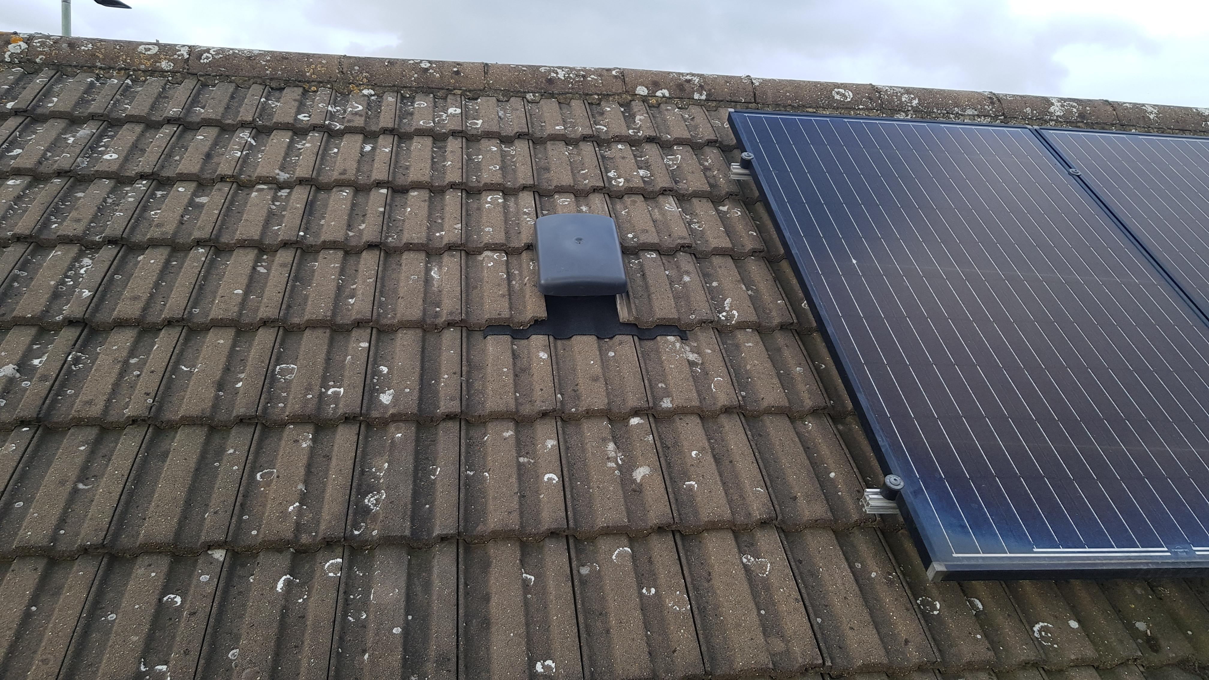

Savage87 Posted January 23, 2021 Share Posted January 23, 2021 this is what you're looking for, ubbink ub16 https://www.ubbink.com/en-gb/product/ventilation-tile-hooded-universal-ub16-grey-black Link to comment Share on other sites More sharing options...
Jason L Posted January 23, 2021 Author Share Posted January 23, 2021 2 hours ago, Savage87 said: this is what you're looking for, ubbink ub16 https://www.ubbink.com/en-gb/product/ventilation-tile-hooded-universal-ub16-grey-black cheers, or something a bit prettier really ? is the ok for the supply air too ? Link to comment Share on other sites More sharing options...
Savage87 Posted January 24, 2021 Share Posted January 24, 2021 yes, I have it for both supply and exhaust, you can also get some that sit flush, but you need to make sure there's enough air coming through, as there are some that are not suitable for mvhrs. If I remember correctly you need at least 10000mm2 clearence in the vent for 125mm ducting. Link to comment Share on other sites More sharing options...

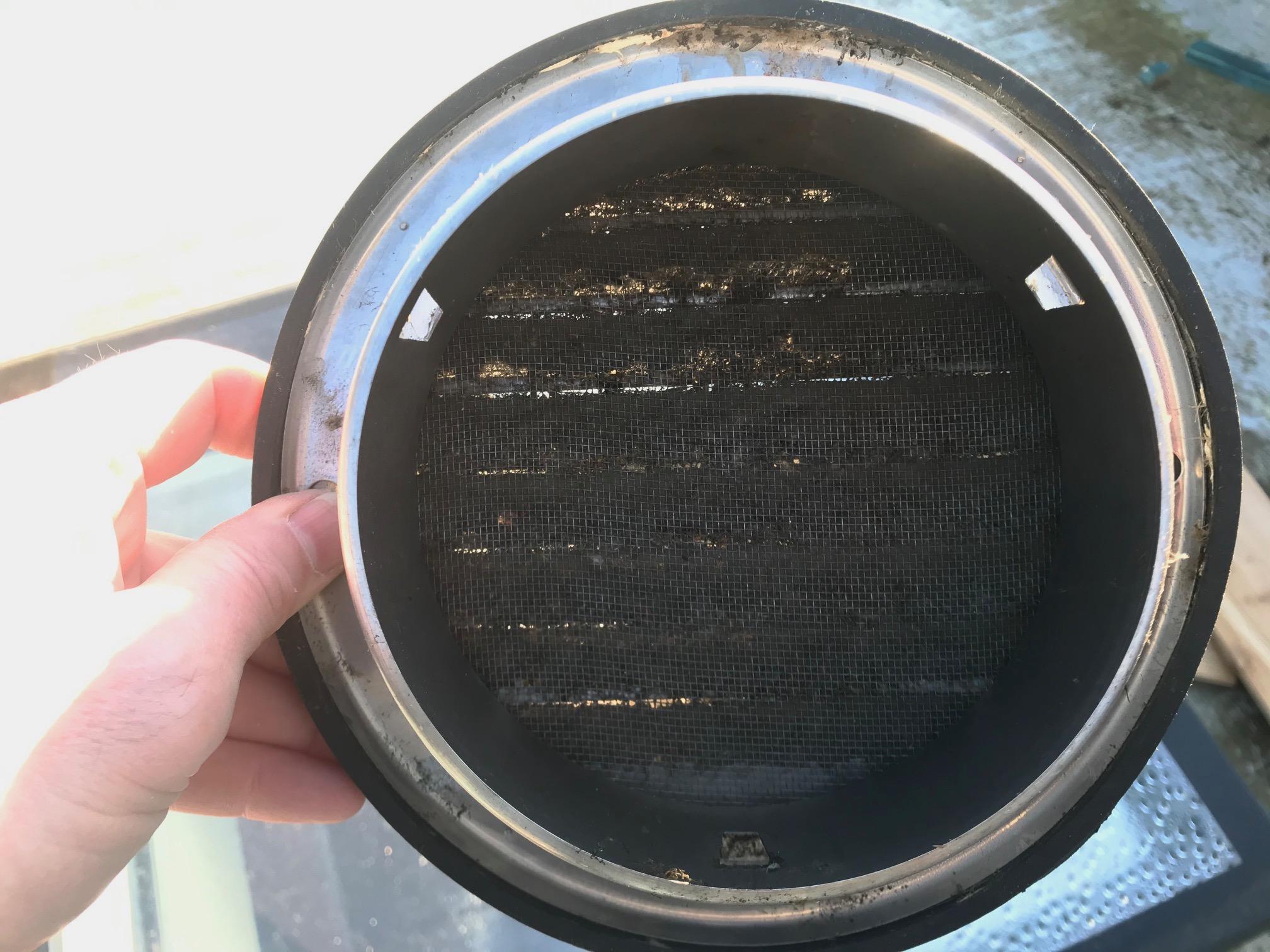

JamesP Posted January 26, 2021 Share Posted January 26, 2021 18 minutes ago, Andrew Sharratt said: I am also considering these Ubbink for my 150mm inlet and exhaust. Since they will be through the roof how do you cope with 1. Access for cleaning the inlet grill? Do you fit some internal filter? 2. Making the ducting slope downwards to allow condensation to run out? Is there another way to stop moisture running back into the MVHR unit? I cant see how either of these 'best practice' design features can be achieved with roof vents. Additionally, does anyone have experience of these Ubbink cowls in very windy locations? Thanks No knowledge of Ubbink but I recently removed the inlet grill to fit cedar cladding and quite surprised at the amount of rubbish in the grill. This was after only 8 months. So access for cleaning quite important. 1 Link to comment Share on other sites More sharing options...

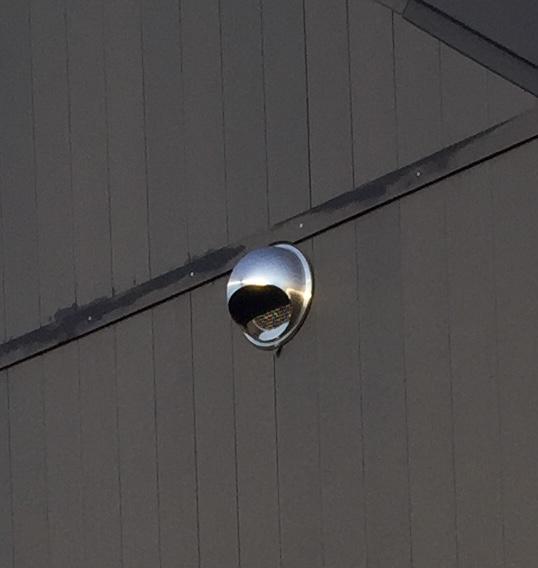

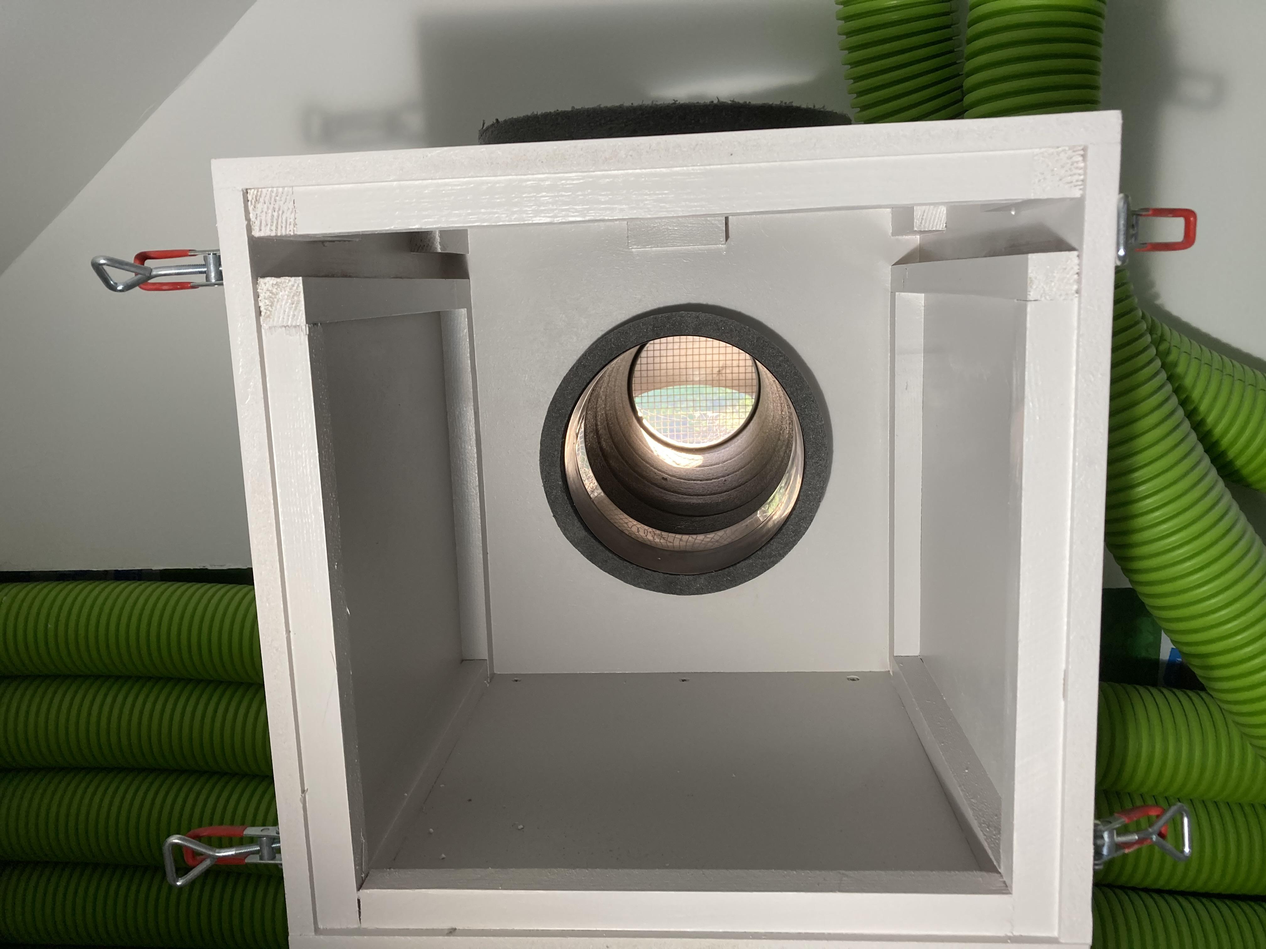

Russdl Posted January 26, 2021 Share Posted January 26, 2021 @Jason L We used this style of cowl vent, clearly no use on a roof but may be there is something similar somewhere that would work on a roof? I think they are similar to @JamesP's but with a much coarser mesh. The coarse mesh will probably let lots of rubbish through, so minimising external cleaning requirements. I made a 'pre filter' just prior to the MVHR to catch that rubbish. The pre filter also allows access to the back of the cowl so I can clean it from inside the house. My pre-filter is probably over large and it turns the airflow through 90° but I reckon something much more compact could be knocked up as an in-line filter. Provided it was big enough to get an air line in you could blow all the crap of any external mesh from within. 1 Link to comment Share on other sites More sharing options...
