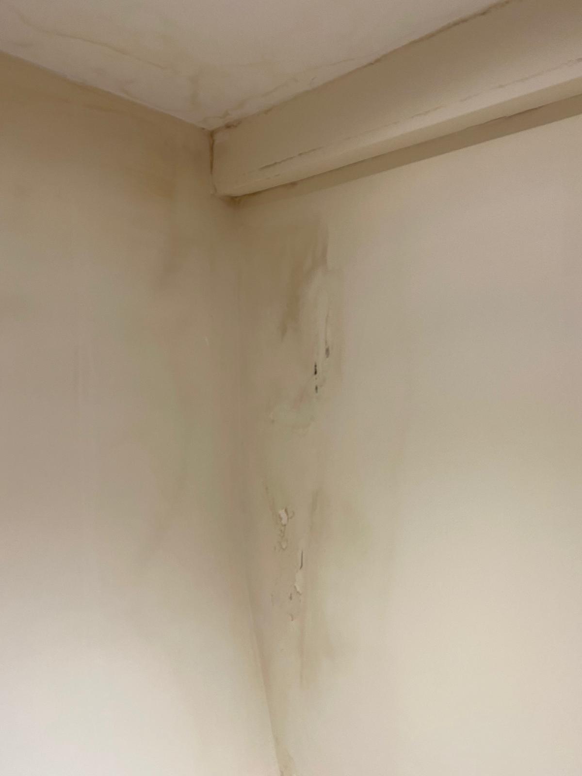

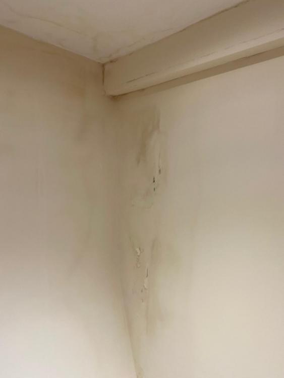

Patrick williamson Posted January 18, 2021 Posted January 18, 2021 Hi I have a leak that is coming into my basement , only happens during heavy rain. Had drains checked by water company and these told are fine . They put dye into drains and nothing showed up.When drains cannot cope water over flows so I am thinking it's getting in via concrete or fissure. Any advise best way to seal from happening . Basement ceiling and walls get damp and discoulrs paint . Area is a small courtyard out back and standing water eventually drains away Any products to seal or specialist companies around to get this sorted, Thanks

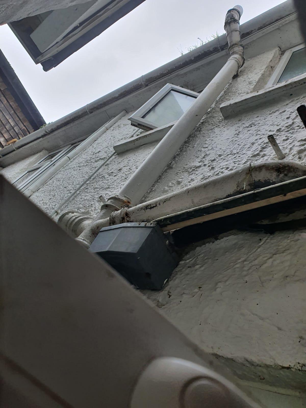

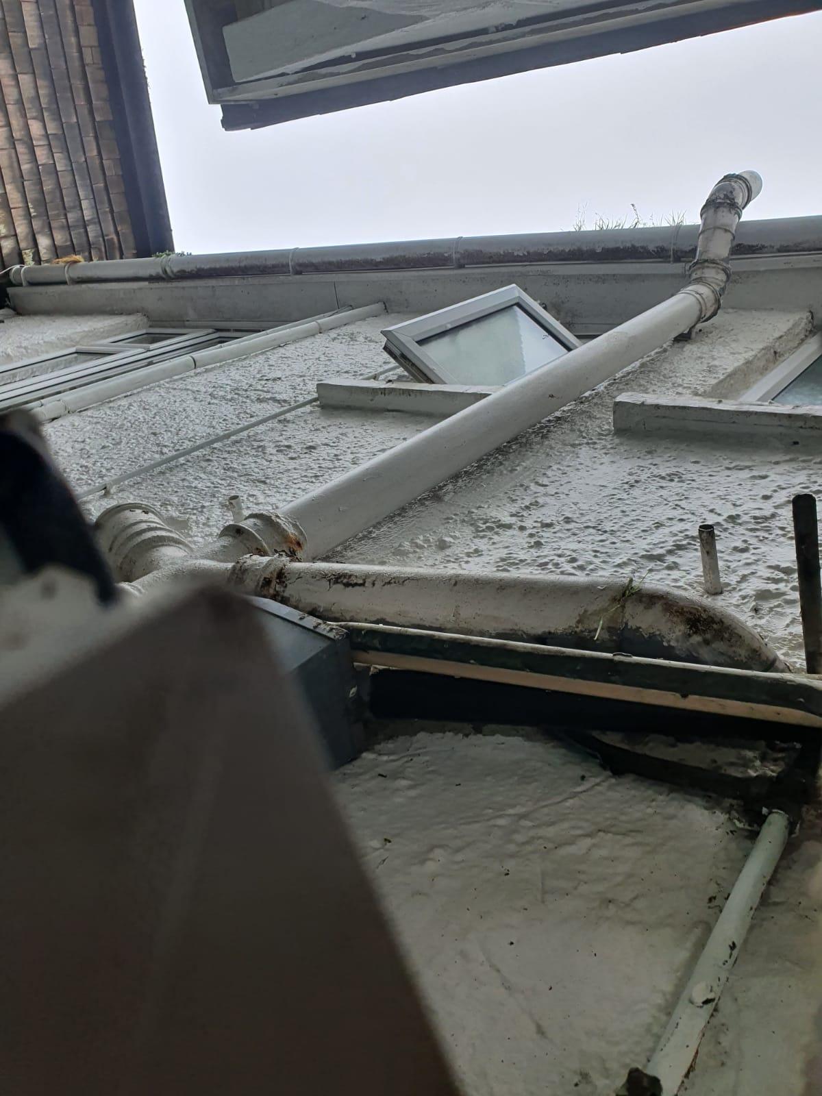

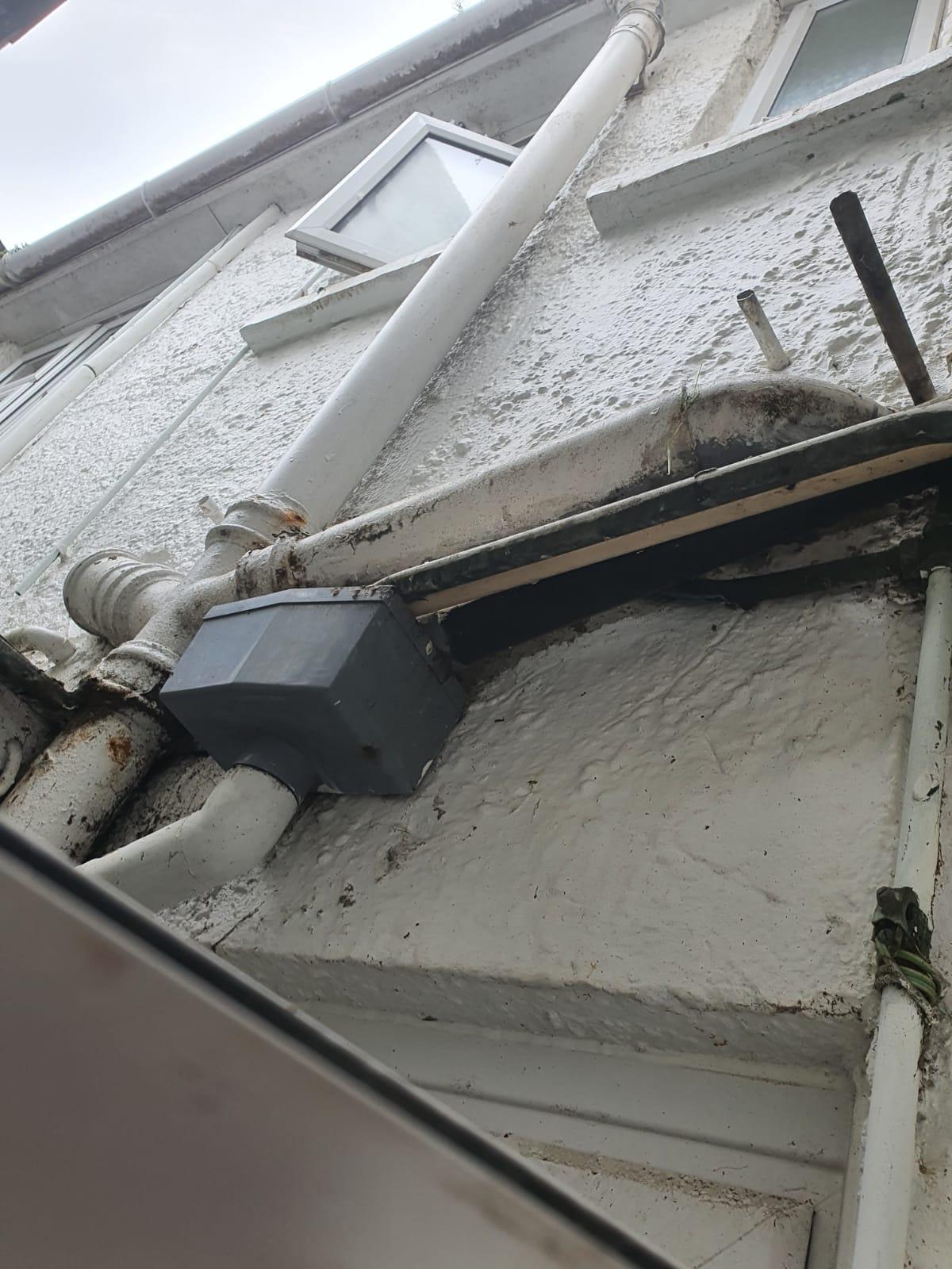

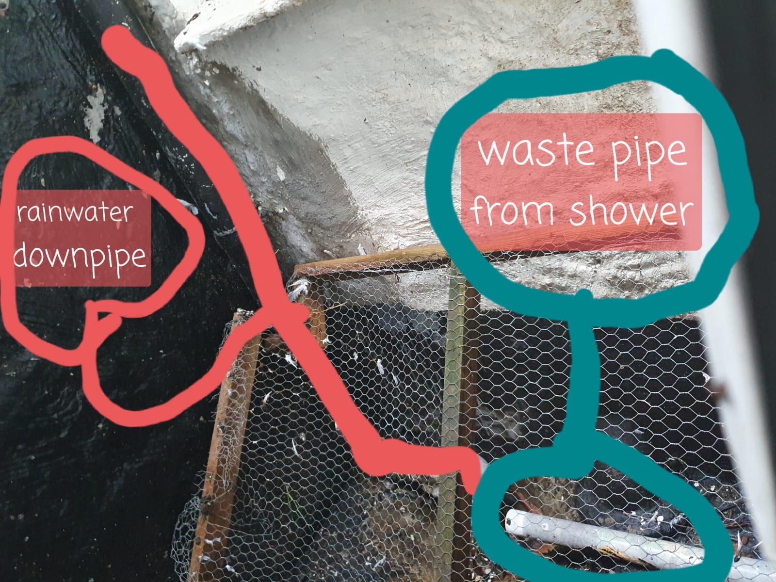

Patrick williamson Posted January 18, 2021 Author Posted January 18, 2021 Hi no this is not possible due to where the pipes are see some photos
Bitpipe Posted January 18, 2021 Posted January 18, 2021 Tell us a bit more about the basement construction, when it was built, what the current waterproofing strategy is etc. Newton have plenty of products to seal basements but you need to understand what the root cause is - agree that effective external drainage is probably the starting point.
Patrick williamson Posted January 18, 2021 Author Posted January 18, 2021 Hi built around 80 years . Shared drains . Seems has been tanked. Drains not up to job so can not get rid of excess water. So any overflow gets in basement
Patrick williamson Posted January 18, 2021 Author Posted January 18, 2021 Drains go under the house so cannot dig up or put frenchvdrains . In.

Patrick williamson Posted January 18, 2021 Author Posted January 18, 2021 Told that can overflow drains in courtyard up to 6 inches before it slowly drains away.bso thin Nking it finds it's way between walls .

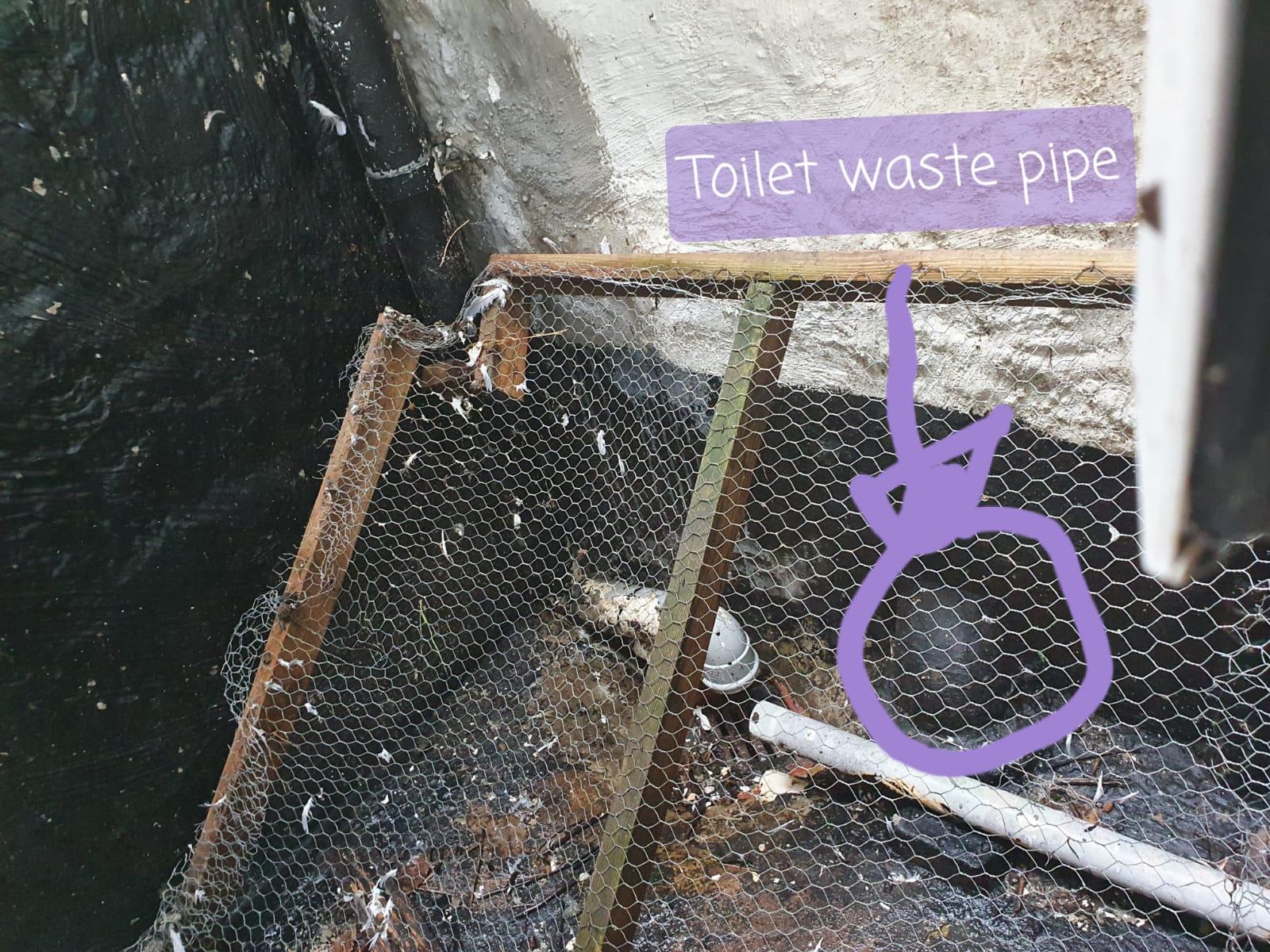

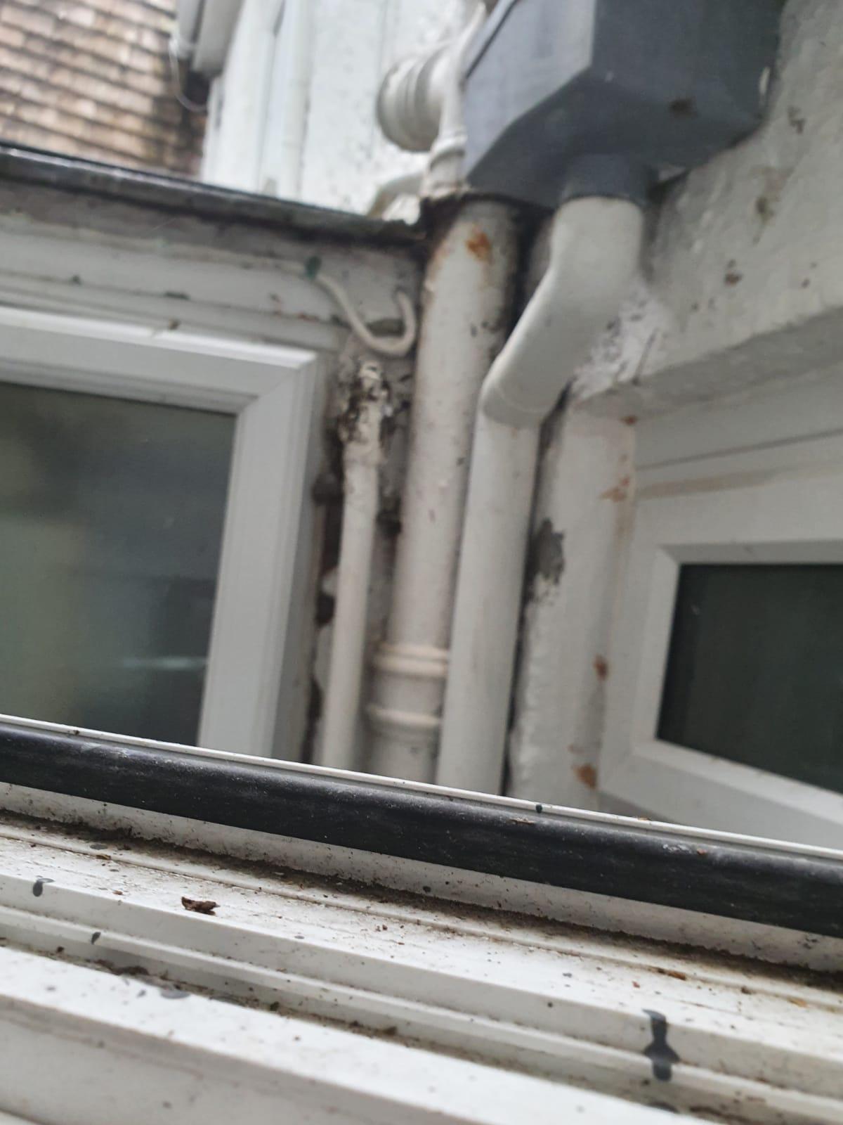

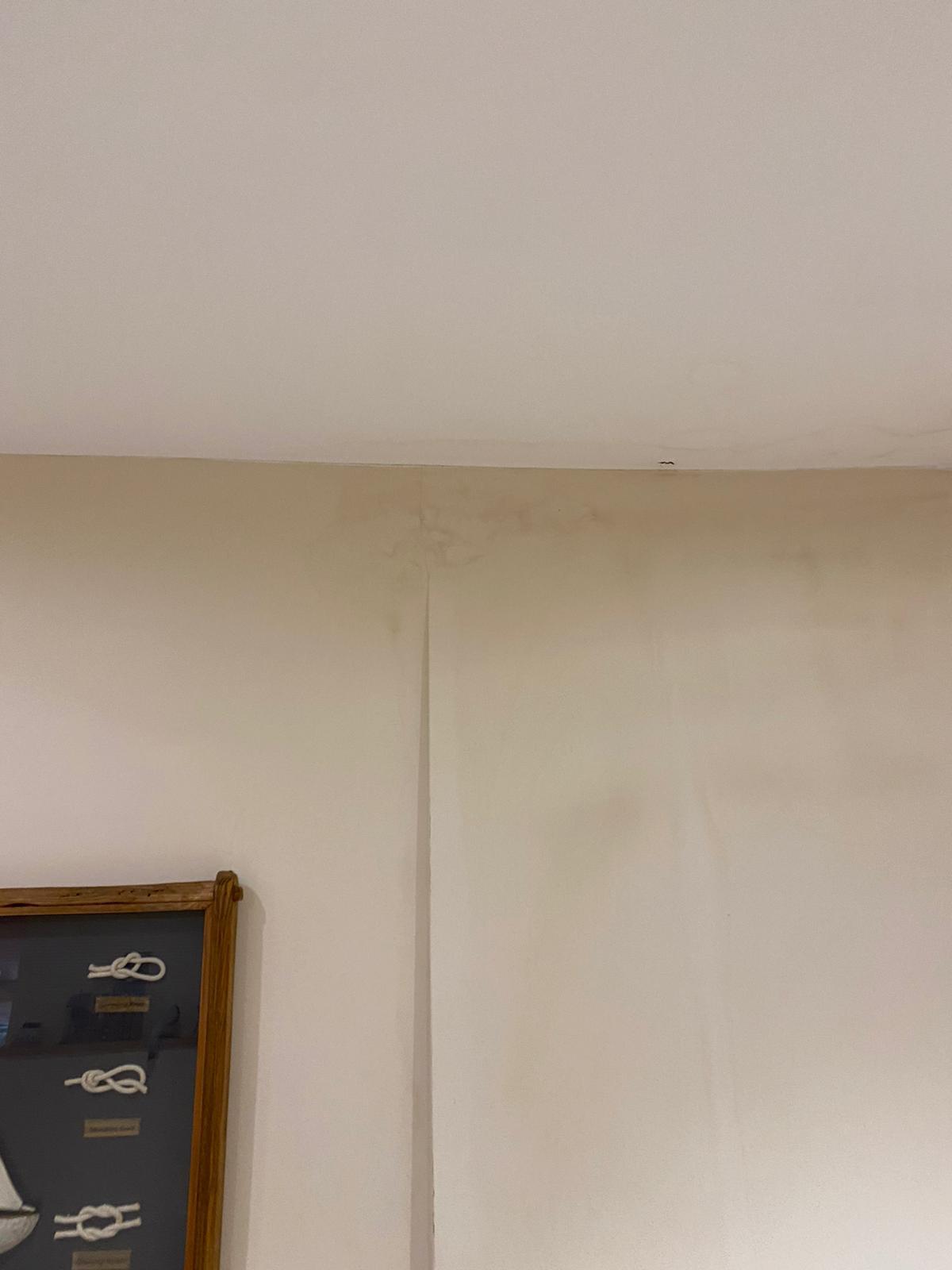

Patrick williamson Posted January 18, 2021 Author Posted January 18, 2021 Hi not really as this problem happened while away so had a friend take photos will add some more but . Not sure if will help
Patrick williamson Posted January 18, 2021 Author Posted January 18, 2021 More photos had gutters cleaned . Told that can overflow drains in courtyard up to 6 inches before it slowly drains away.bso thin Nking it finds it's way between walls .
Onoff Posted January 18, 2021 Posted January 18, 2021 (edited) The 4th picture of the opening post appears to indicate something boxed in. Could that be "pipes" where a joint has failed? Edited January 18, 2021 by Onoff
Patrick williamson Posted January 18, 2021 Author Posted January 18, 2021 17 minutes ago, Onoff said: The 4th picture of the opening post appears to indicate something boxed in. Could that be "pipes" where a joint has failed? Sorry I am a novice . 4th photo joint not sure your meaning
Onoff Posted January 18, 2021 Posted January 18, 2021 8 minutes ago, Patrick williamson said: Sorry I am a novice . 4th photo joint not sure your meaning The boxing in up by the ceiling, is there a pipe/drain behind that?
Mr Punter Posted January 18, 2021 Posted January 18, 2021 OK so forget the type C waterproofing, it is just the drain surcharging. Does this just serve your property or others? Do any neighbours have the same issue? Can you take a bit of the boxing off and see if there is a leaking joint? Can you get a firm to CCTV and report on the condition and direction of the drain?
Patrick williamson Posted January 18, 2021 Author Posted January 18, 2021 27 minutes ago, Mr Punter said: OK so forget the type C waterproofing, it is just the drain surcharging. Does this just serve your property or others? Do any neighbours have the same issue? Can you take a bit of the boxing off and see if there is a leaking joint? Can you get a firm to CCTV and report on the condition and direction of the drain? Hi the boxing I will get my plumber to look at this .this week Neighbours don't have any basements,
