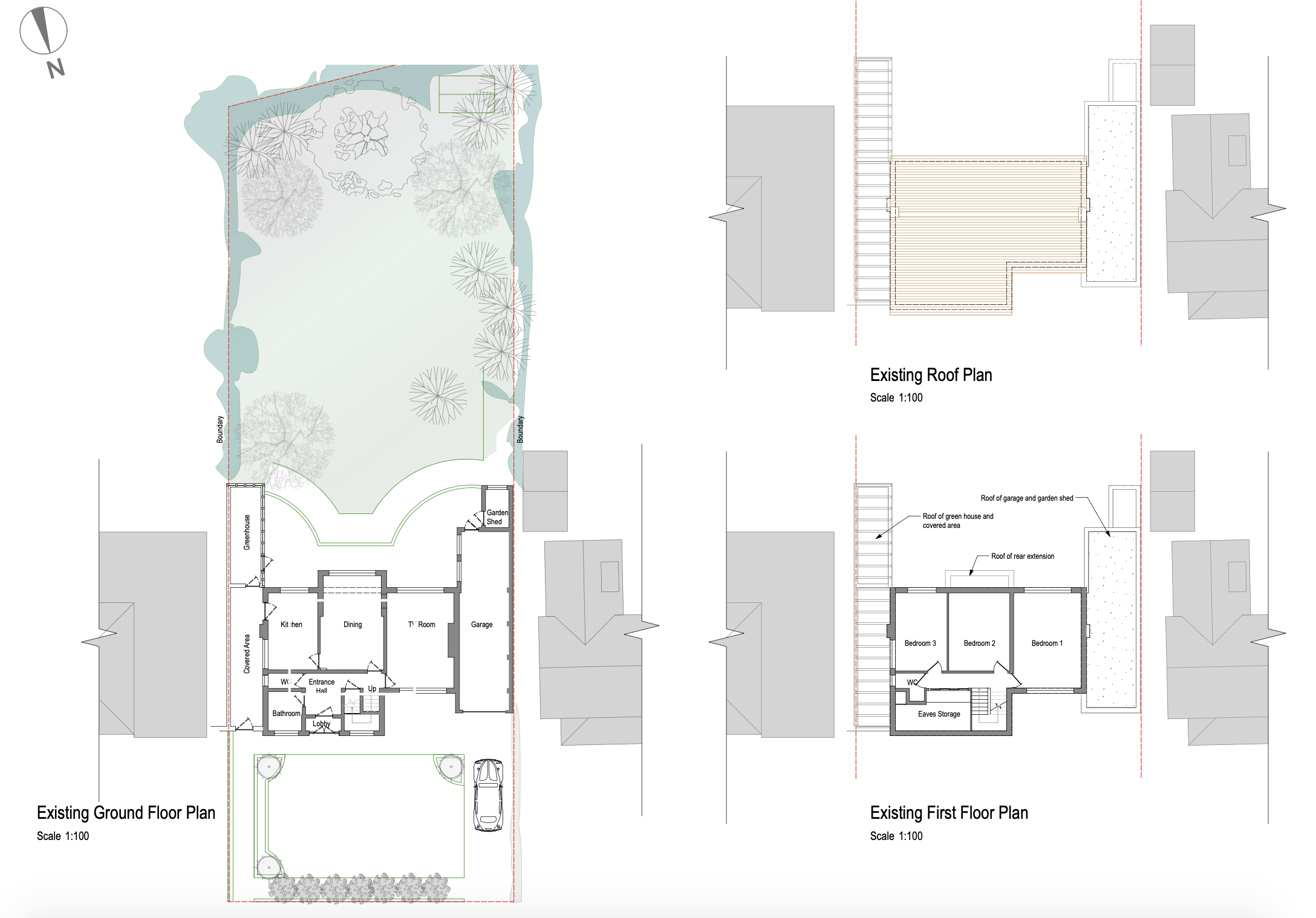

Packman Posted January 18, 2021 Posted January 18, 2021 Hi everyone I'm stuck with my construction method and insulation... Please can you help me with the pros and cons? I'm getting a lot of mixed reports from the things I'm reading and the people I'm speaking to! Background: I have just bought a 1950s house in Hertfordshire, cavity wall construction, completely uninsulated. It's in pretty good condition structurally, but hasn't been touched since it was built. Project: I will be completely renovating and modernising the property, taking it back to brick, moving a lot of internal walls, new plumbing, wiring, windows, doors, floors, ceilings, etc. Oh, and getting rid of the asbestos! I will also be adding a 4x10m double storey extension on the back. The back of the house is South-facing. Externally, I want to finish the house in a combination of brick slips and render. (I don't like the colour of the current brick that is used). I will also be retiling the roof, and adding a couple of gables over the rear extension. I want to take a fabric first approach to the build to make it as energy efficient as possible (within reason and budget constraints). I am not trying to take it to PassiveHaus or EnerPHTT standards at all, but I would like to try and achieve the best I can afford to do that makes sense and isn't over engineering it at large costs for the sake of small incremental gains. I also really want to install MVHR. Where I'm at: My plans are still awaiting approval, but I want to crack on with structural calcs and BC drawings. However, unless I tell them otherwise, the extension will be specified to built in cavity wall construction, and the specifications & details will just be to satisfy normal building regs. My thoughts were that I would full fill the existing cavities in the existing house, then wrap the whole house in EWI. Insulation material for both the cavity fill and EWI is TBC. Questions: What should I build the rear extension in, and how should I insulate? Brick & Block with cavity? I assume this would be easier to tie in with the original house, as it is the same construction method as the original, and would be easier to find tradesman for this as it is the most common. If I do this, I assume I would then continue the same full-fill of the cavity and EWI as per what I plan on the original house? Single Block with EWI? Given that I want to use EWI on the existing house, perhaps it doens't make sense to build the extension in cavity brick and block, and instead I could use a single blockwork and continue the EWI on that? A different monolithic single block construction method? E.g. the JUWO evolved SmartWall? (https://evolvedsupplies.co.uk/juwo-evolved-smartwall). The sales materials sound convincing (obviously!) as it seems it would be cheaper and quicker to build the brick and block, provides a slimmer finished wall, has better thermal properties and means I wouldn't need to use EWI on the extension as well. But don't know if that is just all hot air (pardon the pun) and also don't know if that might give me an issue in the future with lenders and insurers? Timber Frame? I've been told that this could be cheaper and quicker to build, and could be more thermally efficient? But it could be difficult to tie in, and I'm unclear if just insulating the frame is enough or if you would also wrap EWI over the outer leaf before finishing with the brick slips and render? I'm also getting confused re thermal mass, and whether it is good or not to have!! My original thinking was that a solid wall from e.g. bricks, blocks, concrete, etc has a great thermal mass and therefore will store the heat generated inside and outside and release it slowly during the day, keeping it warm in winter and cool in summer, and creating a cosier environment etc. i.e. construction using materials with a higher thermal mass is a good thing. However, when researching timber frame construction, I'm reading that their lower thermal mass is a good thing, and is more likely to create a better living environment than with a solid-wall construction method! Argh!! Regarding insulation, I'm also getting mixed reports re products, so any advice there is appreciated! Looking forward to hearing your views! Thanks in advance

Packman Posted January 18, 2021 Author Posted January 18, 2021 2 hours ago, Iceverge said: Good luck with the project anyway. Do you have any plans to show us? Thanks!

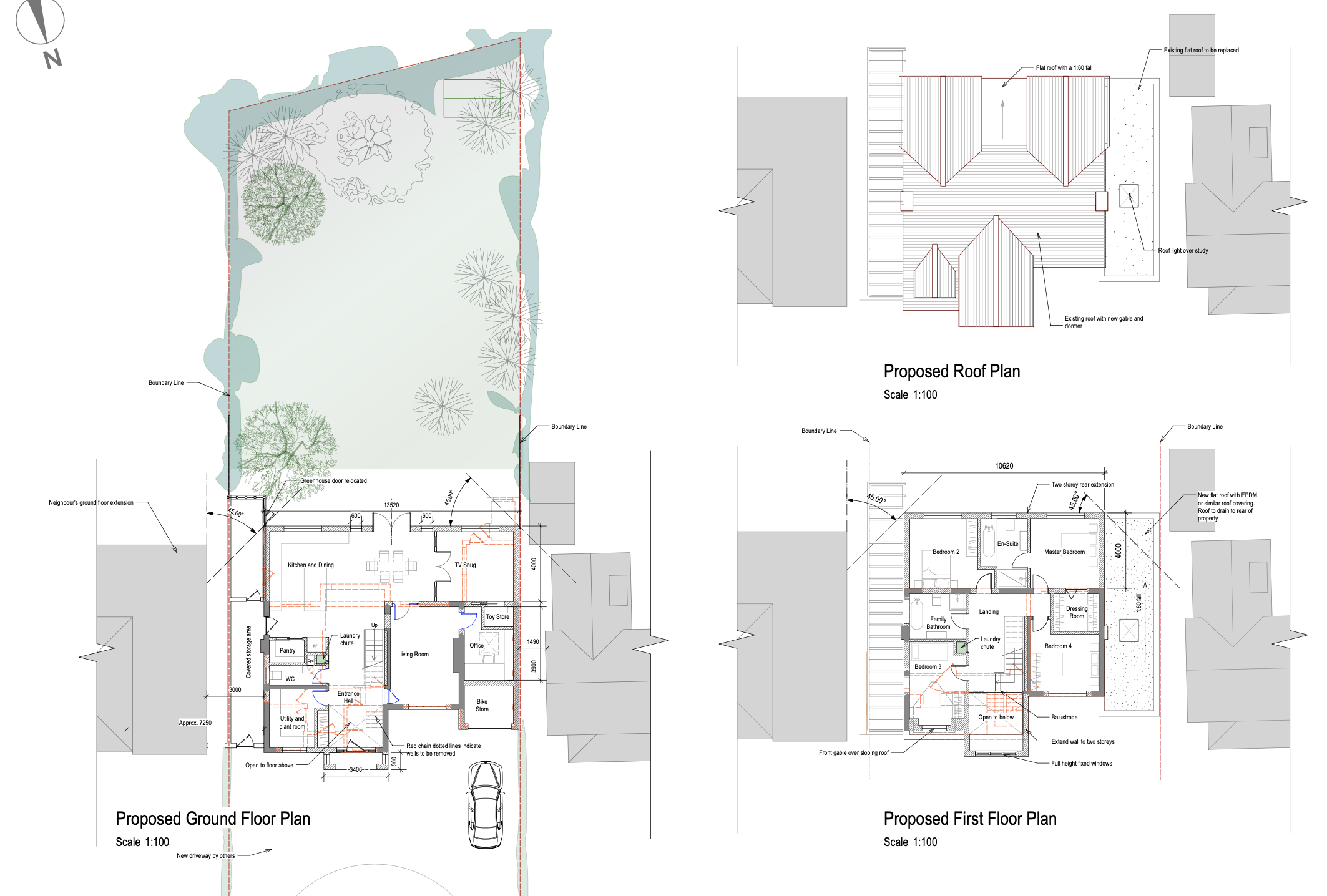

Mr Punter Posted January 18, 2021 Posted January 18, 2021 The design looks good but I think the budget is way out. Did you get a proper quotation from a main contractor for £250k for the extension and renovation? If so, let them chose how they build it, just tell them the required spec (u values, air tightness etc) and let them work out how they will best achieve it. For what they are doing it seems remarkably cheap. I have looked at this and I think it will be cheaper and simpler to demolish and start again as there are almost no external walls that have been retained and any that are will require considerable works. Also need new ground and first floors and new roof structure.

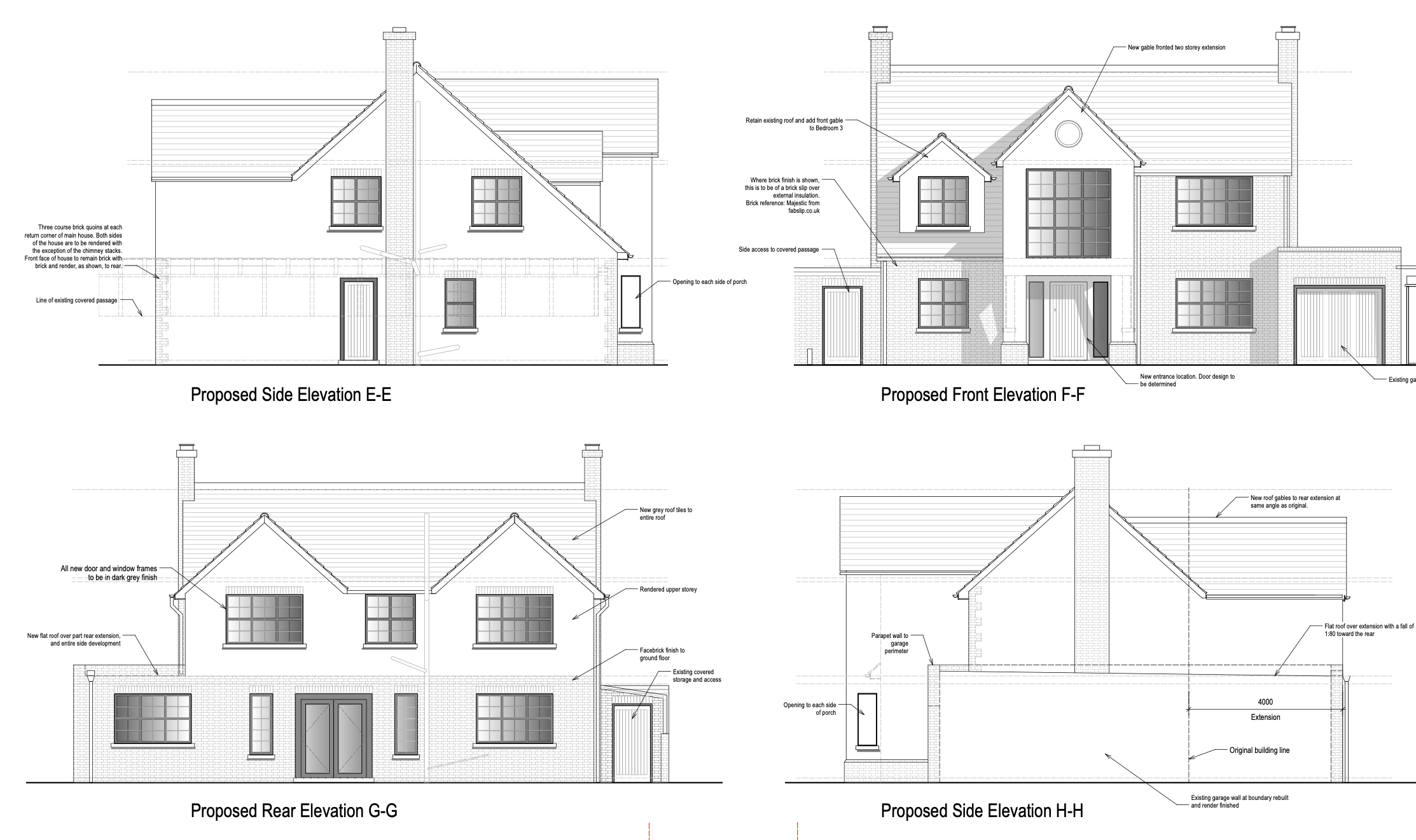

Dave Jones Posted January 18, 2021 Posted January 18, 2021 your SE elevation looks close to the boundary, you can only have 1m2 of windows in that entire elevation if you are 1m from the boundary. Fire regs.
Packman Posted January 18, 2021 Author Posted January 18, 2021 23 minutes ago, Dave Jones said: your SE elevation looks close to the boundary, you can only have 1m2 of windows in that entire elevation if you are 1m from the boundary. Fire regs. Thanks for the headsup... but we're over 1.8m from the boundary on the left and almost 3m from the boundary on the right.
Packman Posted January 18, 2021 Author Posted January 18, 2021 2 hours ago, Mr Punter said: Did you get a proper quotation from a main contractor for £250k for the extension and renovation? If so, let them chose how they build it, just tell them the required spec (u values, air tightness etc) and let them work out how they will best achieve it. For what they are doing it seems remarkably cheap. Yes I did. Thank you, may be best as you say to set the parameters and let them build how they think is best. 2 hours ago, Mr Punter said: I have looked at this and I think it will be cheaper and simpler to demolish and start again as there are almost no external walls that have been retained and any that are will require considerable works. Also need new ground and first floors and new roof structure. Would love to build from scratch as am concerned about the uncertainties, but think the cost of building from scratch will be more. The entire N, E and W external walls are staying (although the W wall will become an internal wall). It's only the S external wall on the back of the house that is going. We'll also rebuild the boundary wall on the W as that is currently a garage and is just a single skin of bricks on piddly foundations. The roof is the same, we're just cutting in a gable and dormer on the front, and 2 gables on the back with a little flat roof between them to cover the extension. But the existing roof is largely still retained. Well at least that is the hope / intention!
SteamyTea Posted January 19, 2021 Posted January 19, 2021 Did you say the rear of the house was south facing? If so, your proposed design effectively stops the use of PV. If you want to fit UFH, how much can you did down to fit the insulation?

Packman Posted January 21, 2021 Author Posted January 21, 2021 On 19/01/2021 at 07:38, SteamyTea said: Did you say the rear of the house was south facing? If so, your proposed design effectively stops the use of PV. Yes, it is S-facing. Is that due to the gable roof design on the back? On 19/01/2021 at 07:38, SteamyTea said: If you want to fit UFH, how much can you did down to fit the insulation? Unsure as don't know how deep the existing slab is. Some contractors have suggested building up, as we have enough head height to be able to loose some. It's 50-50 - some have said to def dig down, others have said it's better to insulate and build on top of the existing slab. Any views?
