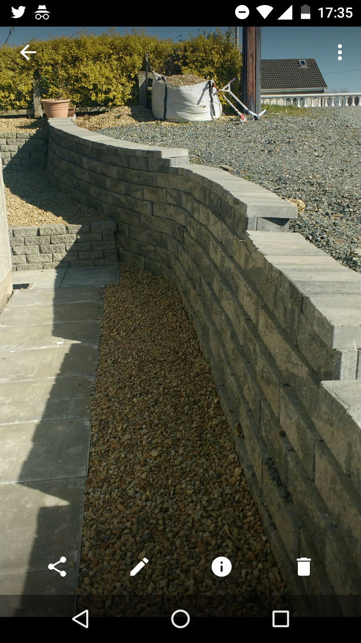

Declan52 Posted February 2, 2017 Share Posted February 2, 2017 I used a dry build type block to construct my retaining wall. The blocks are 450*300*150. You don't need a concrete founds just a good sound base of compacted hardcore. The way they lock together they lean back at approx 80 degrees. That complete wall is over 20m long and at its highest 1.4m and I done it all in a day. Cost wise I think it was approx £600 just got the main retaining wall. The smaller wall facing you on the picture used a smaller block as they aren't suitable for the height you need to go. For a block wall 1m high I would start with a course 450mm wide then 2 courses at 330mm then a 215mm and then your coping. The most important aspect of any retaining wall is how you get rid of the water that will pool behind it. You need a French drain type system with a fine gravel behind the wall. 2 Link to comment Share on other sites More sharing options...

Guest Alphonsox Posted February 2, 2017 Share Posted February 2, 2017 33 minutes ago, Declan52 said: I used a dry build type block to construct my retaining wall. The blocks are 450*300*150. You don't need a concrete founds just a good sound base of compacted hardcore. The way they lock together they lean back at approx 80 degrees. That complete wall is over 20m long and at its highest 1.4m and I done it all in a day. Cost wise I think it was approx £600 just got the main retaining wall. The smaller wall facing you on the picture used a smaller block as they aren't suitable for the height you need to go. For a block wall 1m high I would start with a course 450mm wide then 2 courses at 330mm then a 215mm and then your coping. The most important aspect of any retaining wall is how you get rid of the water that will pool behind it. You need a French drain type system with a fine gravel behind the wall. @Declan52That looks extremely good, we need something very similar - Who makes the blocks ? Where did you get them from ? Thanks Link to comment Share on other sites More sharing options...
Declan52 Posted February 2, 2017 Share Posted February 2, 2017 1 minute ago, Alphonsox said: @Declan52That looks extremely good, we need something very similar - Who makes the blocks ? Where did you get them from ? Thanks Tobermore have their version but I got mine from Acheson and Glover as I had an account there from buying blocks from them. They have a display at their base in Dungannon. https://www.ag.uk.com/outside-rooms/products/garden-walling-products Link to comment Share on other sites More sharing options...
Roger440 Posted February 3, 2017 Share Posted February 3, 2017 I too used the Acheson and Glover stuff to do a retaining wall. There blurb says no cals needed upto either 1 or 1.2 depending on the system if i recall correctly. Dead easy to use. I used it because i was very near trees, so long term likely to be some movement which these should cope with and a brick wall wouldn't. I would never build a brick retaining or garden wall again. 1 Link to comment Share on other sites More sharing options...
